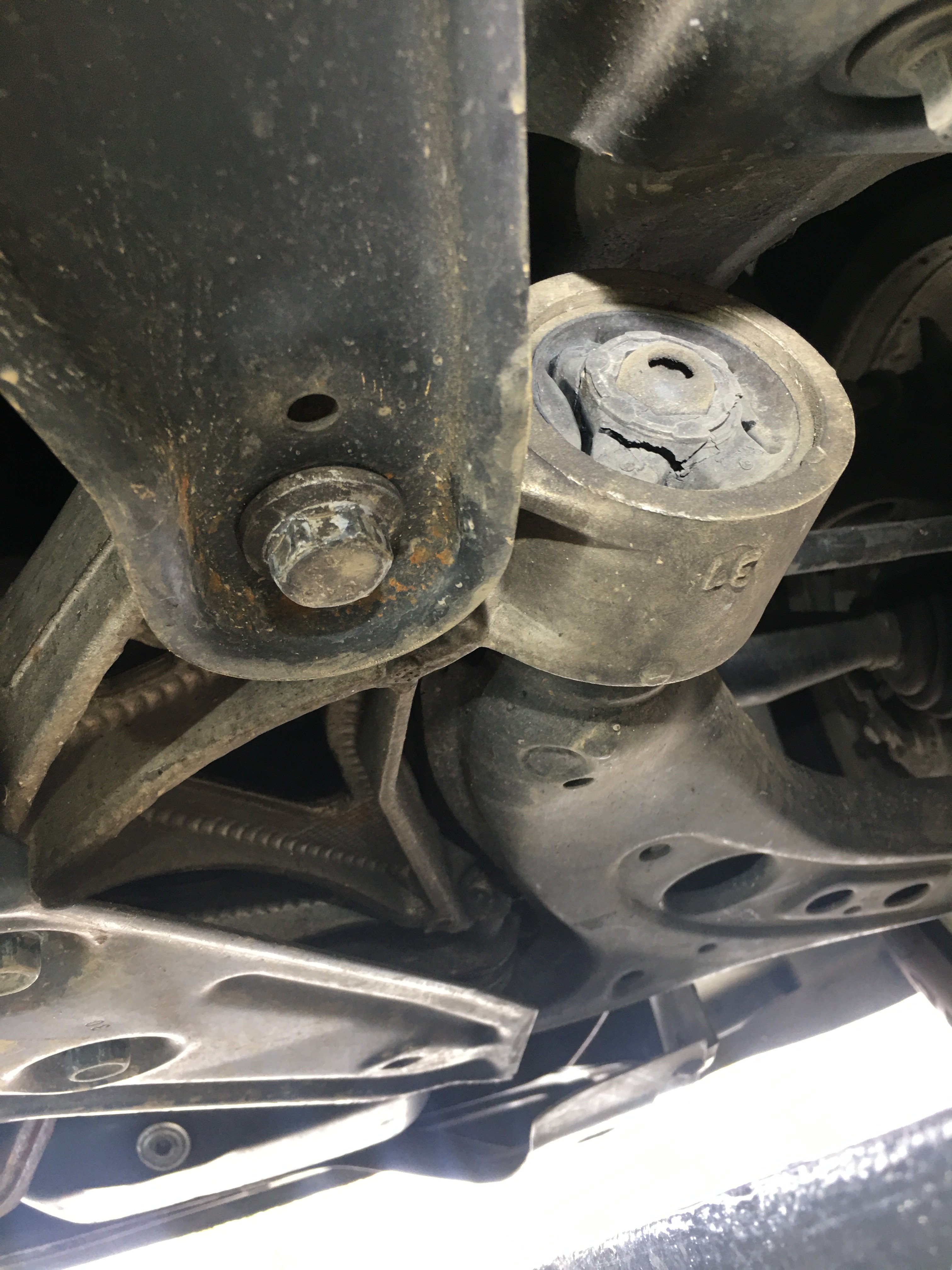

Hi
can anyone tell me the description for this part with rubber bush on my 2006 Roomster please? Its on the right front sideBAC6684D-BDE1-43E6-B95B-E7B6BC4831CE.thumb.jpeg.9497ce6e78f342226a7c677831b36318.jpeg
I would say it is a silent block of the link arm
  • Sponsor
Usually called console bush. 1K0407183E
Can be a pain to remove and replace, especially if the long screw that holds the front of the wishbone is seized in the alloy console.
