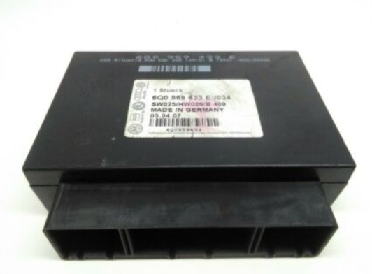

What is the central convenience control unit?
  • Sponsor
It's the unit that controls the central locking and alarm (where fitted) functions. Mounted in a rather inaccessible position up above the clutch pedal on RHD cars.
Generally rather reliable, and tends not to get any attention unless someone wants to replace it to upgrade from key-in-door to radio remote central locking, which requires a different part number.
Yours was built with radio remote C/L, so unlikely to have ever been touched.
Looks  like this:
Edited by Breezy_Pete

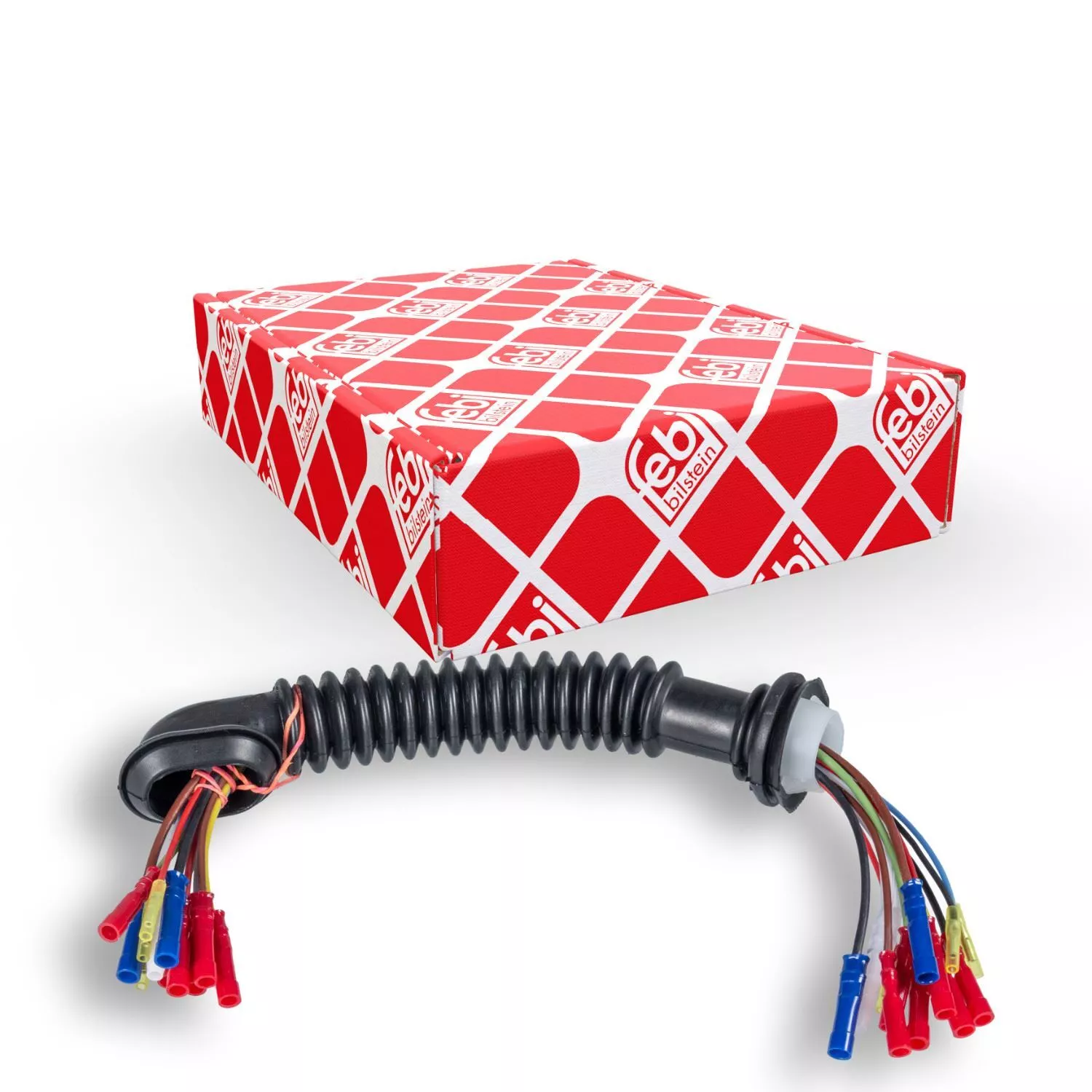

Regarding the boot, both the switch and the solenoid is good. Boot is opening intermittently.
My neighbour said his son had an issue with the wiring harness between the boot and the body of the car. My friend said the same was wrong with his fabia.
I've seen online they sell a Febi Bilstein Wiring Harness Repair Kit (107095). Is it worth replacing or trying to solder if the wires are broken?

Loom repair kits are typically for the single-connector later cars, rather than mk1 Fabia?
Many thanks for that info re beige cog! I've swapped the drivers door actuator, just need to reassemble with plumbers gold. I don't have a rivnut tool or a rivet tool so I'm thinking of using self tappers adjacent to the holes for the original rivets. Anything wrong with using self tappers barring being a bit of a bodge?
The boot harness repair is listed for a mk1 and looks to fit as below. So far though it does seem to be working but its so intermittent, it would not surprise me if not working tomorrow.

That repair loom doesn't resemble what would work on a mk1 or mk2 Fabia, unless maybe on a rear door?
I've misunderstood,  haven't I. You're meaning for the tailgate?
