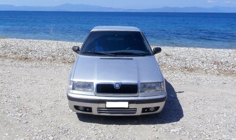

Felicia with extra set of fog lights
I bought my Felicia with factory set of fog lights, i changed after a while the yellowish bulb with an after market 6100K (if i remember correct) and kept this combination for many years.

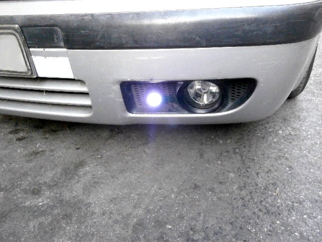

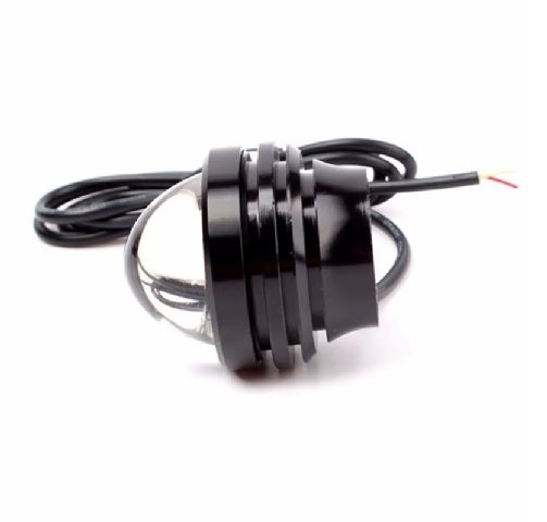

I bought and installed this pair, 15W and 6500 K.
Was not something ''great'' but was something and add some light on the road.

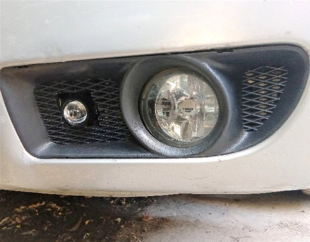

I kept them for some years and then i decise to add a pair of fog lights more powerful so i had to do a modification in the fog light bumper grille.
Stay tuned...

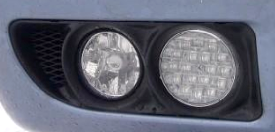

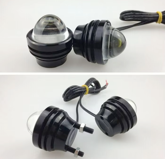

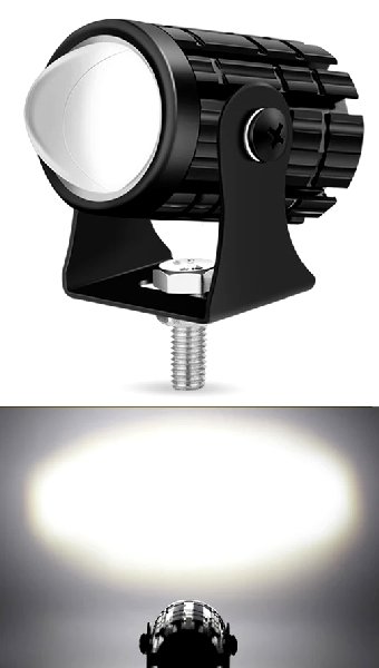

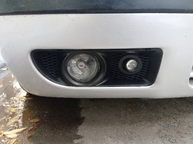

After few years i bought another pair, 12W with 6000K White light which had a bit stronger beam.
I didn't want something very strong, they had a low beam in 3000K yellow colour but i was not interested so much.

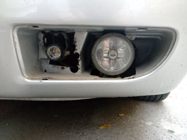

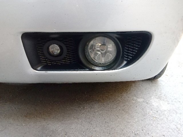

The fitting was not a big issue, my electrician did the whole job with the On-Off switch inside the cabin (actually is on the ashtray's panel) and i cut the bumper grille but the whole ''picture'' was not good looking, i had to do something more beautiful to look sort of ''factory made''.

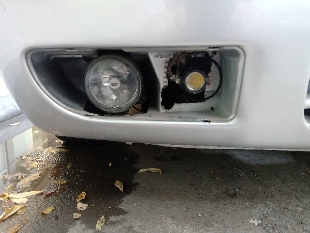

For sure i couldn't do something like this
but i thought i had to try to make something better than this
which was something temporary and in a hurry.

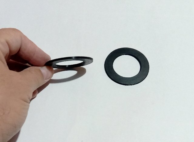

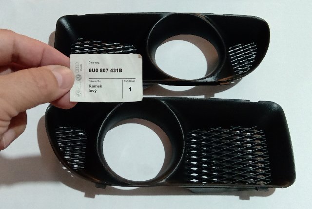

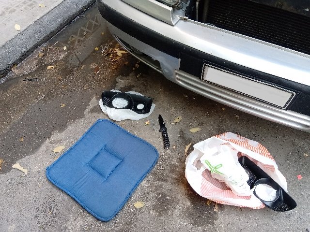

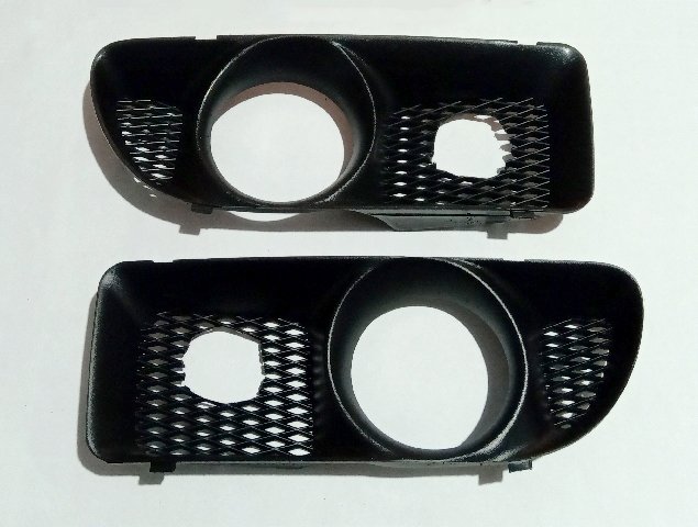

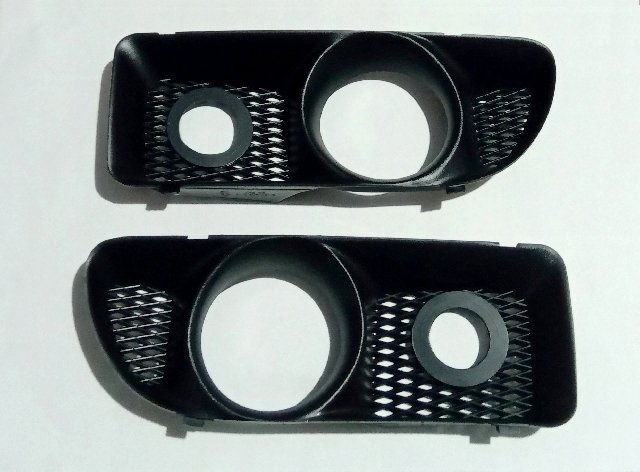

I bought a pair of new bumper grilles

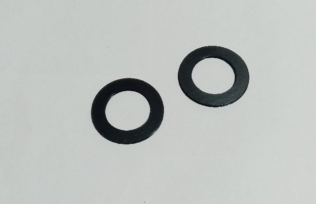

and gave an order for 3D printing a pair of rings from ABS plastic.
and i ready to make a round cut in the mesh and glue them on it.
The grilles are removed, take a look how those projectors are mounted on the bumper, can adjusted a bit up-down or left-right.
After years of use some rust signs are visible on the bracket but this is not an issue.
Cutting work
glueing the ''decoration'' rings
and fitting while working in the road
and as always not an easy task.

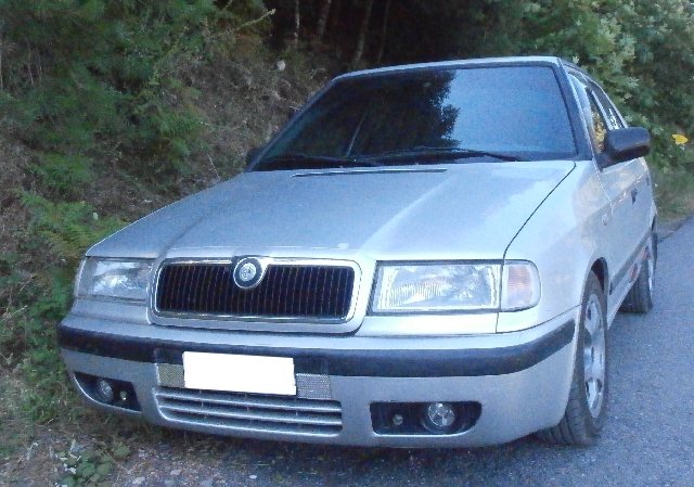

Here are them on the car
a left-right and up-down adjustment needed, i will post photos while they are ''On'' to see how they look like ''in action''.

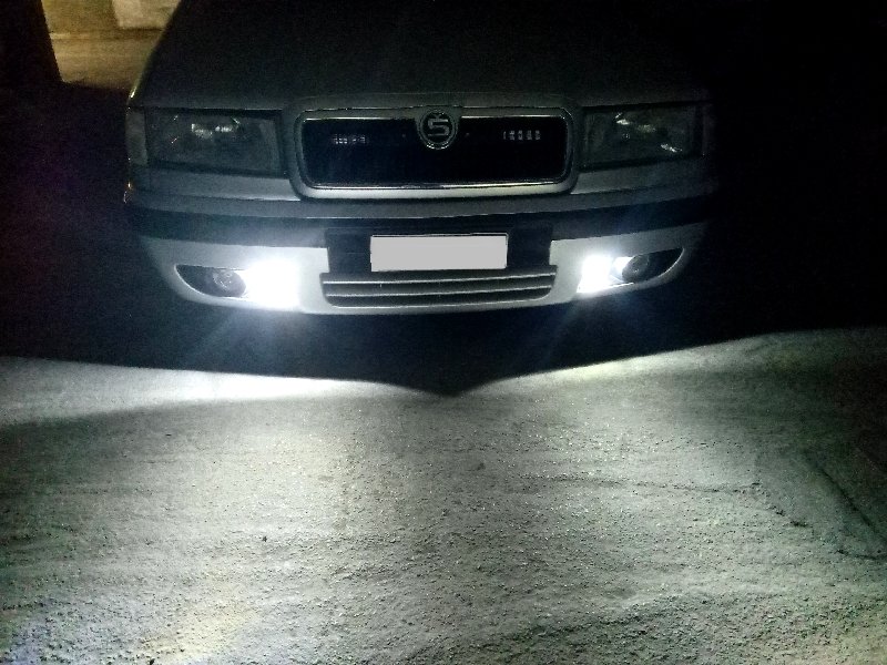

Here is their ''performance'' in a parking lot, i will try in the future to find a dark area outside to take another photo.
The smartphone is not properly aligned and the angle is not perfect but you can take an idea.

I manage to take a photo in a parking lot, it's almost dark and this helped to see the beam of those Auxiliary lights better althought the angle of the camera is not 100% proper.
Some adjustments needed on the right one and as about the ''yellowish'' on the left it can be fixed but i don't want to remove the lens because i have added a special silicone for watertightness.
