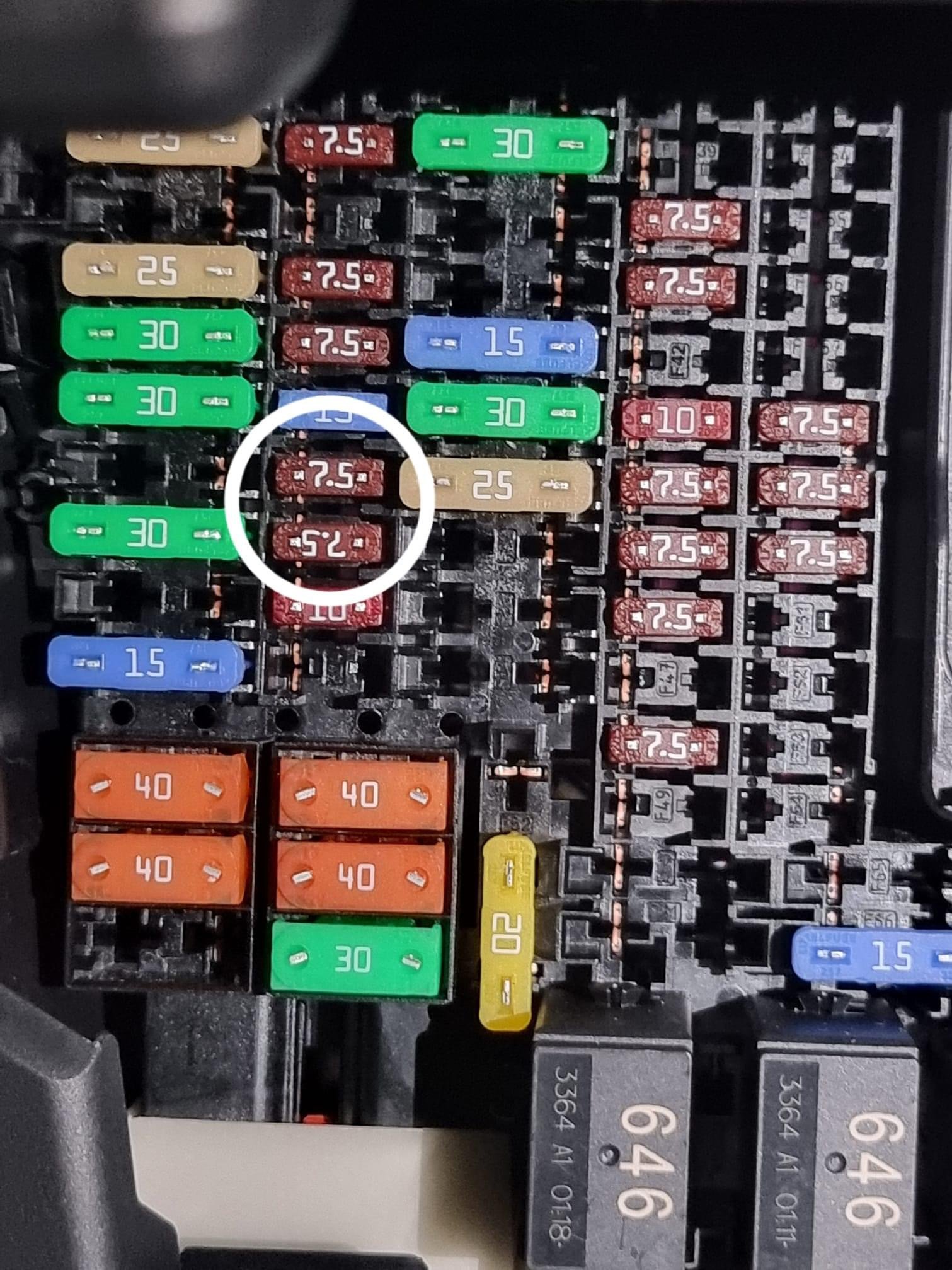

Can you help me with this? I don't want to take the car in for just this AGAIN. Which fuses do I need to unplug for 30 minutes to reset these faults?
