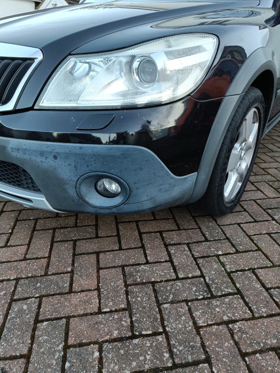

Restoring grey trim on a scout
Has anyone ever managed to do something with the grey trim on a scout? Mine looks pretty yucky but I'm loathed to go at it with the polish just in case!

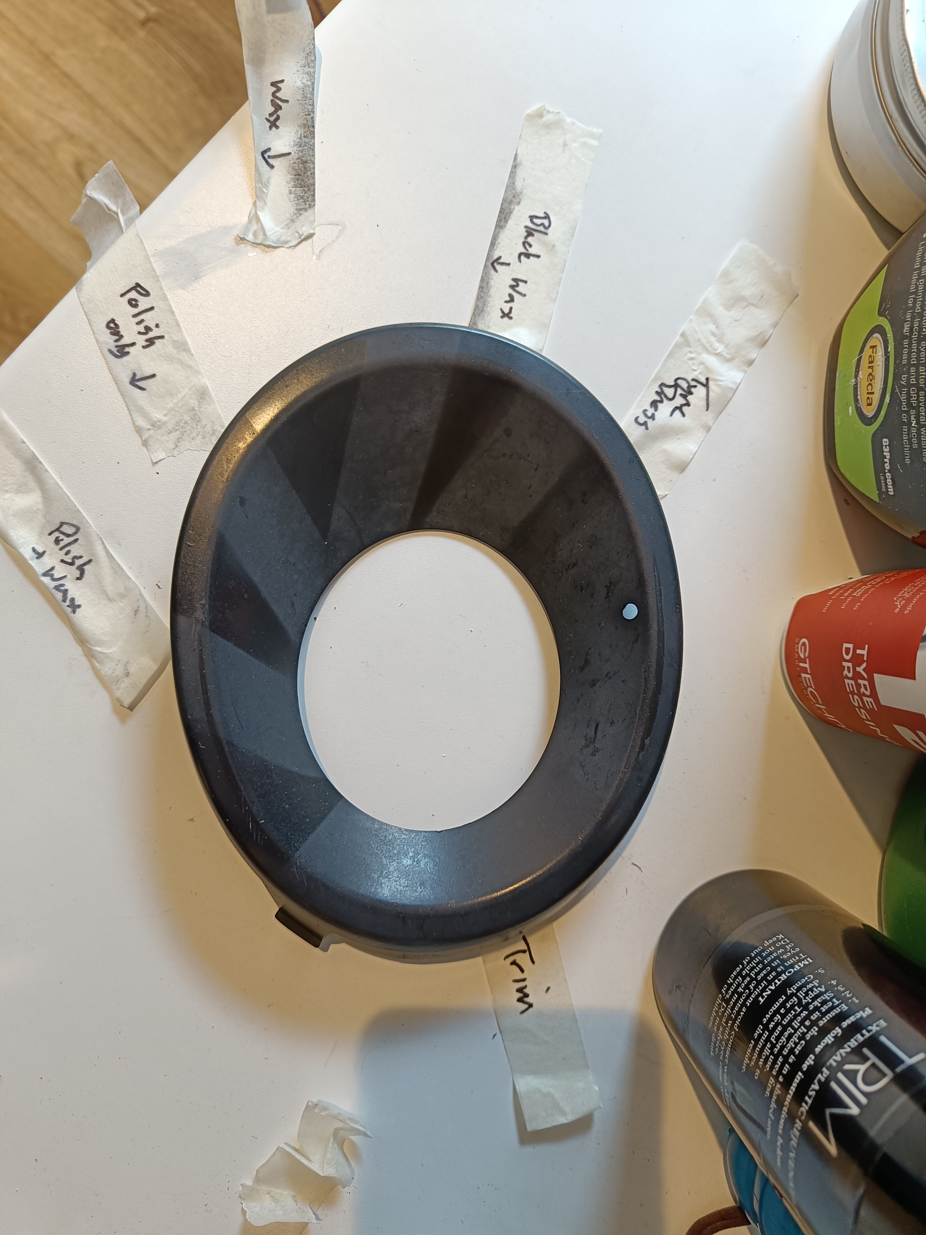

Just as a little follow up on this I decided to experiment on one of my foglight surrounds.
I gave it a good clean and then tried heat. For the record heat did nothing at all. I've used heat successfully on plain plastic trim on other cars but here it was ineffective.
So I then tried in patches
Tyre gel
Plastic trim reviver
Black coloured wax (turtle wax)
Normal wax
Polish
Polish and wax
They all made it look better to varying degrees, so I then washed the trim again.
The trim restorer washed off immediately, no obvious signs it was even there!
The tyre gel was still doing something but not much and I suspected it would be gone after another wash or 2.
The polish and normal wax had done well but it looked like the polish had taken off too much colour.
The black wax looked good but you could see it hadn't quite covered so many imperfections as the polish and wax.
So I tried combining a light polish and the black wax which seems to have come out really well!!

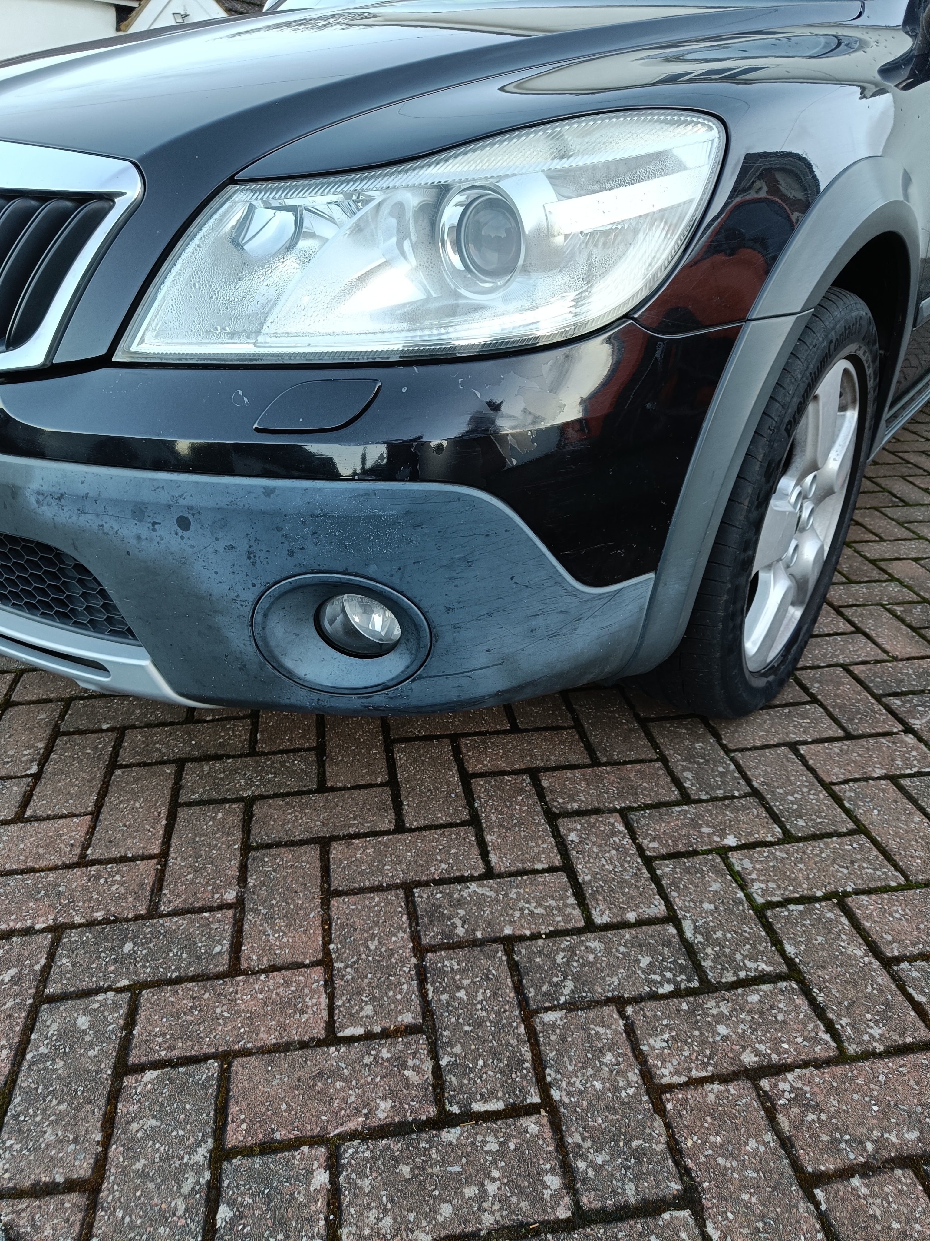

As you've discovered it's a matt grey paint finish with the paint code L7DL
The front bumper is white plastic and the side trims are black plastic, both painted in the above matt grey.
Thanks. That's what I believed to be true but the amount of people who swear blind that they need heating and plastic trim restorer on them and they have done it before is astonishing. I had to give it a try!
I already have a tin of of the correct paint in the garage!

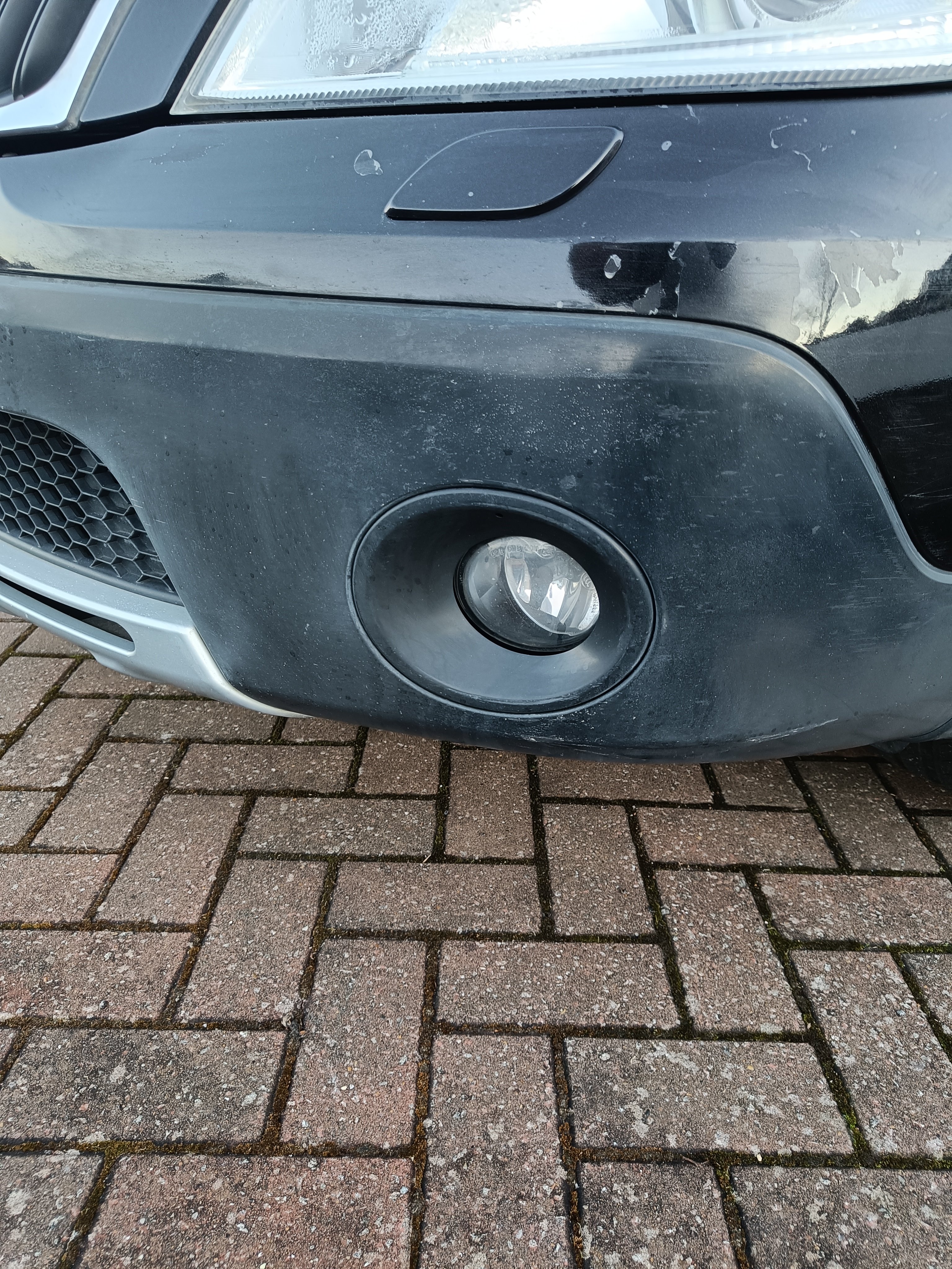

I don't believe that to be true. If it was white plastic then some of those scratches are deep enough to reveal the base material.
Find a deep one and make it a little deeper with a photo and show us the results.
Some of those deeper scratches have been touched up, they were white before. If you zoom in above the foglight you can see if white in the stone chips, looks like it's full of wax but that is based material, or at least white primer.
Fair enough, I'm too old to argue on the internet.
 That's where mine showed white also, around the edges of the fog light opening and lower edges below the numberplate.
I stand corrected.  Why not make it out of the black/grey plastic same as the side trims? If it's paint then in that state only a respray can help. Or a rotorary mop on a drill with lots of t-cut and polish?

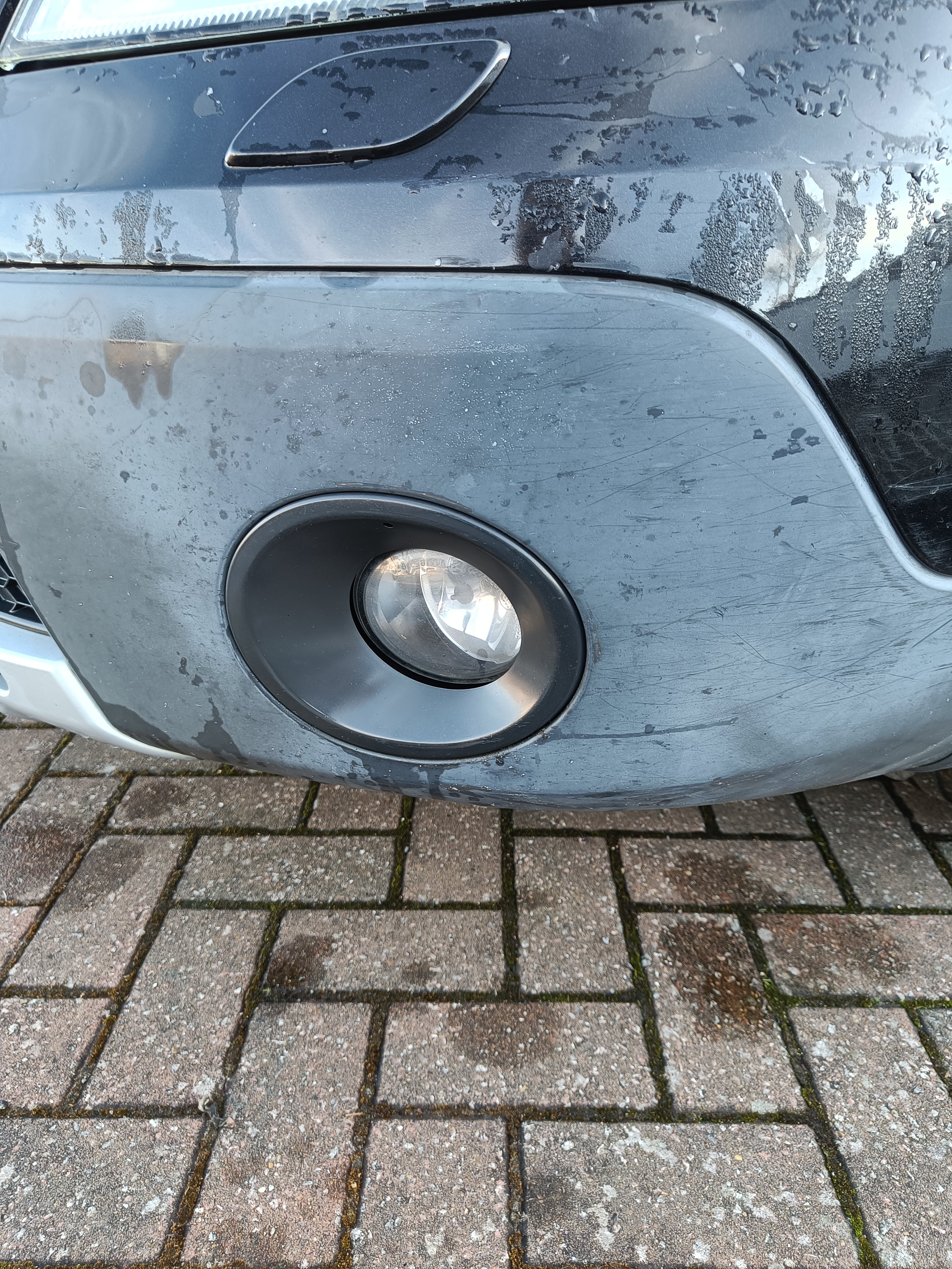

I've had a go at the polish route but it still needs more work. Looks a fair chunk better though....IMG20241129154432.thumb.jpg.27b67f151c93fb939bdddf8a89eaae40.jpg
