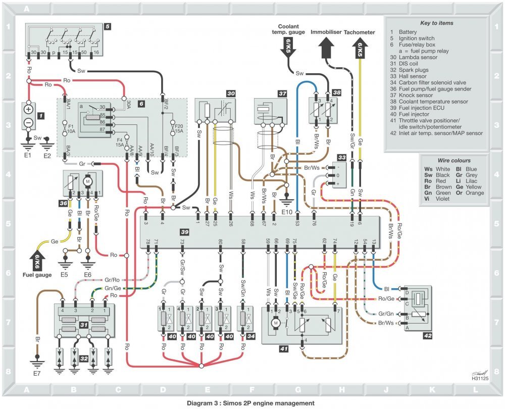

Very simple one power one ground one signal
12 hours ago, memoli said:
Skoda felicia MPI 1.3 crank sensor wiring diagram and cable colors needed
This helps?
1336286394_Diagram3Simos2Penginemanagement.thumb.jpg.e232d282ff6d6dc647a4426b1cc886df.jpg

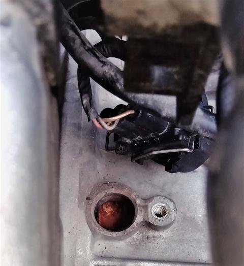

Hello, thank you very much for your interest, but I need a clear connection photo taken from inside the vehicle.
