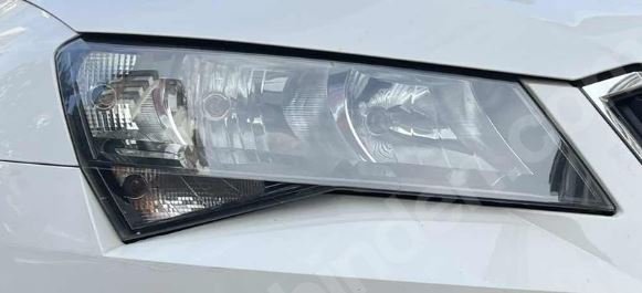

Hello everyone. I own a 2016 Skoda Superb. My vehicle is Active package. As you know, my headlights are halogen. Xenon headlights are available in the upper package Superbs. However, in my country, there is a requirement for headlamp washing and headlight height sensors in vehicles with xenon headlights. If I install a second-hand xenon headlight on my own vehicle, will it be compatible with my vehicle? If I install an LED bulb that does not require a sensor, will it be compatible? My second question is this: My friend has a 2022 model Superb with Elite package. That vehicle does not have headlight washers and lenses. However, its headlights are LED. Will the headlights of the 2022 model Elite package be fully compatible with my 2016 model vehicle?

No u cannot fit xenon headlights to ur car without changing the wiring loom, AFS, A5 camera, Gateway and BCM.
In addition, u'll also need leveling sensors, headlight washer gear (piping, washers, washer cap and bigger washer fluid tank).
No, u cannot fit facelift Superb headlights as they r physically a different size to the pre-facelift ones.  U'll need to change the front bumper and grille too.
Both the above options r too much trouble.
U r better off getting better bulbs for ur halogen and making sure ur headlights r aimed correctly.
I understand Thank you very much. It seems like it would cost me less to sell my vehicle and buy a Superb with a higher package.
