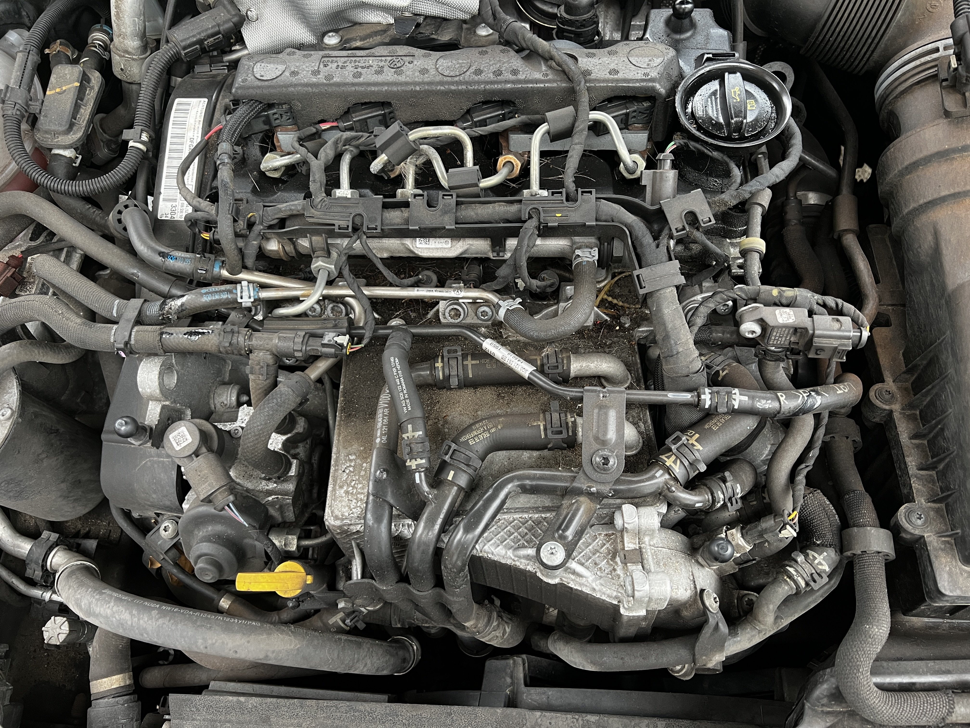

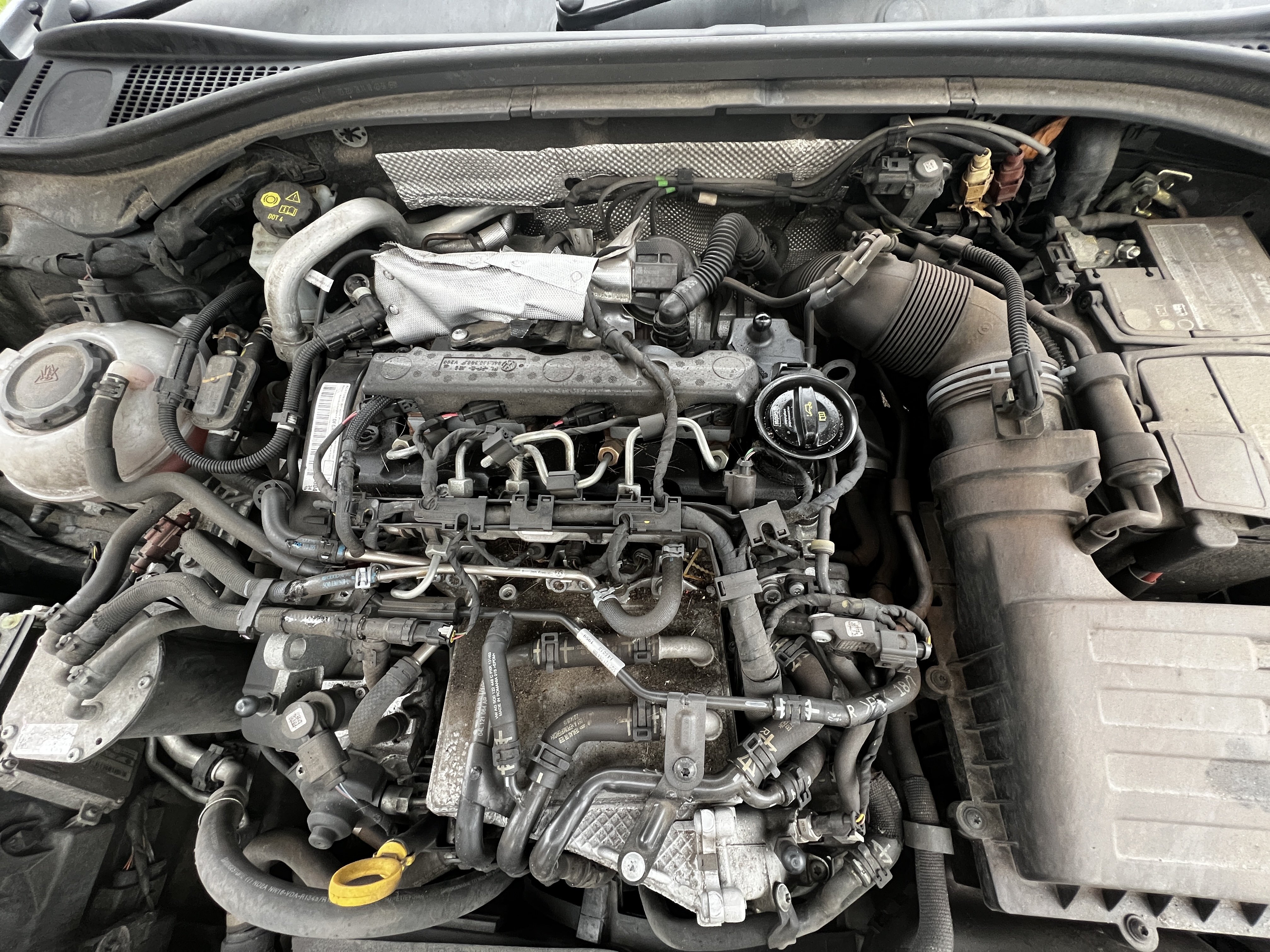

Pop a photo of your engine up, minus any removable top cover.

There are about 3 throttle valves on this engine, give us a clue?
One RHS of charge cooler down the side of the airbox, one on the exhaust, one possibly on the other Low pressure EGR

Sorry, forgot to mention, the throttle valve @J.R. was referring to is down by the airbox, if you follow the charge air route from the turbo to the front of the car you will see it before the airflow goes into the charge cooler although it might be sanwiched between the other EGR stuff and be a pig to look at. Removal of the airbox will be probably be necessary
