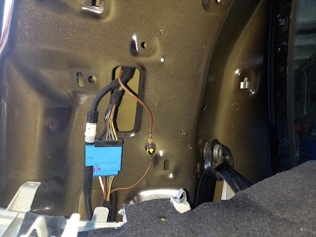

I've nicked this picture from another thread but I think I would be inspecting this plug and earthing point.

Thanks for the advice, I checked the loom with a multimeter and the socket on the main loom side, there seems to be a lack of power coming from the car, as both the license plate lights and the brake light wont work and the motor for the wiper worked then didnt when I tried the next day. I changed out the comfort module which didn't change anything except make the door open light not work properly.
I'll have another look at the socket and give it a good contact clean just in case.
Its definitely an odd problem so hopefully it may be something unusual that may be the solution.
Ok, got back into the car again today trying to find the cause of the problems, went through the loom again, everything is all working fine, checked the connector on the loom, and the lower connector.
had an eureka moment after cleaning the pins of the plug when I found a couple of them were loose in the lower plug and were being pushed down when the loom plug was connected.
Refitted them in and hey presto, wiper motor works, license plate lights work
