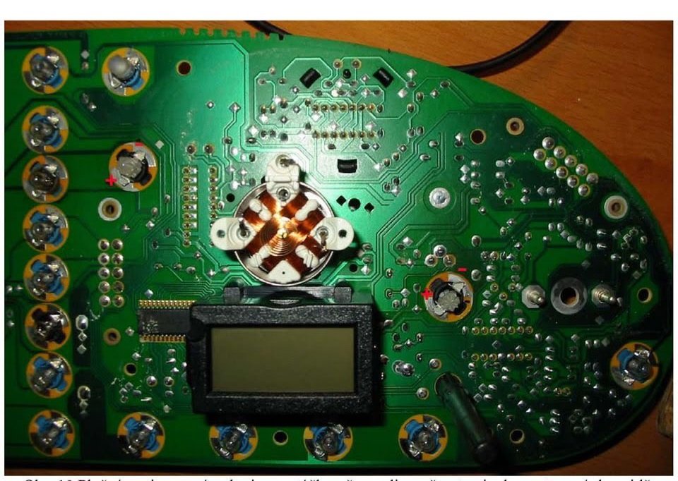

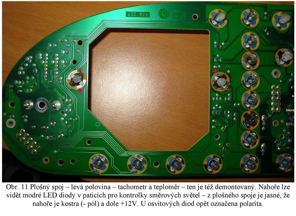

I found something. Pictured from the instruments side. The description says, that for indicator lights, negative is on the top, positive on the bottom.
It's from Skoda Octavia not Felicia, lot of work.

So, what are the polar directions of the lamps here, my friend, I thank you very much for this.
And the polarity of the above signals will also be required 😊
Friends, I am waiting for an answer to my urgent question. I would be glad if you could help me. All poles will be needed.
+And - I would be very happy if you could send me a picture of all the ends marked.
the common ones will be ground
I didn't find any documentation.. you can figure it yourself. since you need to remove the cluster anyway, you can connect it and check each LED and flip it, when needed, before you reassemble the dasboard. Other method would be tracing the lines.
