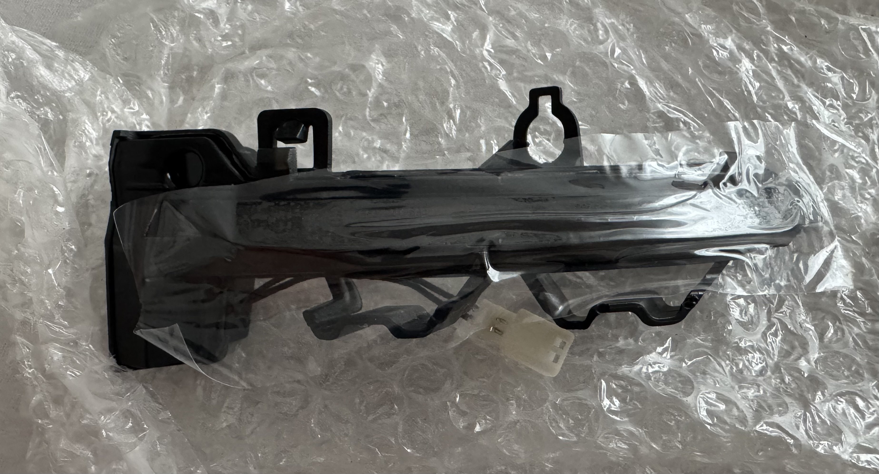

  • Arrived today :-) Also with fake E sign ;-)
  • I think they will fit..

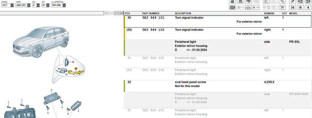

Yes, i have ordered them for testing.. we will see it they fit.. part numbers are correct.. an the image looks like the tuen signal lights for the MK4..

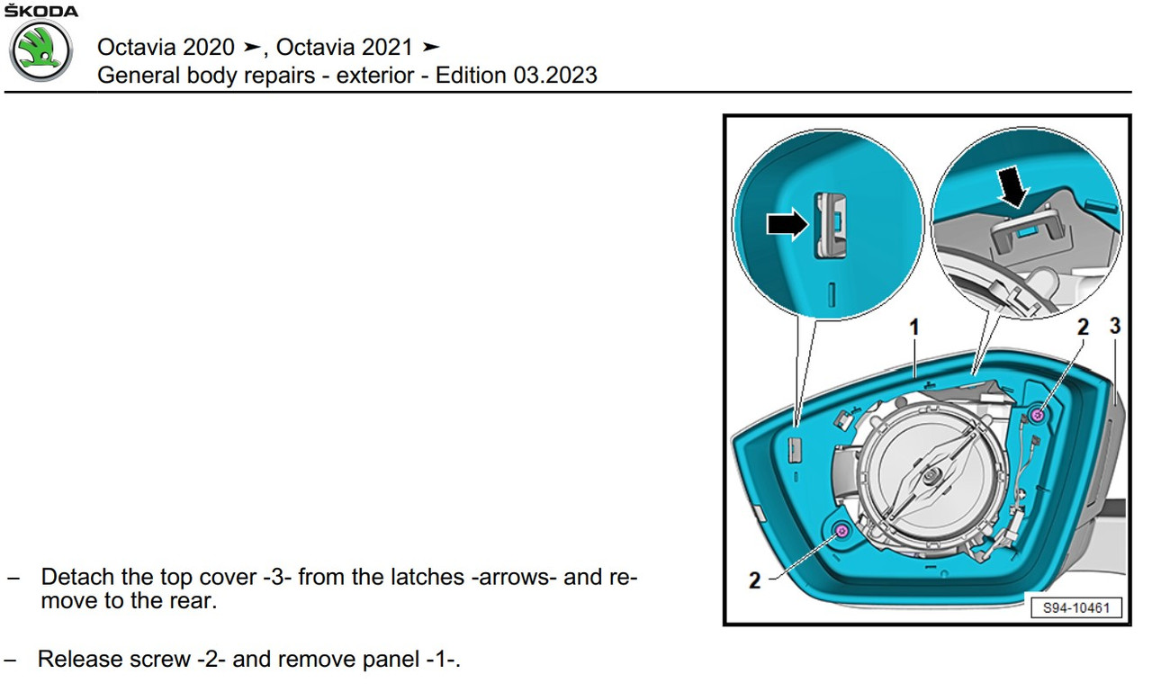

So next step will be to check how the change the turn signal light..
As far as I know you start with the glass.. next step the trim behind the glass and finally the mirror cap..

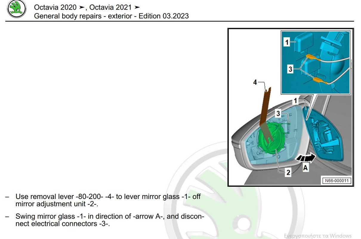

It's the same procedure as Octavia MK3
This is the steps

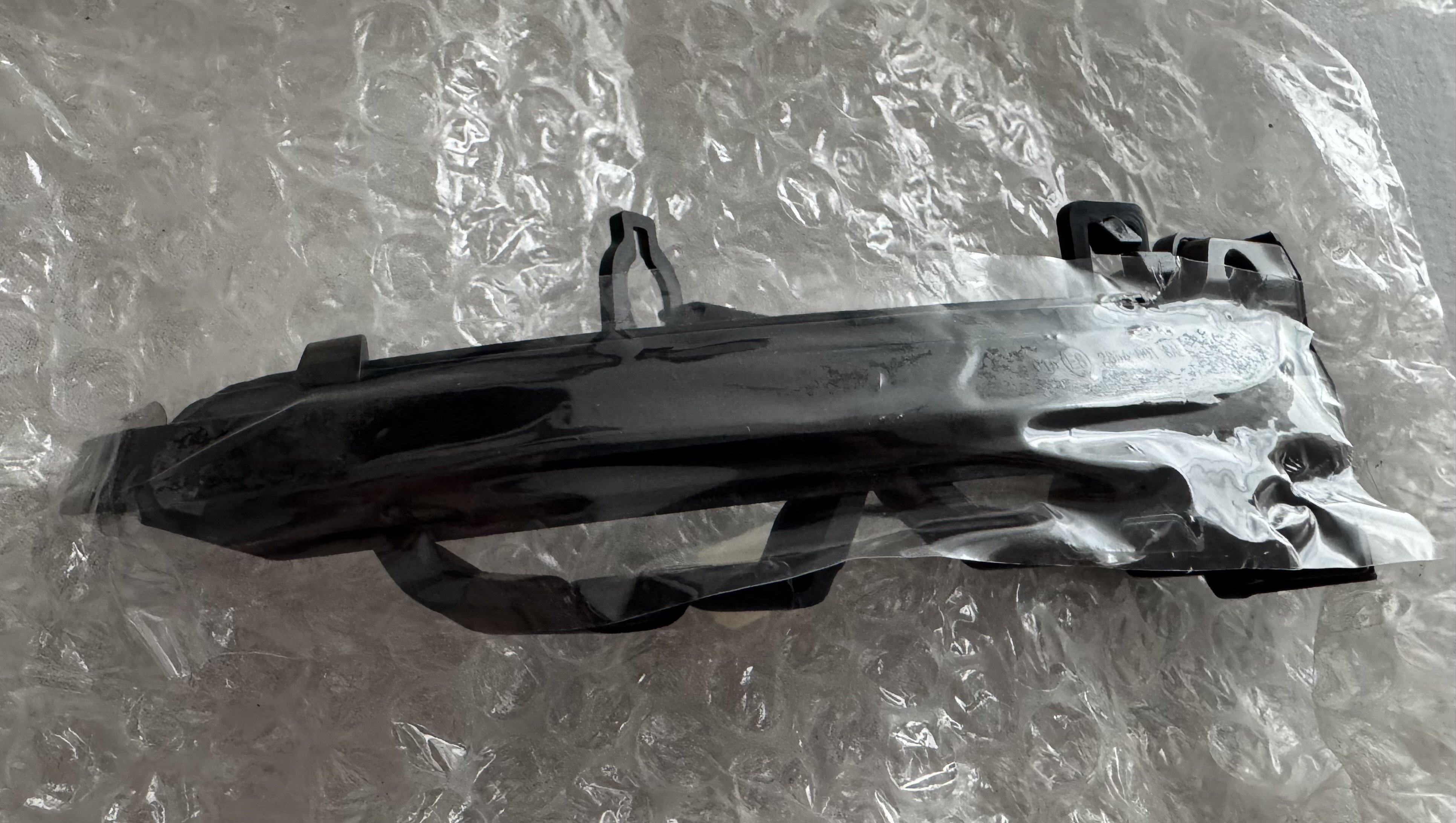

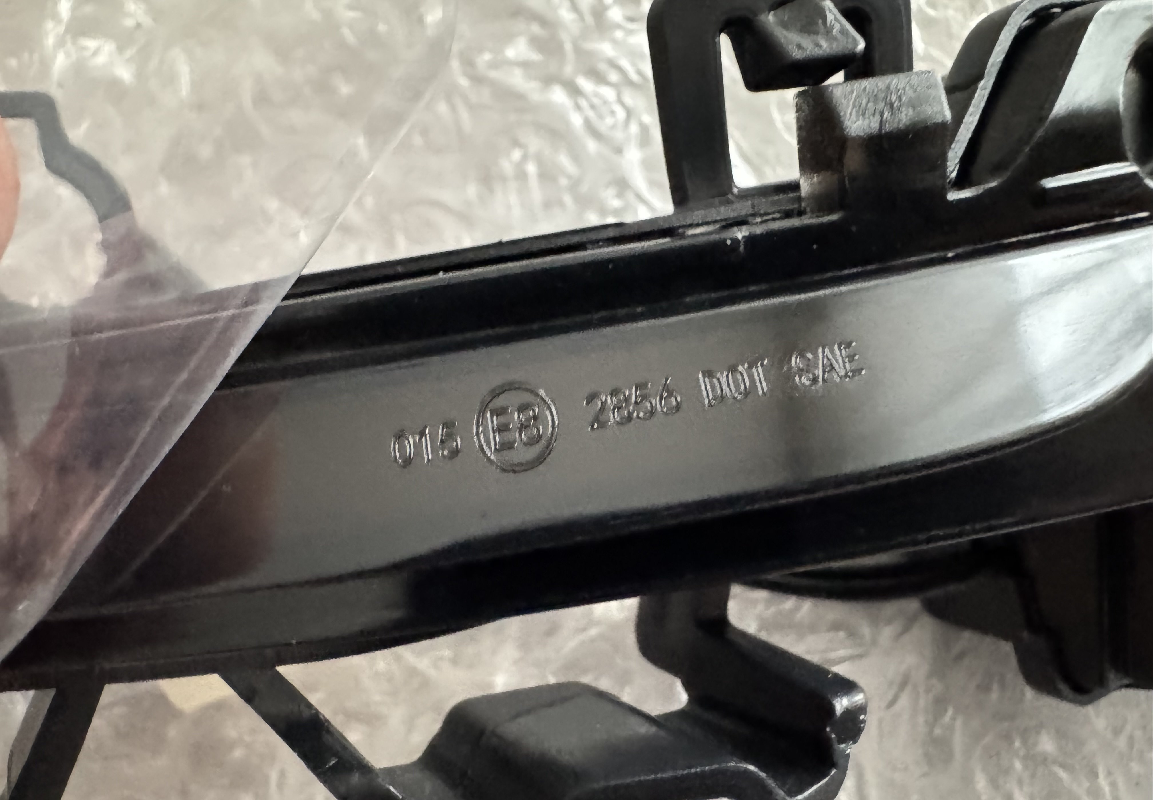

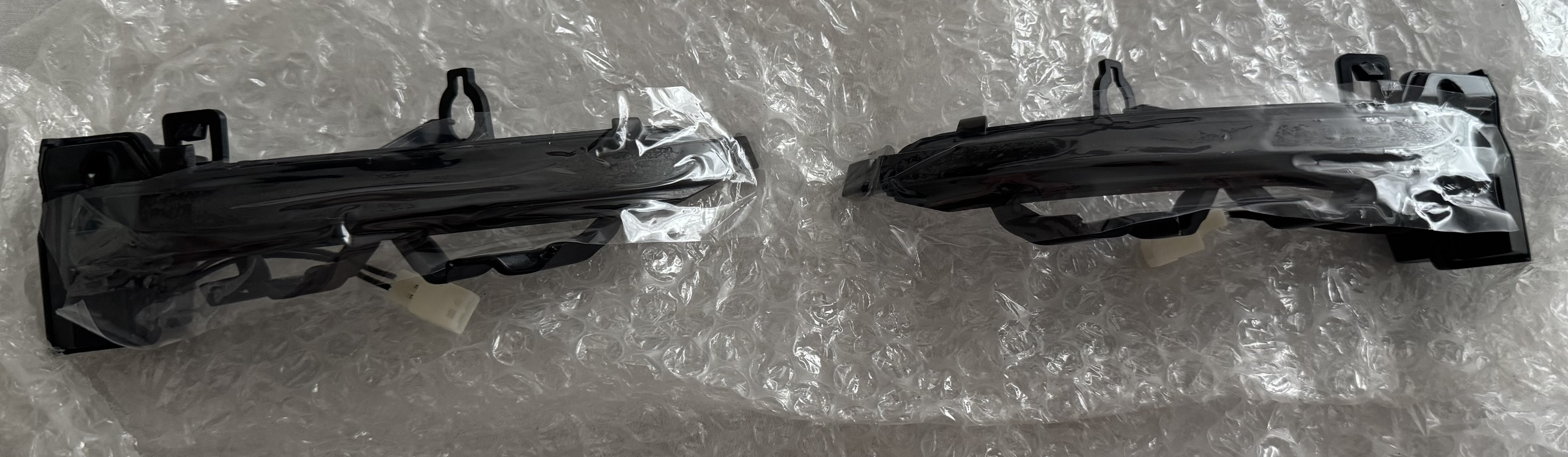

Arrived today :-)

Note: From my experience, and to facilitate the removal of the mirror, way better to tilt it in order to have more room to pry.
I didnt install mine yet.. ver busy at the moment and i want do seal the cable first.
1 hour ago, Mario_Delgado said:
I will do a clip when installed, they are still in transit but I think they will come beginning next week the latest.
What exactly do you mean with facilitate?
Well, kind of common sense, If you want to push the mirror from behind with a pry tool you will need room to introduce the tool and apply pressure to release the mirror. To get that room, lower the mirror to max position and turn it to inner max position.
As you can see in the workshop manual, that step is not listed.
