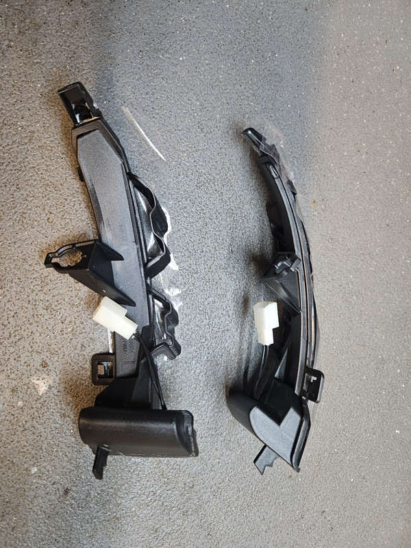

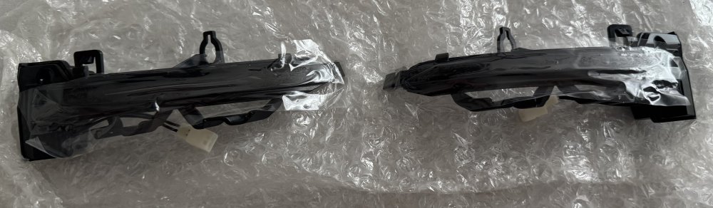

I recieved them
I tested them, working fine.

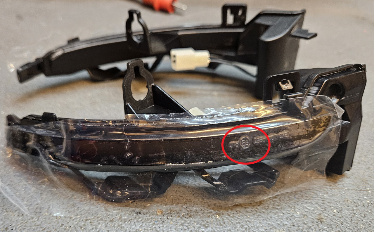

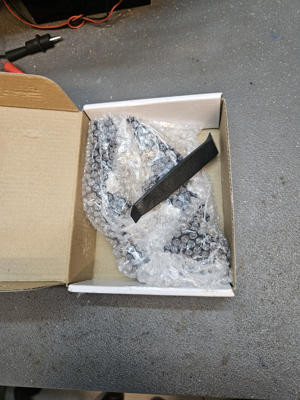

  • Arrived today :-) Also with fake E sign ;-)
  • I think they will fit..

I recieved them

Well, i did the installation. One hour for both sides.

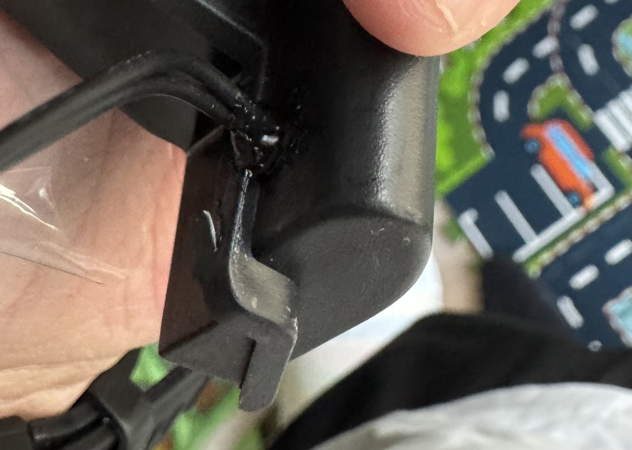

Great work Giannis! I sealed the cable and will install mine soon! They look amazing!

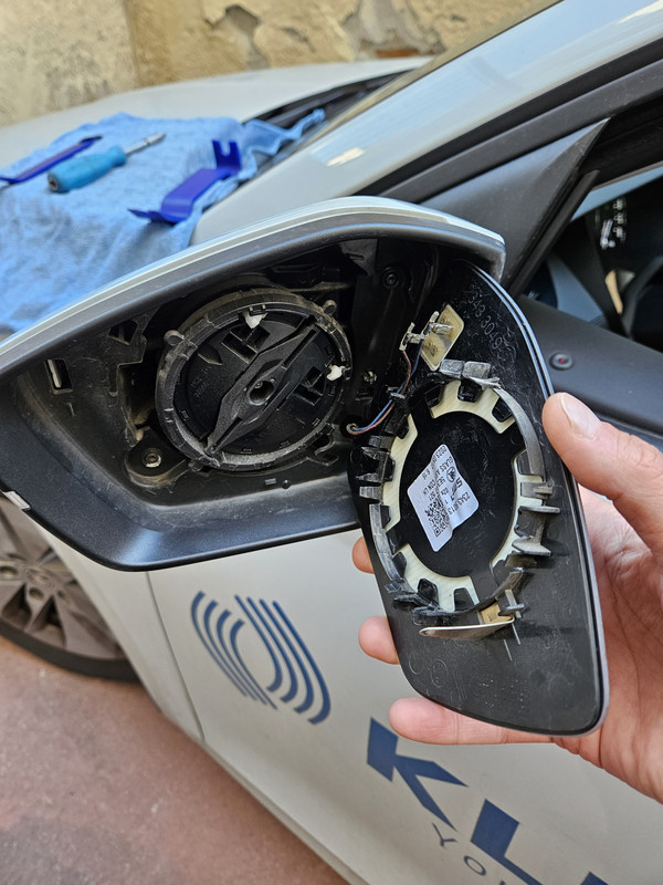

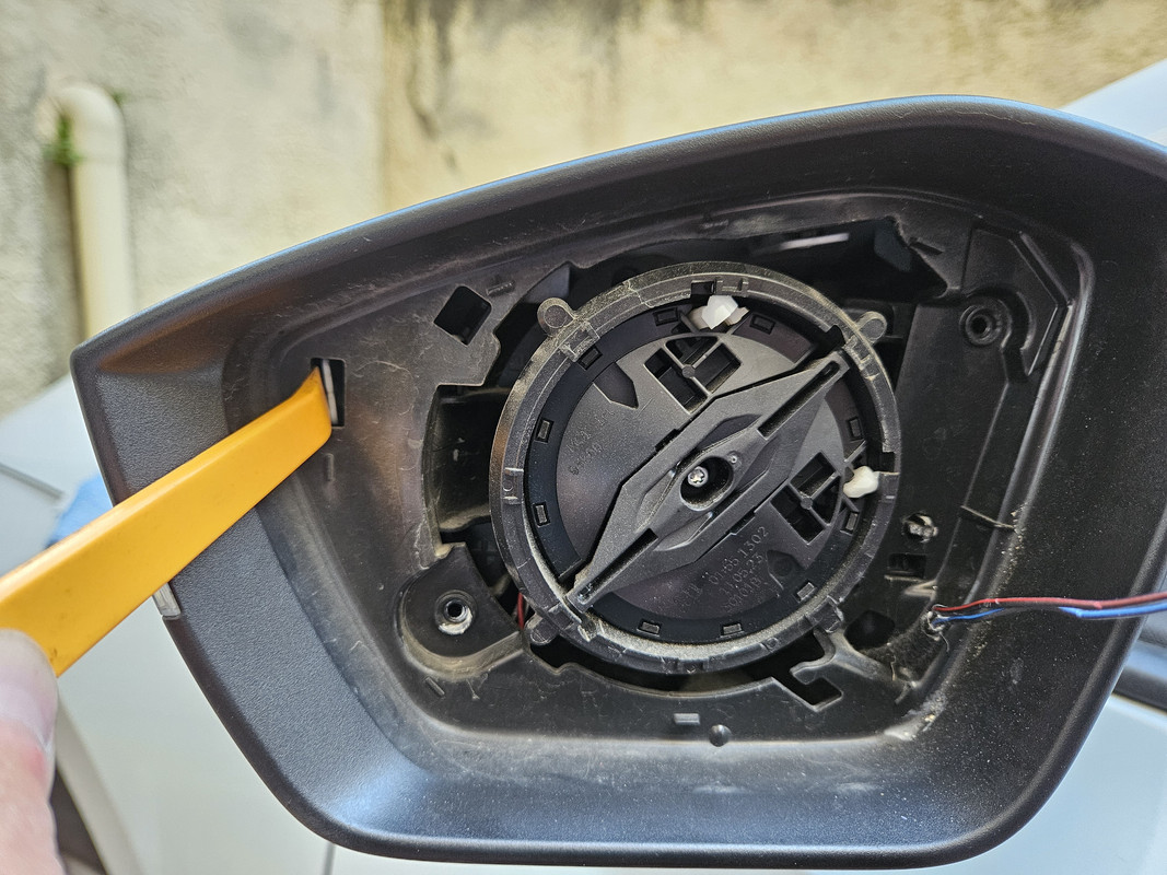

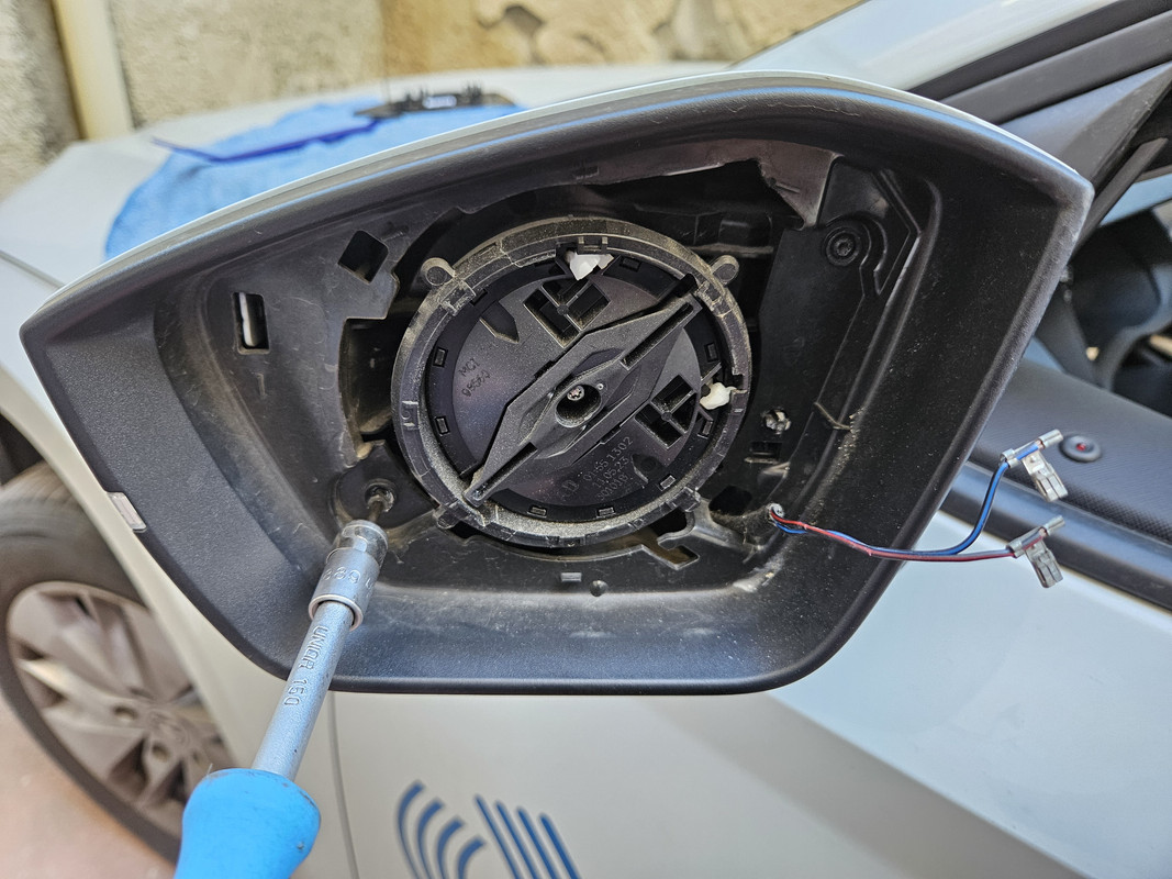

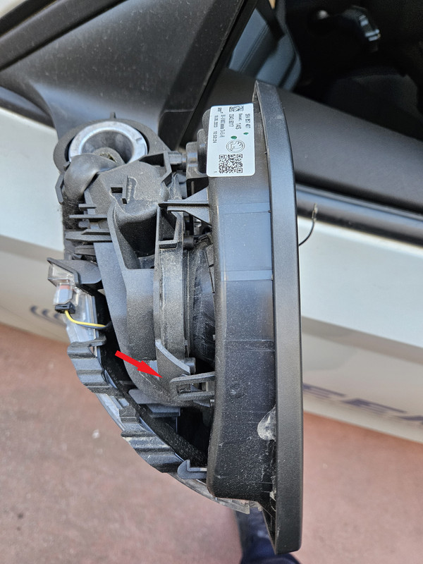

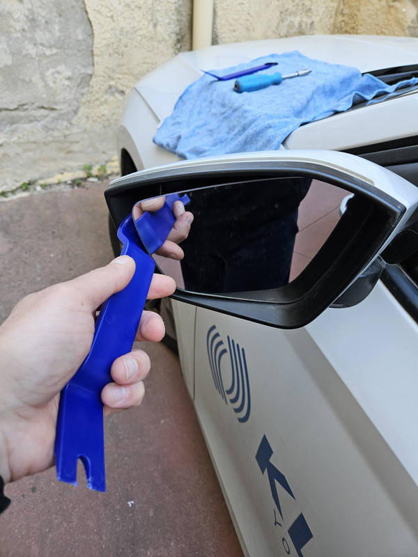

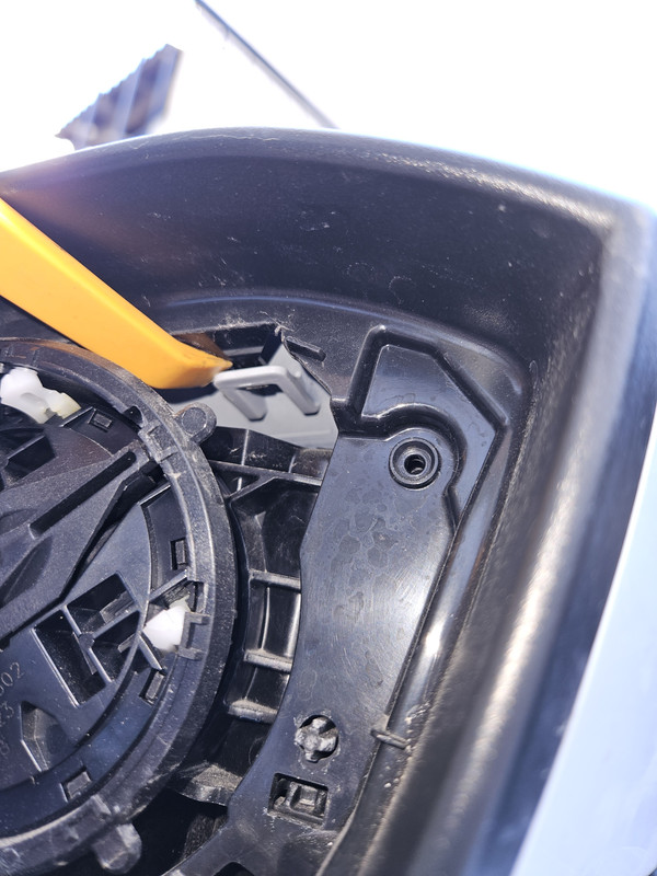

Here some photos from the procedure, i t might help someone.
Mirror removal:
2 screws
Clips for the upper part.
Front frame removal
Edited by Giannis20

There is no hard step on the installation.
Mirror removal:
2 screws
Front frame removal
Thank you for the pictures! Next weekend i will install mind :)

Hello @Lukas_2611 ,
What product did you use to seal the cables?
Something similar to:
Liquid Insulating Tape Repair Rubber
https://a.aliexpress.com/_Eut4iWW
Thank you
10 hours ago, djmartzian said:
Hello @Lukas_2611 ,
Thank you
Hi,
i used a black silicone. You just need to make sure that no moisture can get inside. So I think silicone can do this job very well.

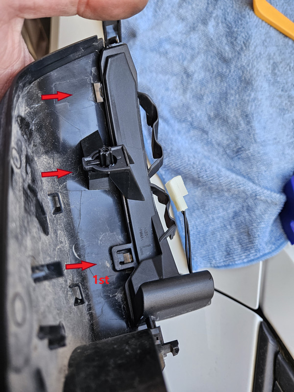

How did you disassemble the unit without breaking? I think its really tough.. maybe i am doing something wrong..
Please be more specific. I don't understand which part do you mean.

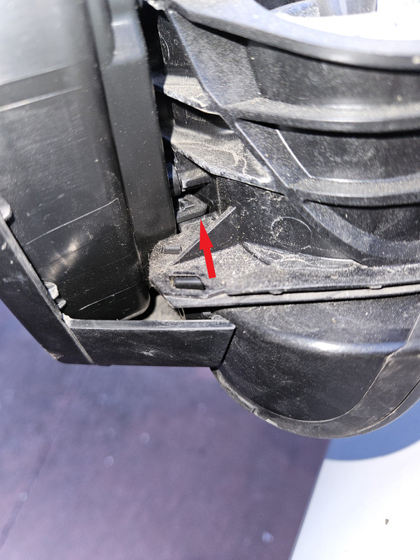

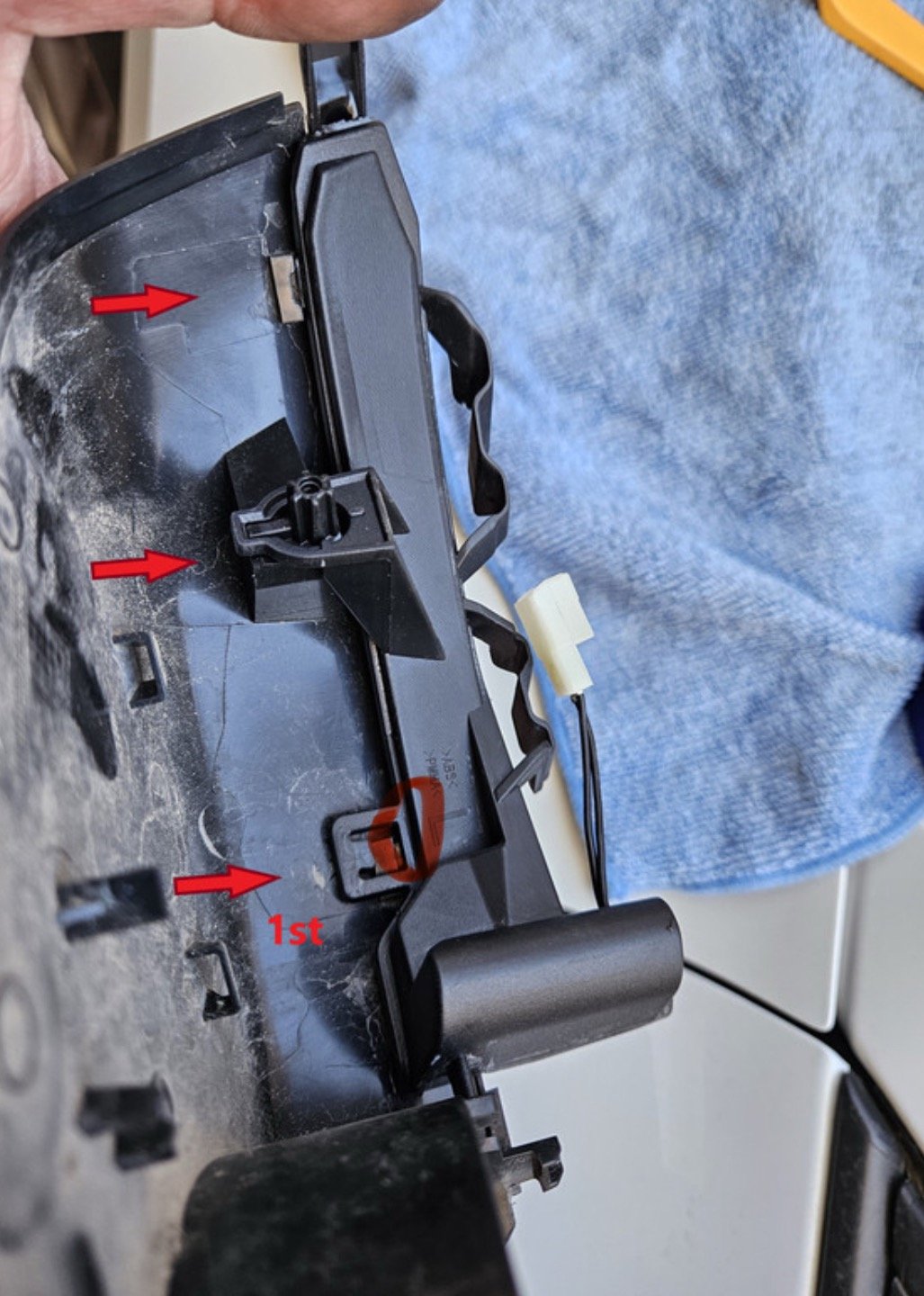

I mean to dissamble the indicator unit out of the cover..
yes I understand.
It is a little difficult, because it is fastened in 3 places.
A little patience, start from the inner fastening, it comes out easily, the difficult part is the edge, that's where you need to be careful because the protrusion can break.
Edited by Giannis20
12 minutes ago, Giannis20 said:
yes I understand.
I broke this little part 4x times.. on the originals and on the new ones.. xD ..
So I ordered new running lights... they are on the way..
The running light units where also a little damaged on the edge.. so I hope the new ones are better..

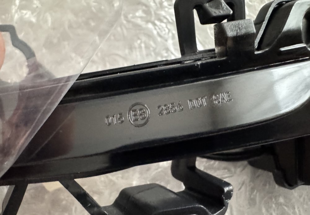

I also recognized that the E sign was wrongly made.. so how its called.. upside down? Are yours in the right position?
Thanks for the pic.. I started at the edge.. so on the outer part.. maybe that was the mistake..

@Giannis20 is your E Sign in the correct position? :)
Sorry, i didn't understand what you mean.
There is a sign on the light unit.. 015 E 12345 or something like that. On my running lights it was upside down.. so when installed wrong pposition
ΟΚ, you mean the E sign
It's upside down, as you can see in the photo. But they work as they should.
