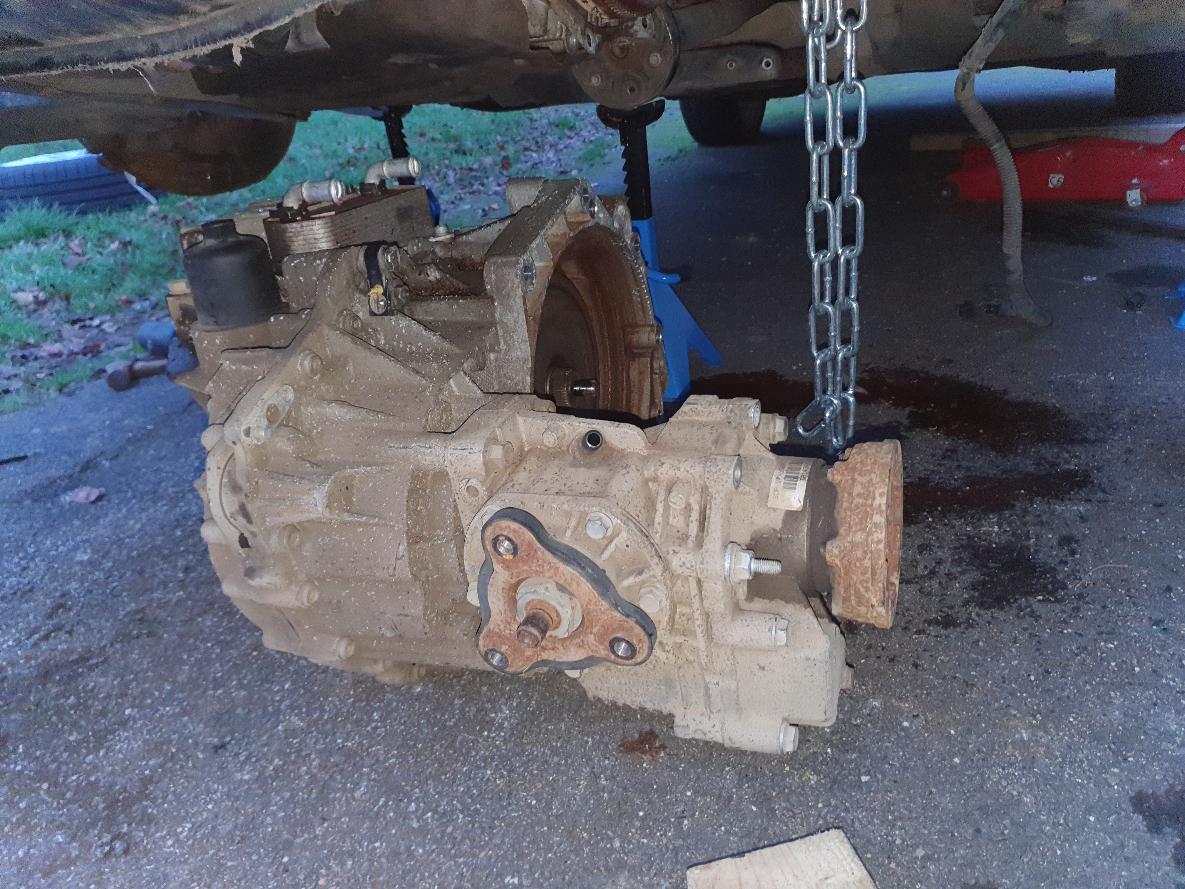

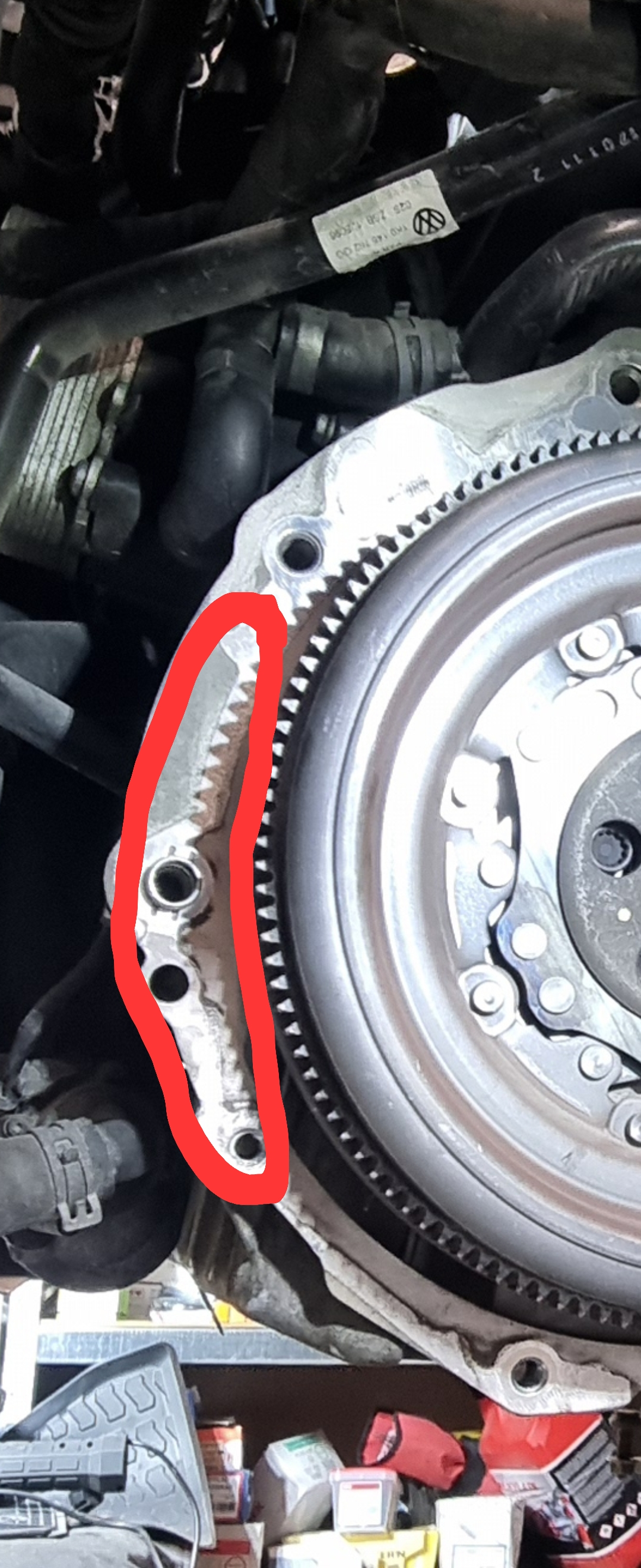

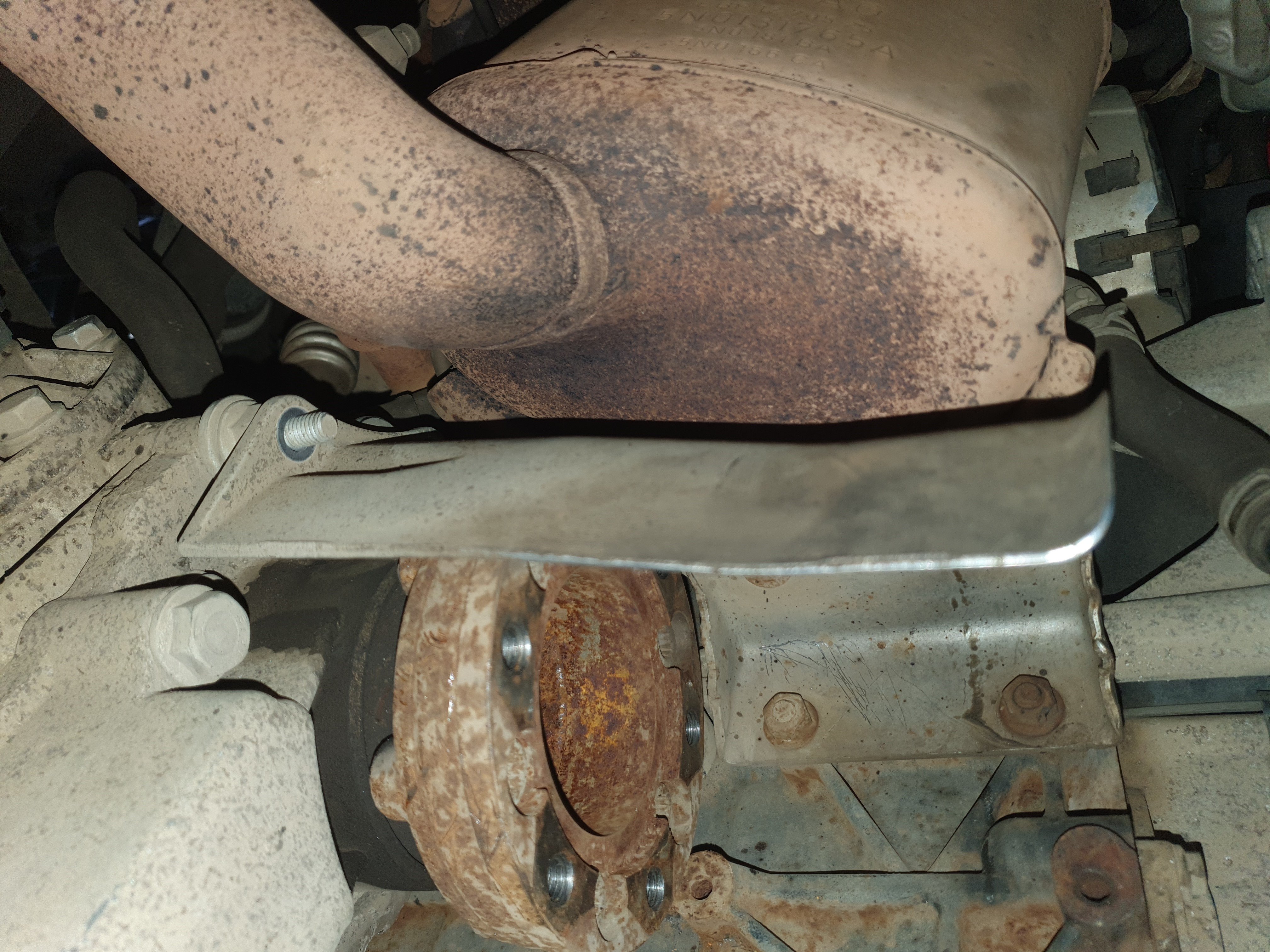

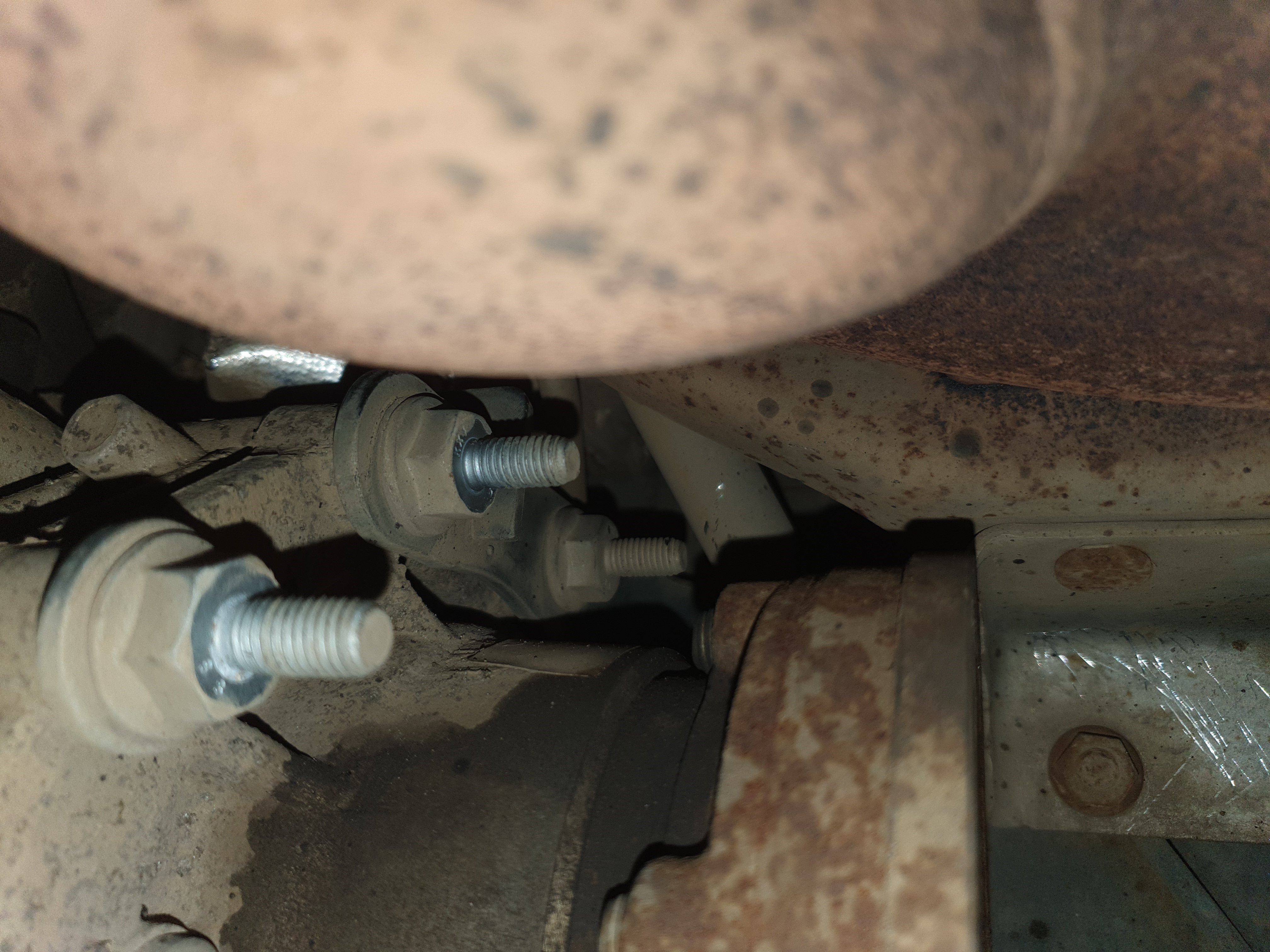

I only managed to get back under the car today. And only for an hour or so, but it was productive. After some more levering I decided there was definitely something I had not undone. I got an 8mm hex and took off the surround sheet of metal above the flange (picture 1). I hadn't tried it yet as it appeared to only be attached to the transfer box. Once off it revealed a super secret bracket. 2x 16mm bolts (pic 2) later and the gearbox is swinging with ease, ready to drop. Then the alarm went off to get the kid from school and my time had run out. I'll get that gearbox dropped at the weekend and start on the actual flywheel. Then I'll try and remember how it all goes back together. I'll watch some videos on alignment before I do the final tighten on the sub frame bolts, and see if I can get ahead of any alignment issues. I'll also look in to those prop shaft couplers while I'm at it.

Oh, I thought you had that axle shield off and loosened the 2 bolts already..my mistake. But yes, when shield is off, you get access to the 2 last bolts for the bracket yes. Weekend work it is, and struggle is a thing. But once this is done, think of all money saved and You have tackled one of the toughest jobs on this car!!

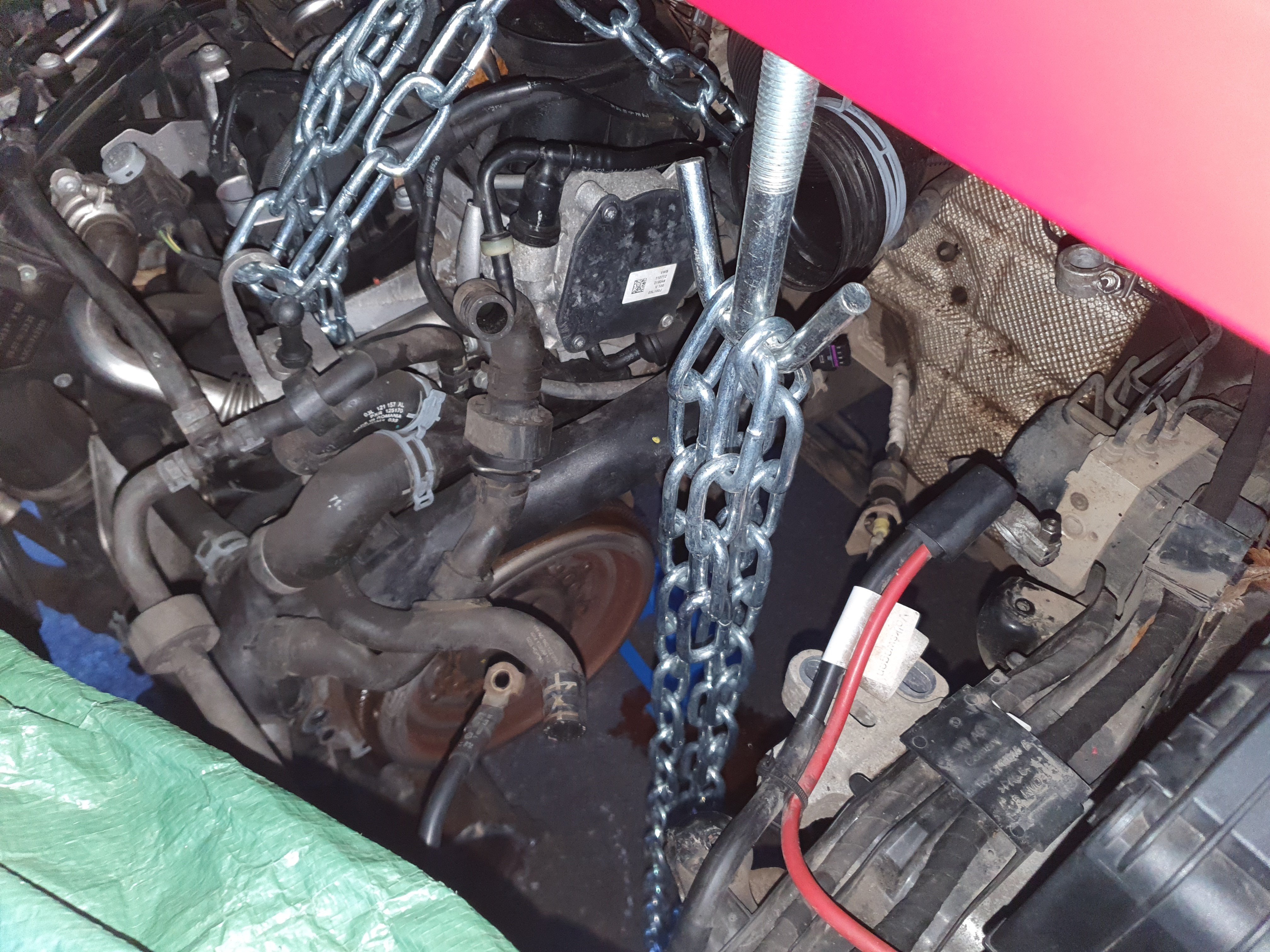

Mildly terrifying, but actually went pretty smooth with my planned method. Got the Mrs to slowly unscrew the chain on the engine hanger while I was underneath (to one side) with a lever gently nudging it in the right directions, with a jack to help in places and hold it up while I adjusted the chain and reset the thread for more distance. Flywheel replacement tomorrow! Not sure how to approach getting it back in just yet. Might have to marry someone stronger.
Nice one!!! Very well done. Just think about the amount of money saved and experience gained! Try to find the small black plastic thing that is supposed to be on top of the red ring. It is ventilation for diff oil. Should be loosely on when mounted.

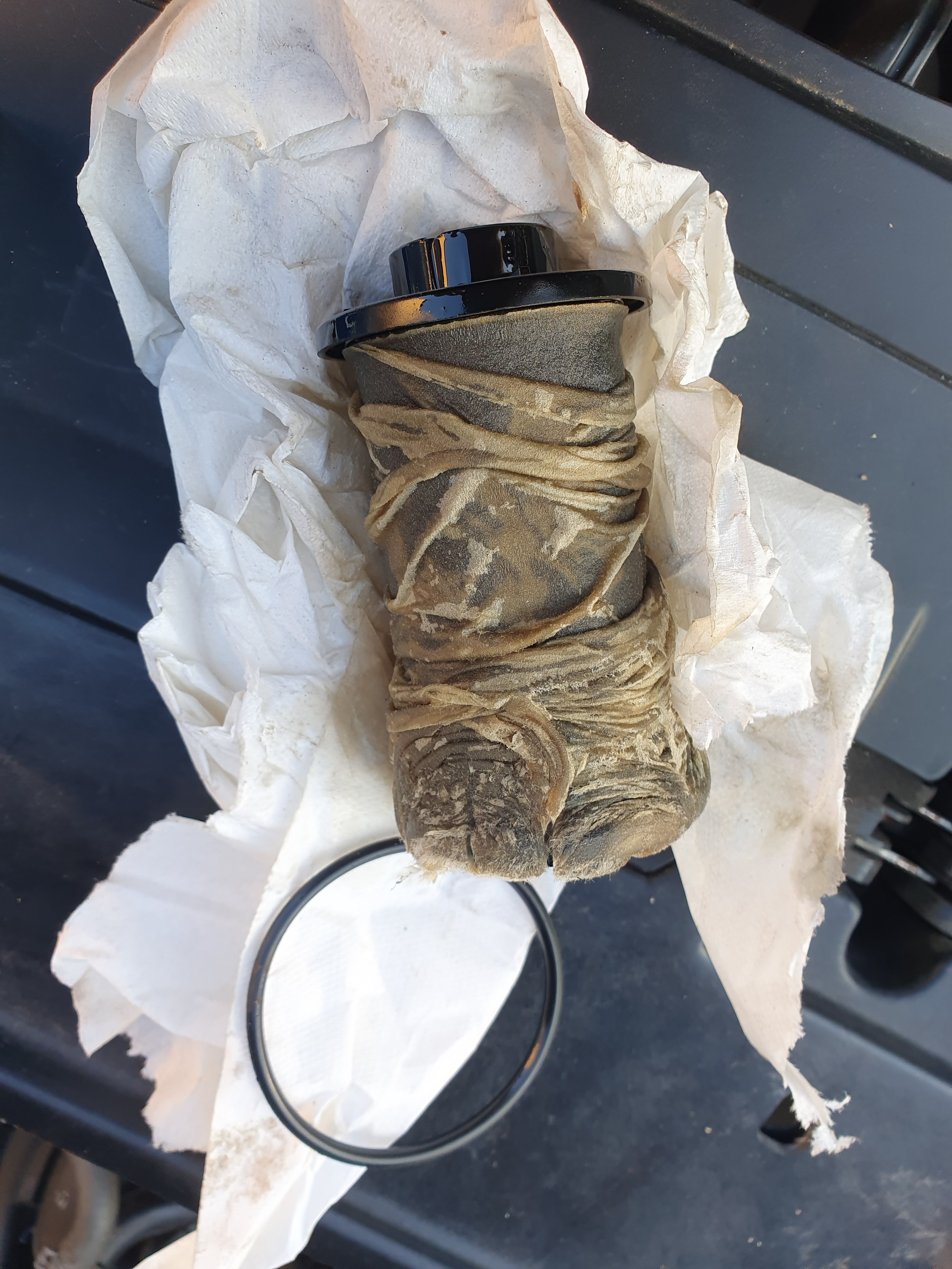

I believe P1741 may have been fixed by me tightening the transmission oil bolt. There was a bit of oil around it so I'm assuming it just needed pinching a little over spec. I only loosened it to make sure I had the right size hex key, and probably didn't pinch it up enough. I changed the oil filter, but haven't gotten round to the oil itself yet.

The oil filter!
5 hours ago, wilcopshot said:
The oil filter!
Holy mother of g....!!
