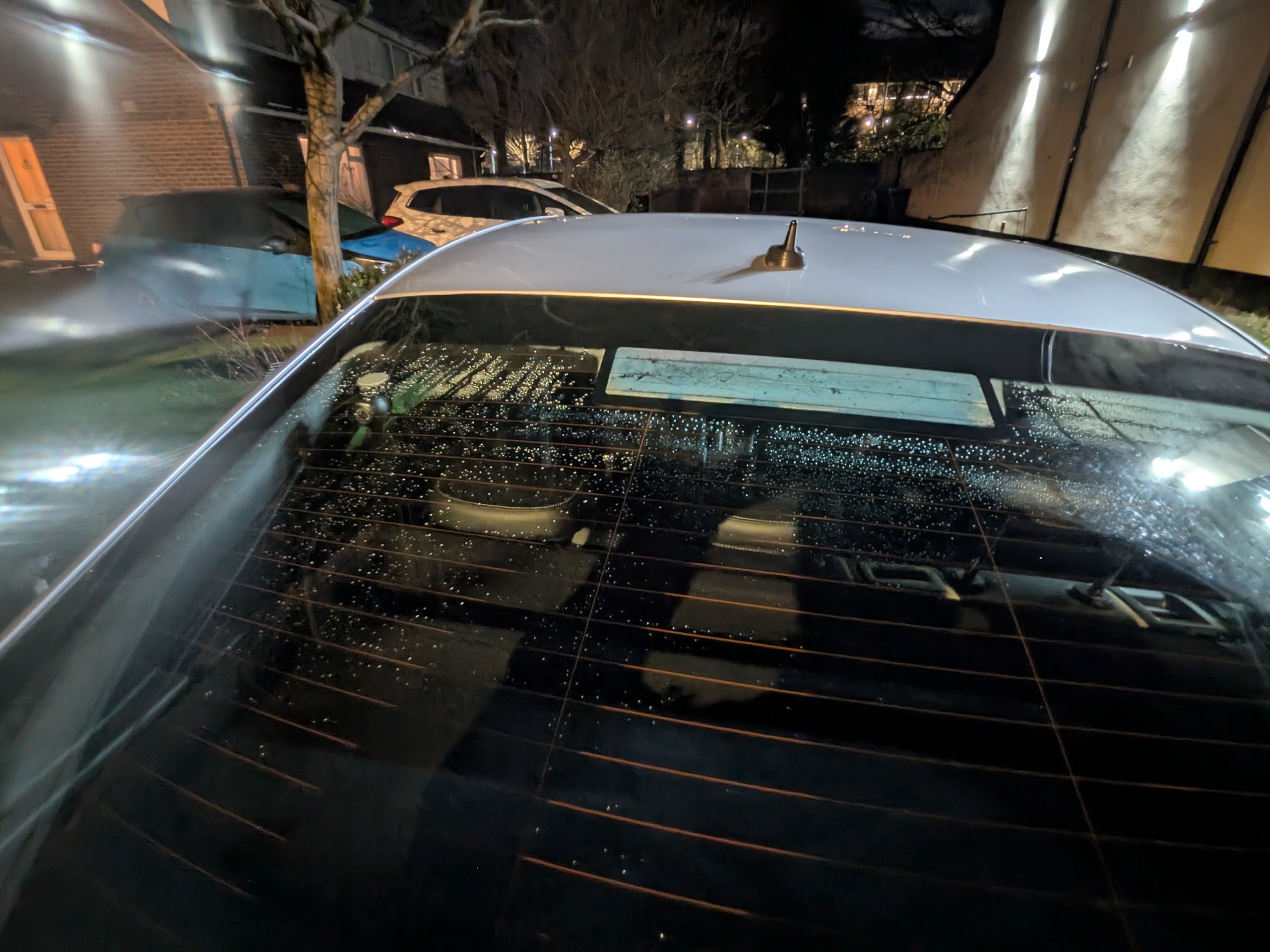

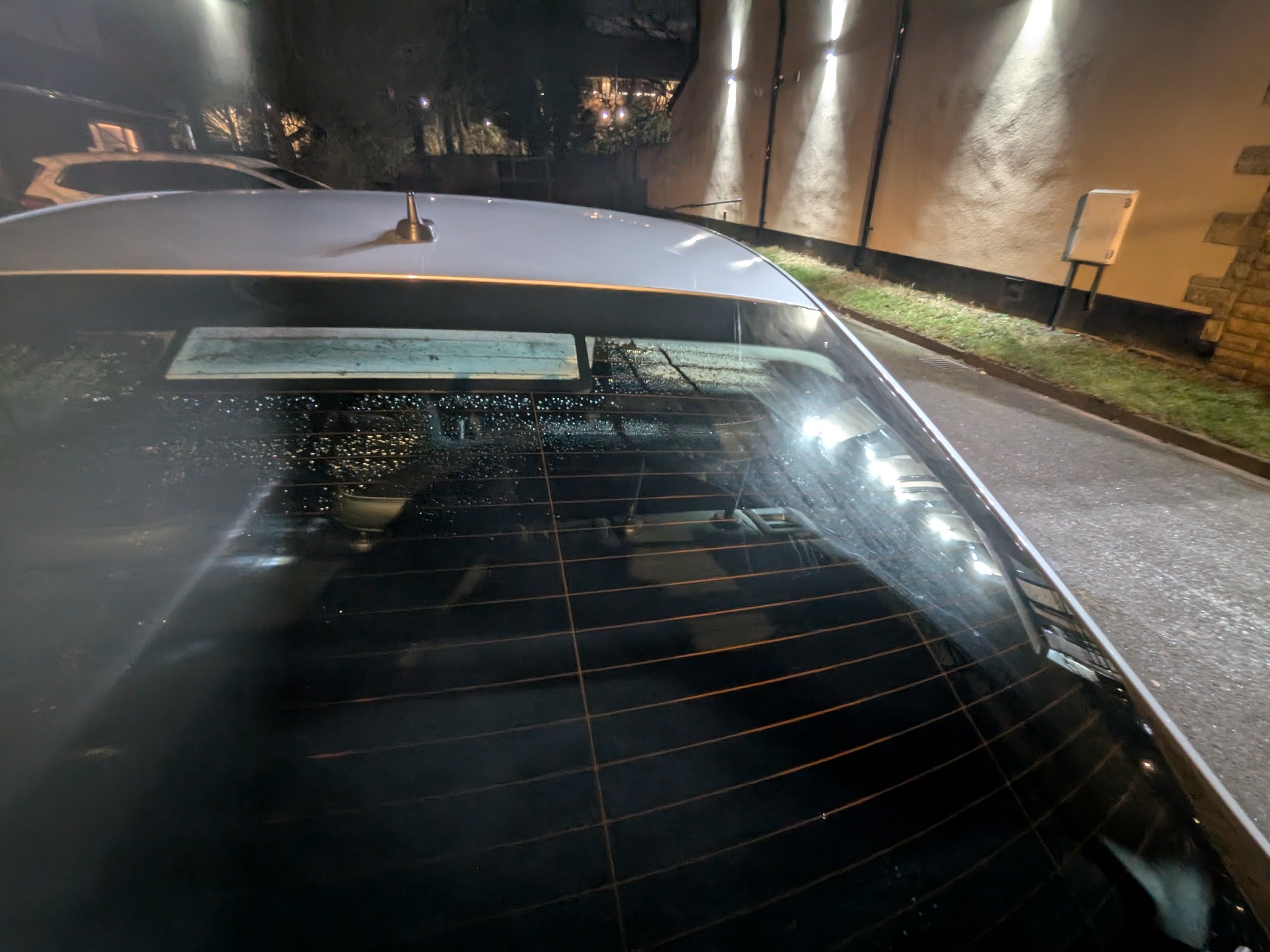

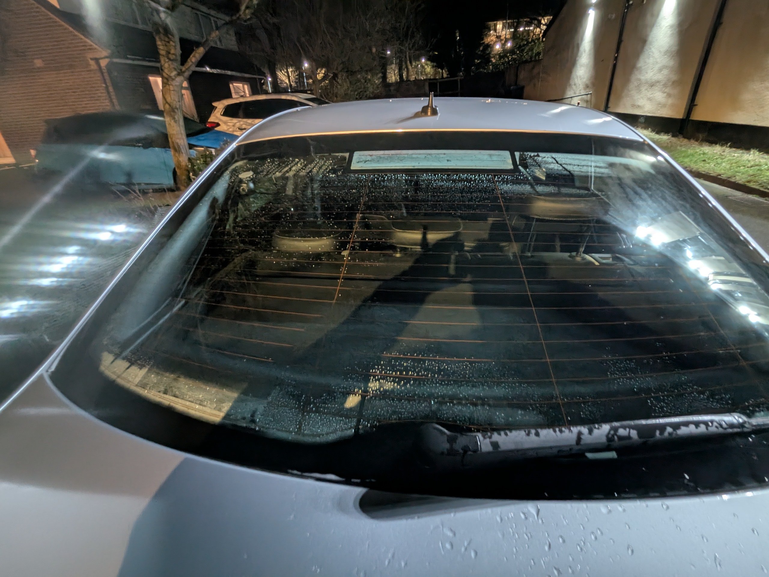

An update on the radio. Both FM and DAB reception are out with the rear demist active.
A few elements on the rear demist are out.
Both problems might be linked?

I've discovered the three lines in front of the brake light are the FM and DAB aerials. So they won't demist.
(The roof mount sharkfin is for GPS and mobile phone signal).
So it could be a bad earth? There's an aerial amplifier. If this isn't getting power, then there's no signal.
I'll get the Skoda dealership to investigate. They might have nudged something when the dash cam was fitted.
