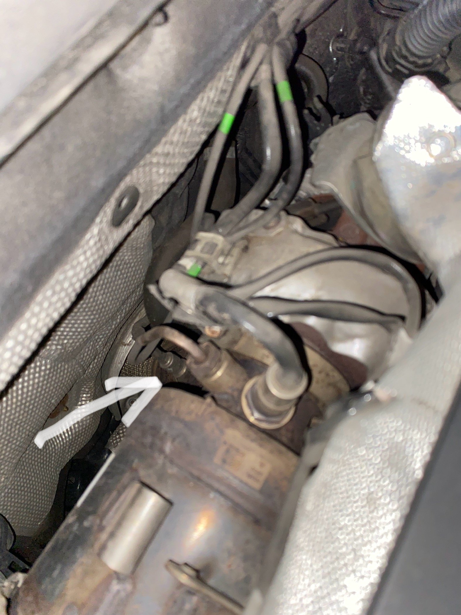

I'd be a bit surprised if there's more than one oxygen sensor. Can check via wiring diagrams later.
Hi Pete.
Yes, there're two O2 sensors. Marked is 2nd, analysing.
