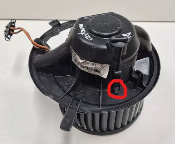

Hi Mike,
I 'think' I was able to tell whether the motor was seized by reaching my fingers through the pollen filter opening (beware it has some very sharp edges to it that draw blood easily) and that led to me taking it off.  From memory the motor and fan itself were attached to the base mounting plate by a large rubber fitting that had three push fit rubber tabs onto the mounting plate, so I had to use a screwdriver to compress the rubber tabs enough to remove it the motor and fan from the mounting plate and get access to the bearing.   It's all eminently doable but did require a bit of scrabbling about to get the motor out and back in, albeit with everything else possible on a work bench.
