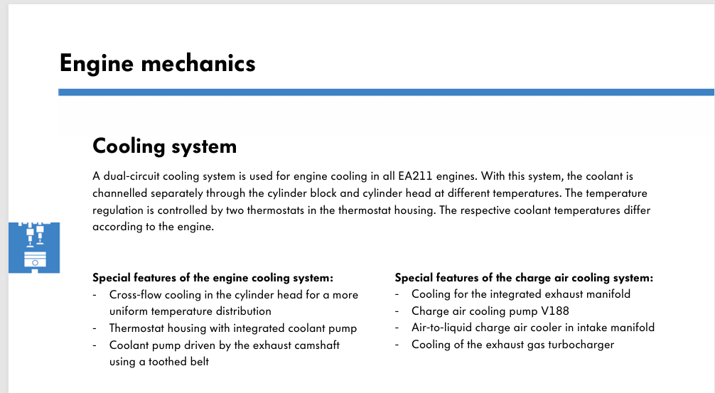

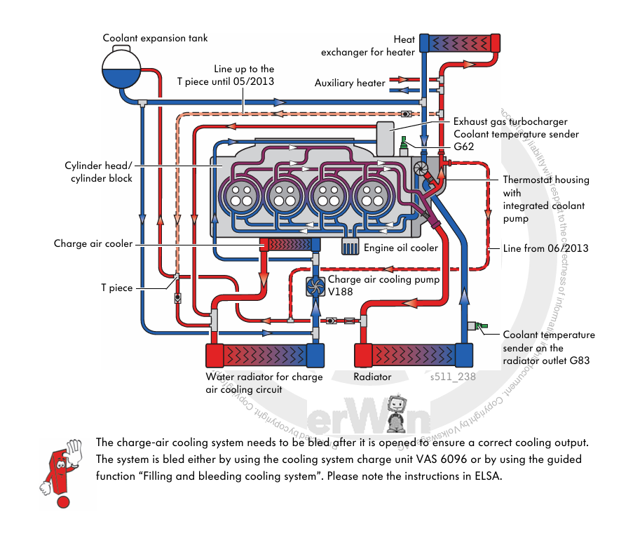

On 19/01/2025 at 13:56, jimbomcmxc said:
cooling charge kit is noted as a tool to do this.
This might help:-
https://www.google.com/search?q=VAS+6096+tool
Thanks.  AG Falco
Edited by AGFalco
added link to tool
On 19/01/2025 at 15:52, nta16 said:
Another thought - you have put the cabin heater on warmest setting to get the coolant going around the heater matrix?
Not any more.
Note in the diagram above there is no valve between the engine and the heat exchanger for the cabin heater.
Thanks.  AG Falco
Thanks, force of habit, later thoughts.  So how does the heater get hot and cold then?
The heat exchanger has a constant supply of water straight front the cylinder head.
This speeds up the heat to the cabin from a cold engine as you are not waiting for all the coolant to warm up.
The valves were a crude design which also gave problems with leaking / sticking.
It is the air flow that is changed now. A small leak of air does no harm.
So the air can get directed from, all through the heat exchanger, to none through the heat exchanger.
