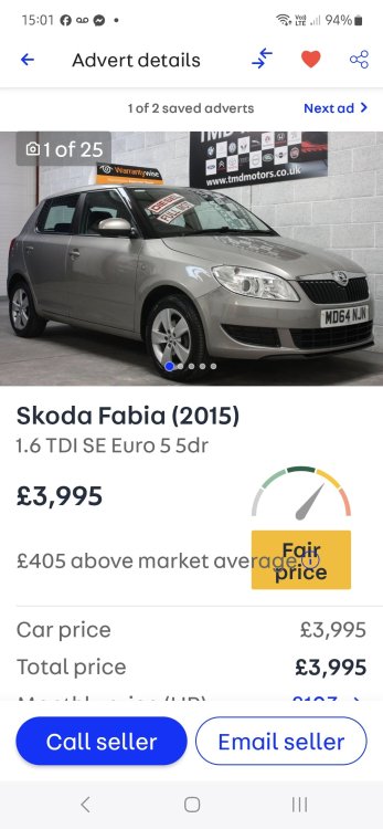

Went to see the car this morning without an appointment.
I was given the keys and had a look round it.
Obviously had not been started. Which it did without issue. Couldn't fault anything, everything worked and immaculate inside and out.
I take on board the injector problem and no evidence of a timing belt change in the somewhat sketchy service record.
I didn't have a test drive at this stage.
Autotrader gives it a fair price mark. £3995.
Thanks for the info guys

Apart from that looks like a nice car from the pic.

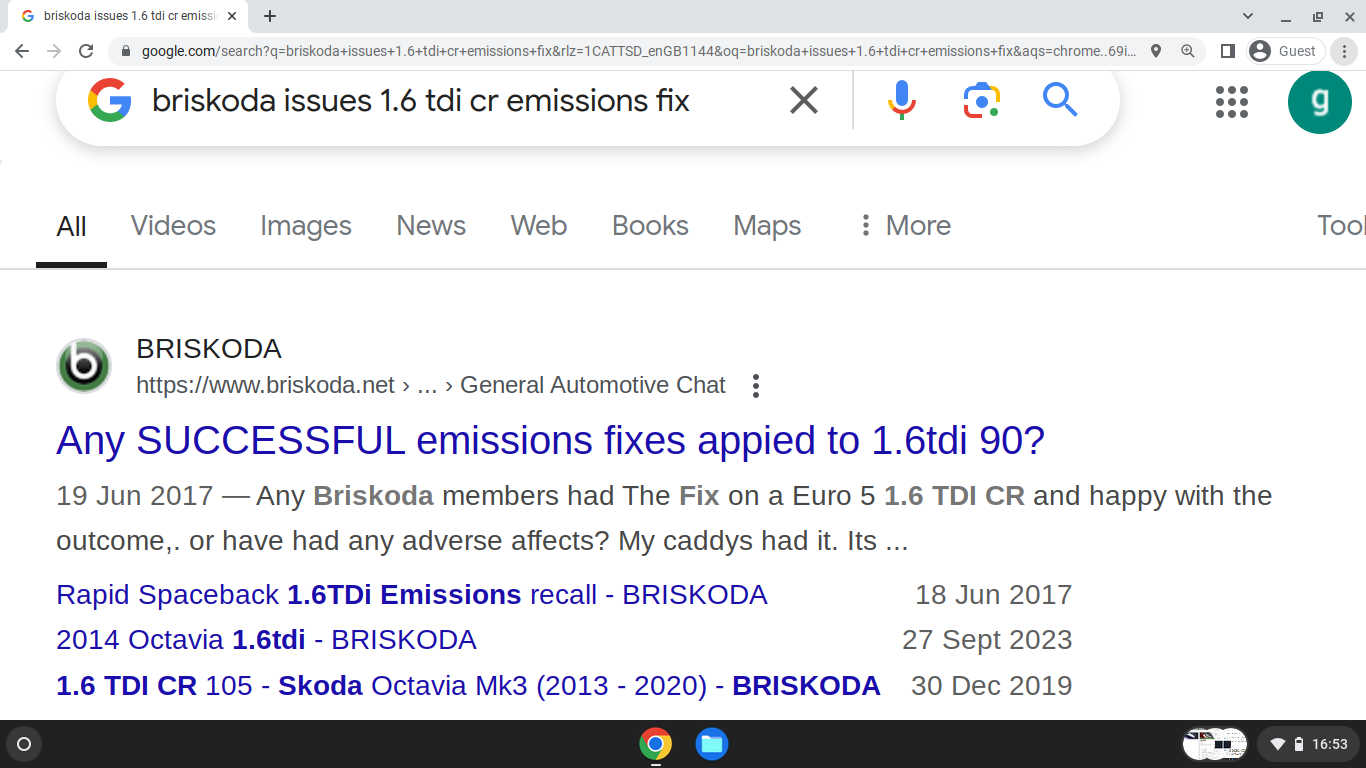

Did the owner let Skoda / VW do the Emissions fix on it?  Or did they maybe wisely say no!
New engine management and the Air Flow device in the Air Filter intake pipe.
http://skoda-auto.com/services/recall-campaigns
I haven't any idea about the emissions fix. Why was it not the thing to do?
Think I read it was that certain cars after emissions fix lost some power and mpg dropped. I think it was an ECU software update. It was after the vw/skoda emisions scandal. You can check by entering VIN into link posted.
Alasdair
Obviously not all cars had issues, and the Peace of mind 2 year guarantee from VW Group saved some with cars that were ruined, and some just got shot of the cars.
Some had The Fix rolled back, and removed the flow device.
Think I came across this issue. Heard about few years ago when I had skodas.
