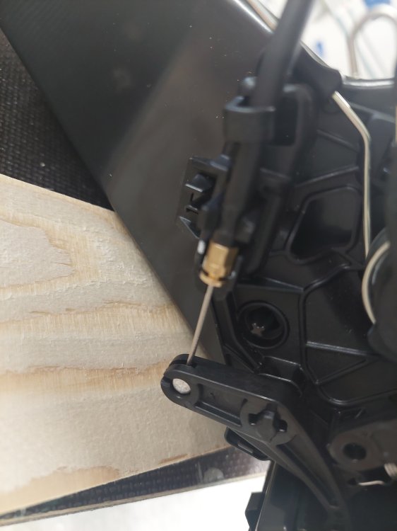

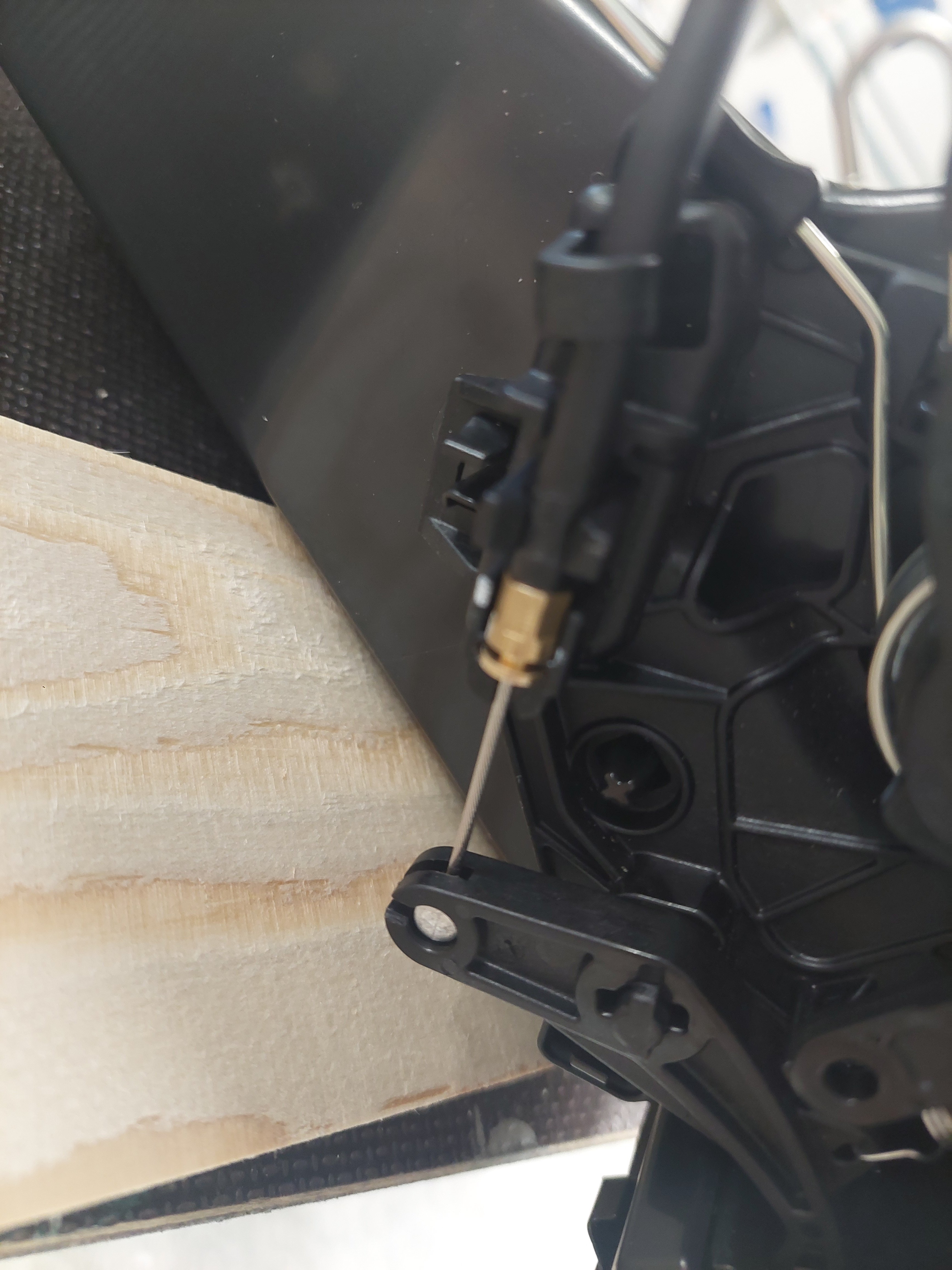

This is the section at the door. You can see the spring to the right that pushes the door up. The end of the cable and its ferrule are visible.

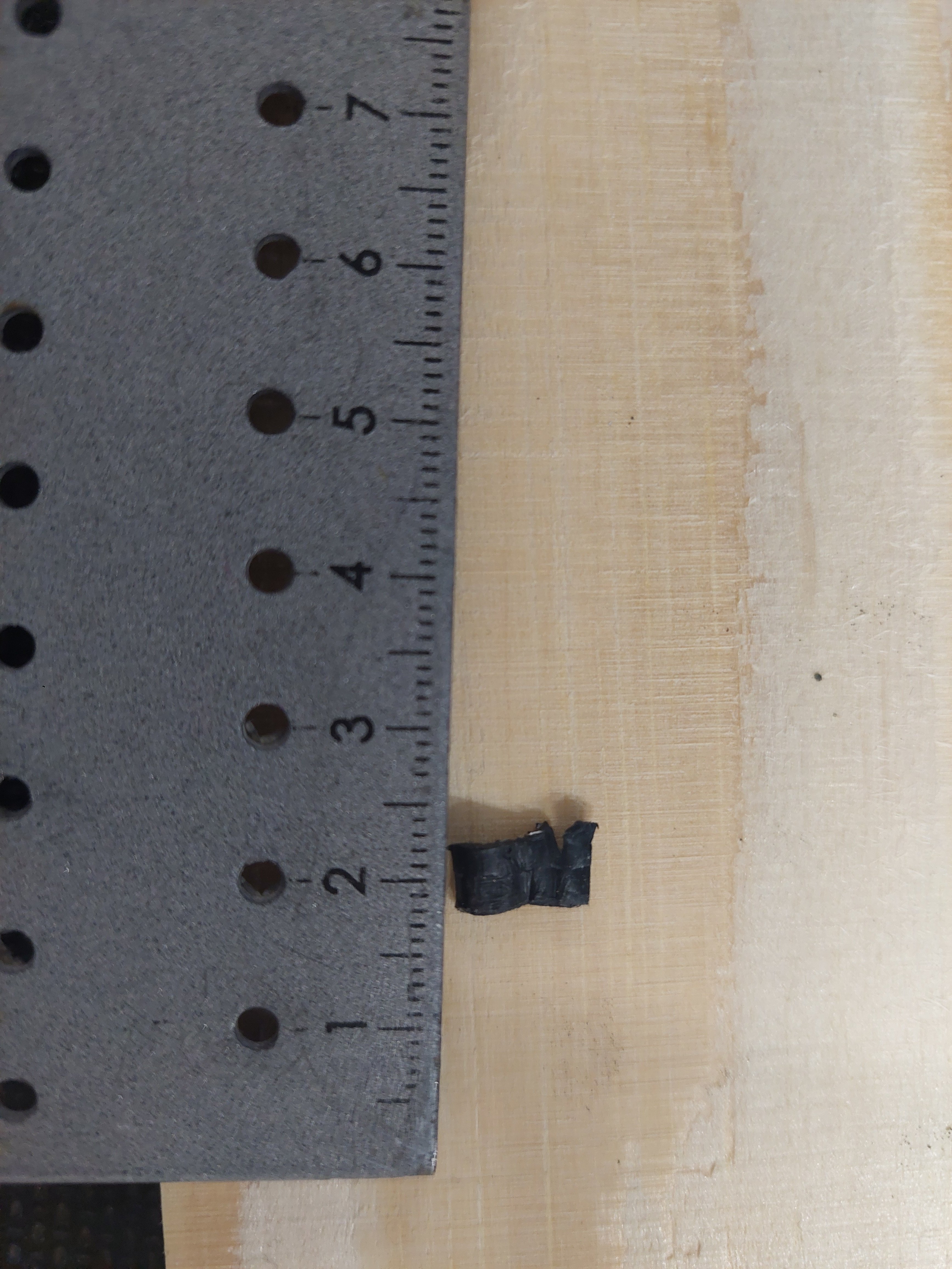

The piece I chopped off: those are centimetres with the numbers, so it's really about 3-4mm

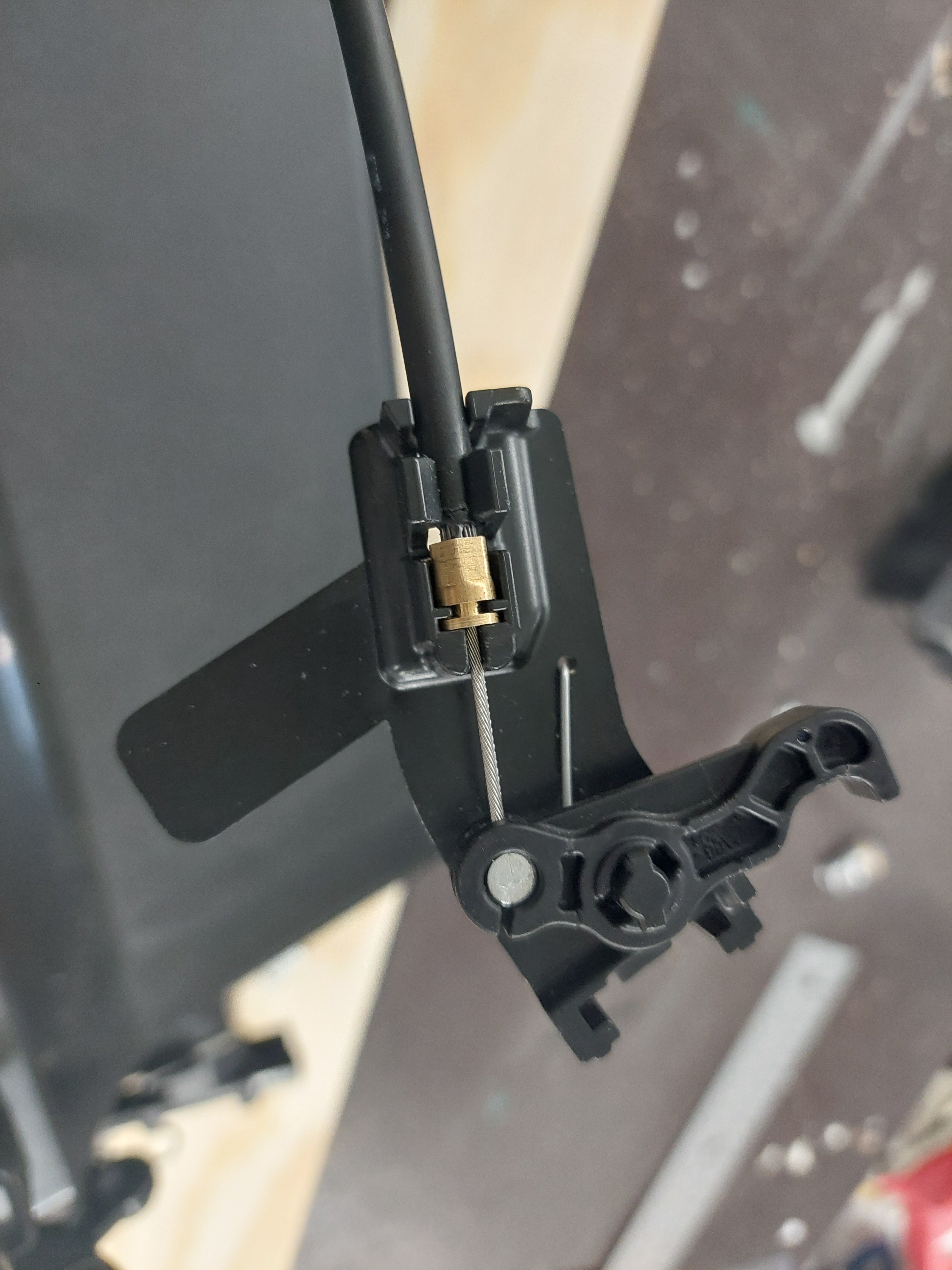

And the last: this is the bit that slides in to the push button on the glovebox. The piece underneath is the one that slides on the button mech, the bar to the right is the piece that gets pushed around.
