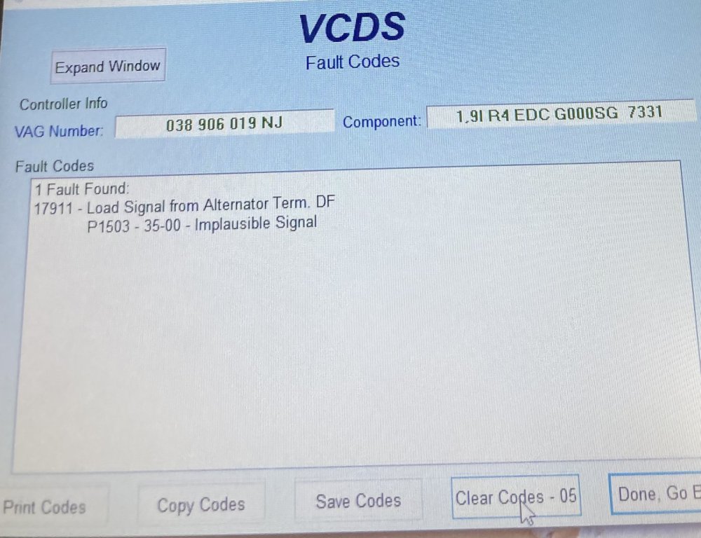

17911 - Load Signal from Alternator Term. DF P1503 - 35-00 - Implausible Signal Component:

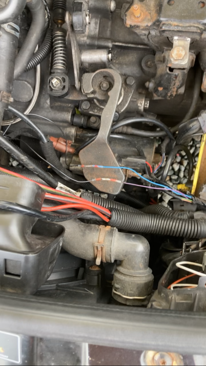

Hello there,

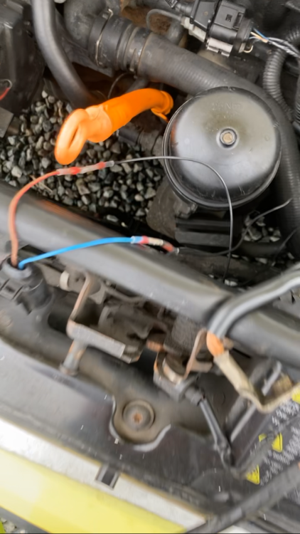

I’ve had this issue on my fabia vrs for a while now. After doing quite some extensive research, everything points to the DFM wire that runs from the alternator to the ECU. I’ve cut back this wire fairly close to the alternator plug, and as far as I could go under the battery tray obviously getting rid of the problematic connector. I’m getting 12.5v on both pins when disconnected from alternator with ignition on (common to get similar voltage at both pins on a diesel), and have also got a battery light on the dashboard with ignition on.
Any help or suggestions would be greatly appreciated :)

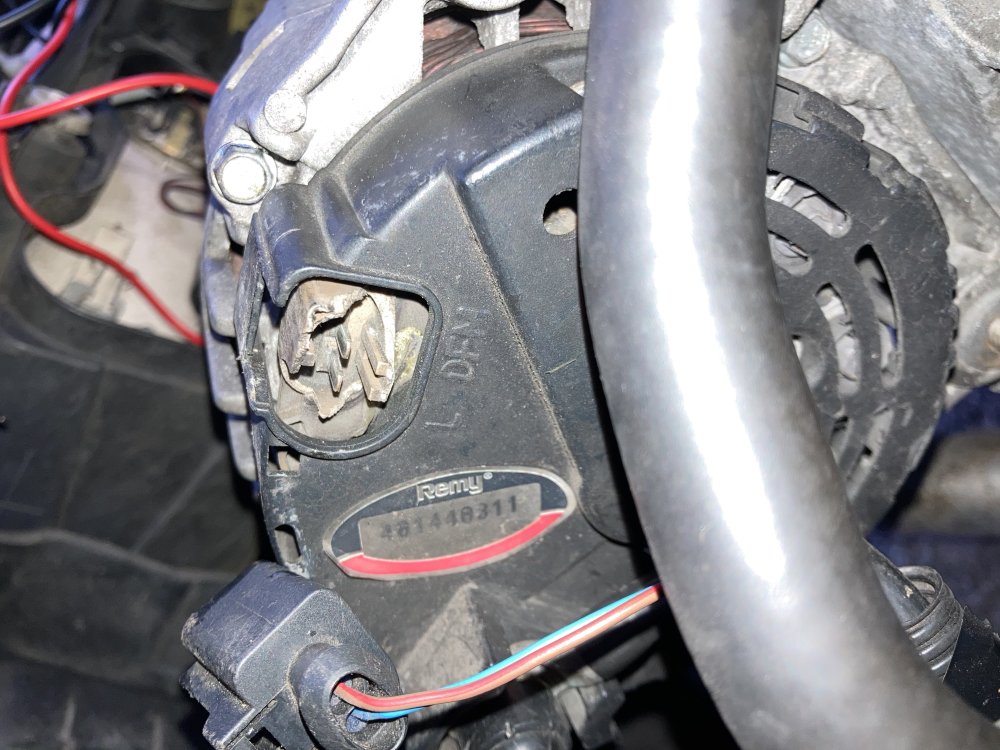

The voltage regulator also has clear signs of damage to the casing, so the connector is held in place with a cable tie currently
  • Sponsor
That photo would make me think it's a connection problem, right there.
Thank you, I’ll definitely try a new voltage regulator then.

Could you maybe solder the wires straight onto those pins coming out of the regulator?
Would spade connectors do? I’ll definitely try that, at least then I’ll have a definite answer that the issue is on the ECU side if it doesn’t end up being successful.
Fitted an alternator that I picked up from a breakers yard, and problem solved! No more traction control light and lumpy idle :) Thank you again.
