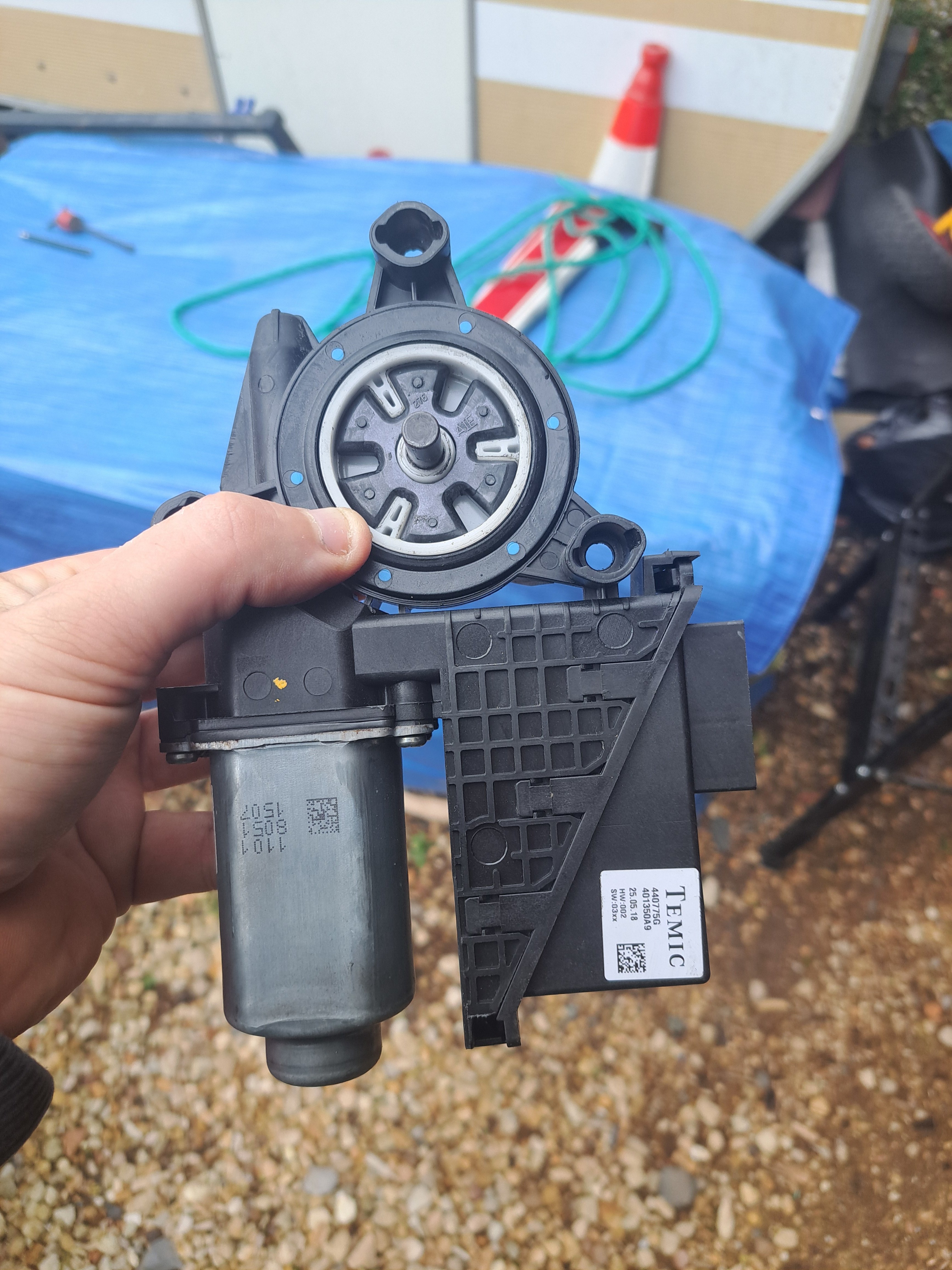

Is this something you can fix. I'm.having the same issue. Checked fuses, door wiring had the car go into an electrical garage but nothing. Attached is the door motor unit I think needs changing

Hi, and yes, should be no problem to repair that.
I'll send you a private message with contact info.
