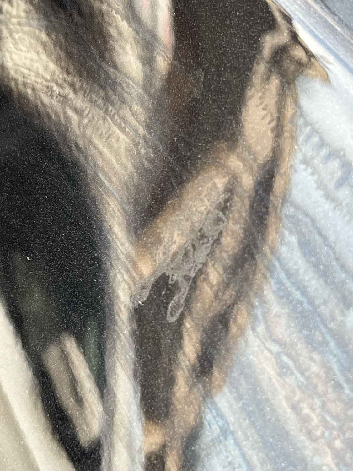

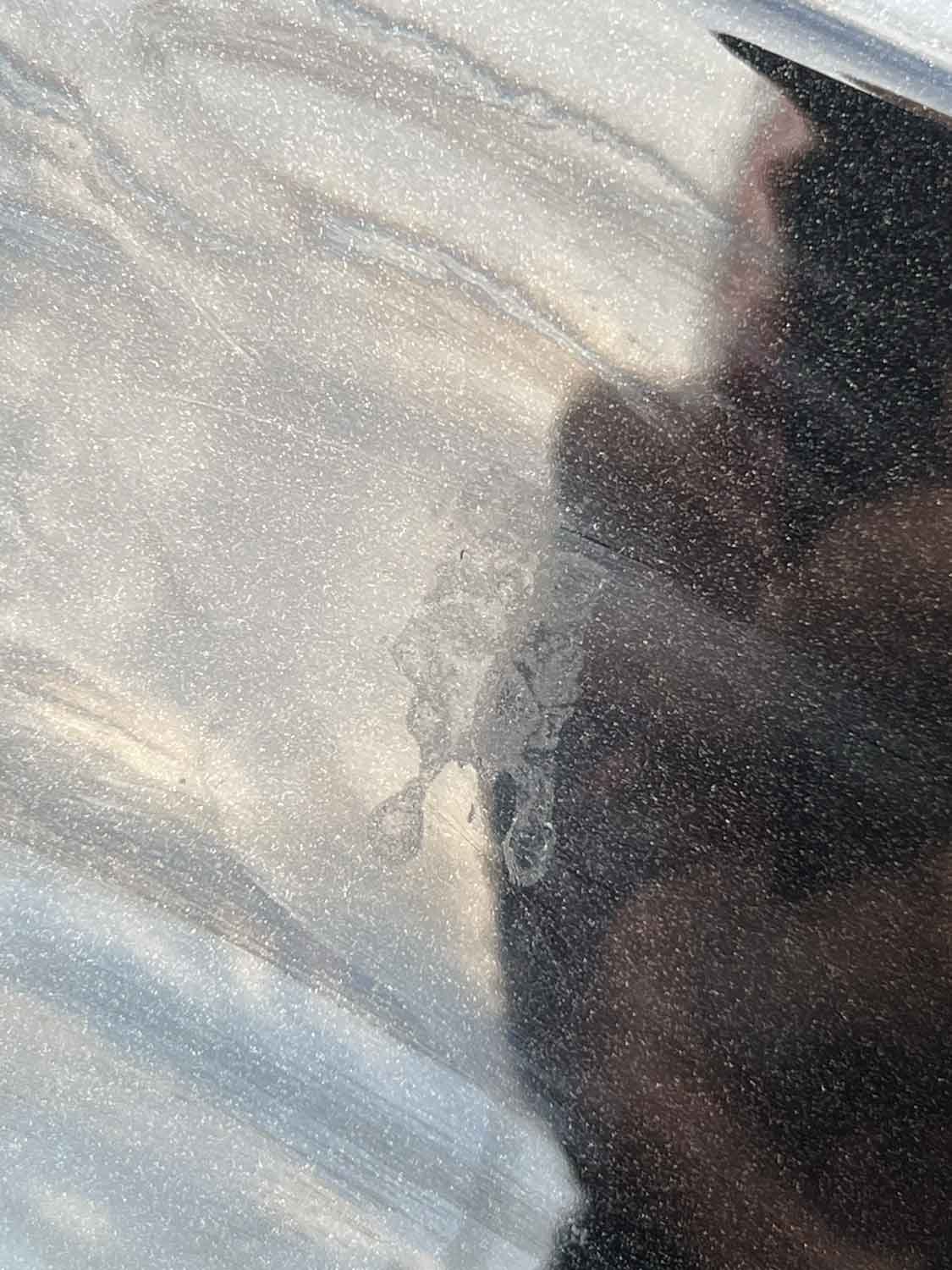

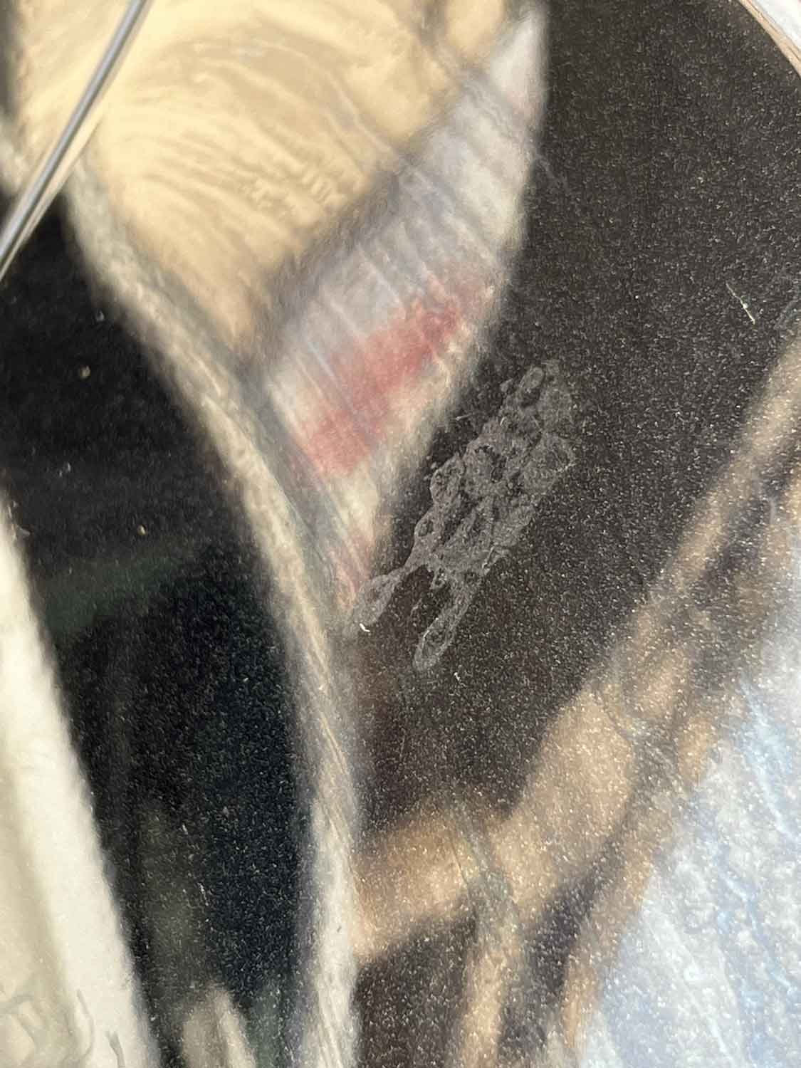

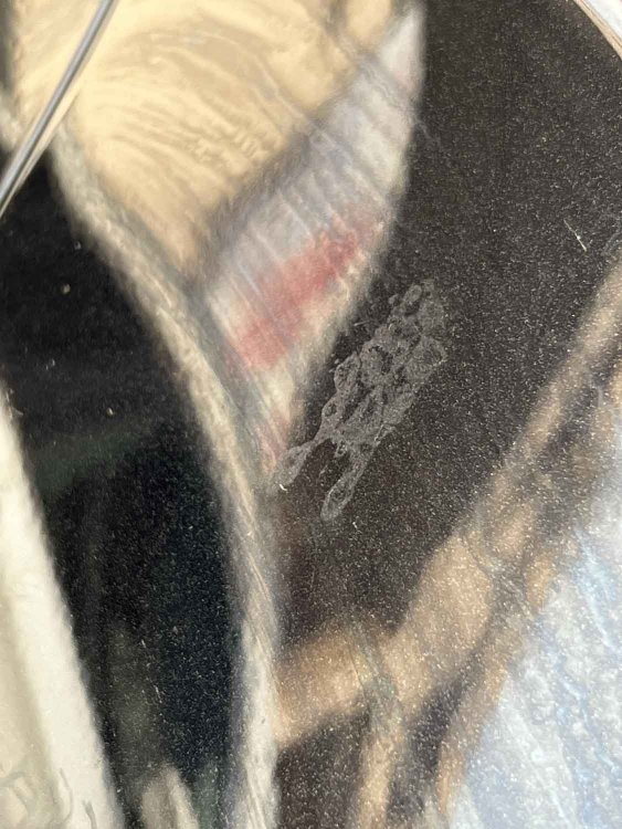

Here are the photos.
Ignore the halos around the stain—they’re just soap residues that I didn’t rinse off properly half an hour ago.
The stain is slightly rough, almost imperceptible. It practically has no thickness. When running a finger over it, you can only feel the transition from smooth (paint) to slightly rough, but there’s no significant thickness, just to be clear.
Looks like bird poo etching, will require some sort of polish to take the clear coat down to the lowest point and buffed then protected with ceramic coat or similar
I am patient with ya just needed more of an idea what the mark was 😁 now it does look like bird muck has etched into the top coat ,which is what i originally thought it may be ,as black is a terrible colour for showing this sort of thing ,so just my opinion of course but that needs properly polishing out ,if you dont feel confident take it to a local detailer or body shop who will mop the whole bonnet  it may need cutting with a fine wet and dry aswell

That marking is effectively a bird bomb that has now gone into the clearcoat.
It’s a couple of reasons, mainly the paint has got hot, the clearcoat softens and the stuff gets absorbed. Depending on how acidic it is, it can eat its way through waxes and into the clearcoat but it’s not some Hydrochloric Acid it’s sometimes made out to be.
If you’ve tried a handful of products, the last one being the main one that would have worked, then you’ll have to remove the contaminated clearcoat with polishing compound and most effectively with a machine polisher. In order to do that properly, you need to make sure the area is cleaned and decontaminated first to stop picking up contaminants with the polishing pad and causing further damage.
If you don’t have experience in doing all of that; then I would advise looking on IDA or PVD for nearby Detailers to deal with it for you.
Removing clearcoat doesn’t require ceramic coating. It’s a hardy and long-lasting paint protection but it’s not tied to paint correction. There should still be plenty of clearcoat left (unless the paint has been polish lots before but a pro will check it with a paint depth gauge first).
A ceramic coating (not a ceramic polish, not a hybrid ceramic wax, not a ceramic topper) will provide the best level of protection (aside from paint protection film) but it’s not bulletproof.
