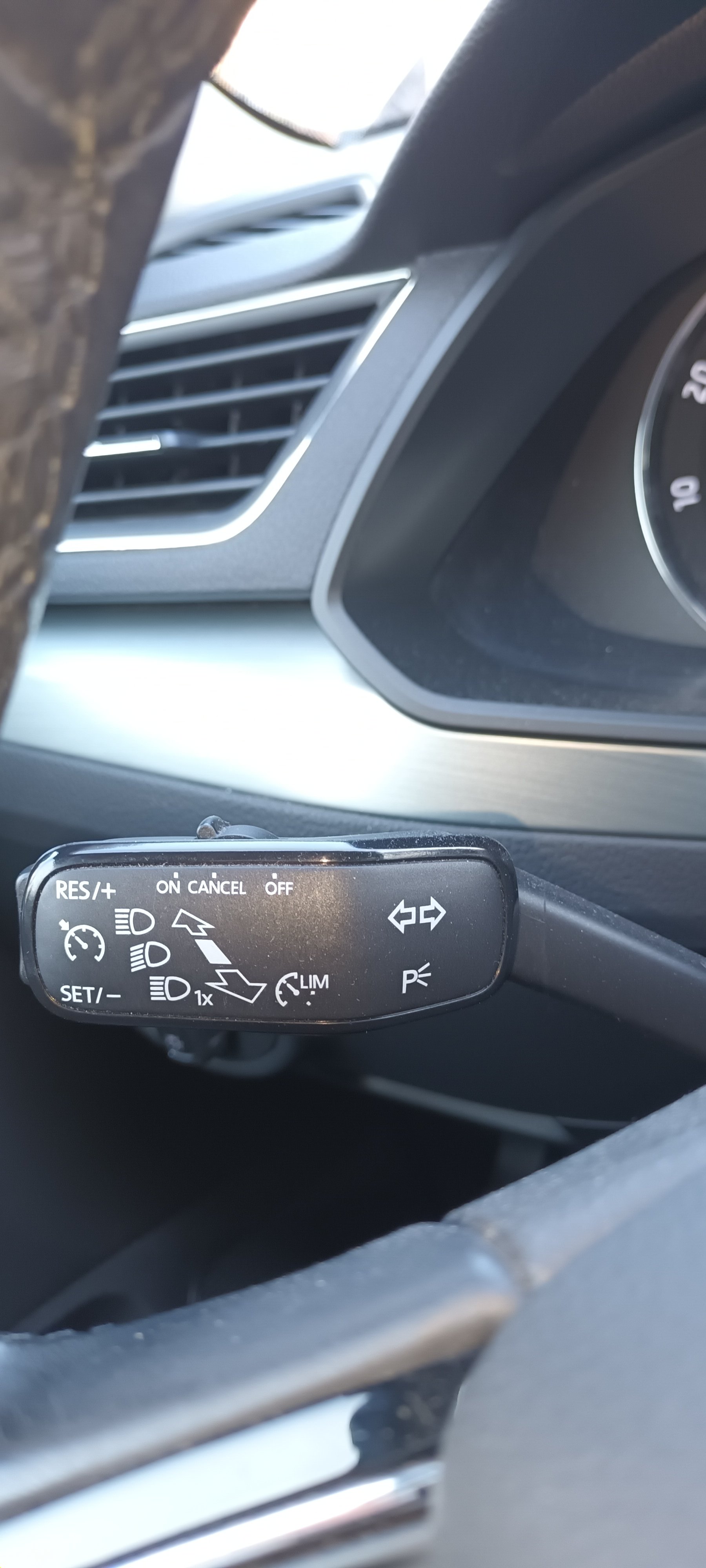

Hi all,
Own SIII 2019 1.5 TSI DADA with Front Assist and standard [non adaptive] cruise control. It doesn't have a front camera. Would like to have ADAPTIVE one. Is it possible with equipment and coding stated below and a lever on the picture? Thanks a lot for all advices [even negative] in advance.
