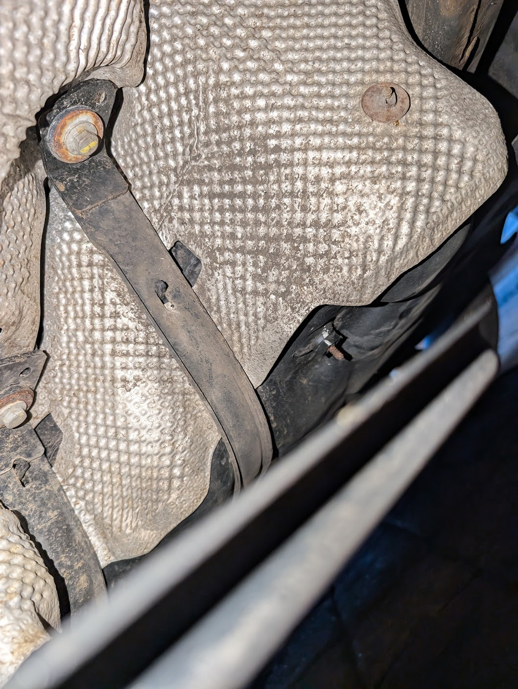

My dad just followed me driving and said something is hanging down at my car's rear left. It seems a piece of the plastic under-tray covering the exhaust has had a fixing fall or rust through.

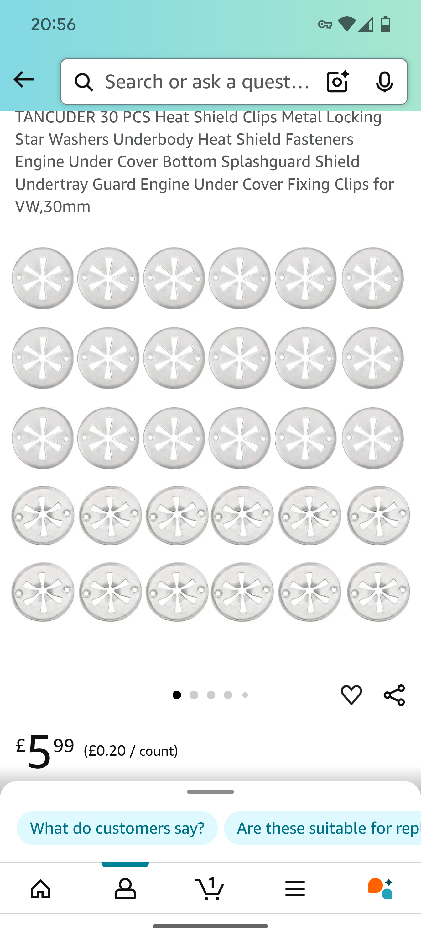

When I push it back up, an existing metal 'screw' is sticking out and goes through a square hole in the under-tray plastic. What fixing do I need to get it back attached? I've just ordered these from Amazon but they may not be the right ones
photo of the underside of the car / bolt / screw sticking out. It does seem to have a square piece still attached to the screw which may or may not need to come off? I'll be doing this squeezing under the car off the kerb.

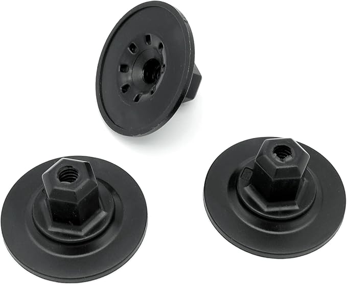

It should b a metal screw that pairs with that.
It slots into the plastic undertray, which then screws onto that.
Pic below is not great, but it gives u an idea of it.
Something like this?
Would these work
looks like it, yes.

Thank you. Amazon have delivered, part fitted, under tray is no longer hanging!
