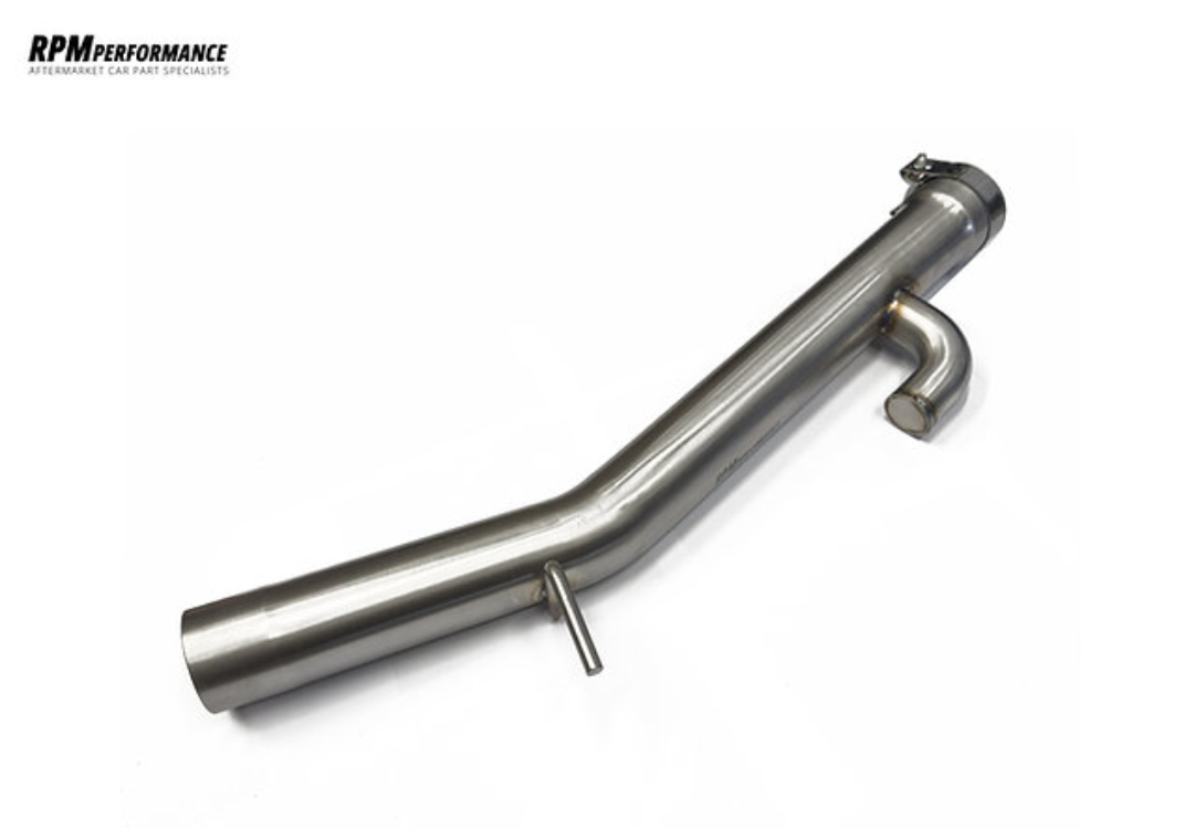

I did a centre resonator delete recently on my 220 petrol Superb - got an RPM Performance Resonator Delete Anti-drone pipe.
It's made for the mk3 Octavia TSi.
Good fit.
Makes a nice little difference, nothing obnoxious, and best bit - no drone at all, even at highway/freeway speeds.

No it won't fit the 272/280 as it has an AWD setup.
It uses a completely different center resonator box and the exhaust pipes routes differently.
I know of a few 280 owners here in Oz who have bought & fitted the RPM Performance Resonator delete pipe that was made for the AWD Cupra/Formentor.
Mine is a mk3 220 FWD, hence why I used the version made for the mk3 Octavia vRS, which is also a FWD setup.
Bit of research and it looks like this is also Golf Mk7 R/Audi S3 8V etc. etc. (ie all top end AWDs).

Cheers pal - yeah I see the anti-drone bit looks like they’ve put more thought into it than the ecs or vagsport ones. Only one confusion:
Golf Mk 7/7.5
Audi S3 8Y
S3 8V
Cupra Formentor
Leon Cupra 300 estate
I’ll have to email them and ask what on earth is different about them aside from the branding. All look the same, all on MQB/MQBevo AWD vehicles. Should be the same part basically and could therefore be used on Skoda AWD like Superb and…Kodiaq? It’s added to the list.

It would b to do with the different lengths of pipes for the different cars.
Even though they're all MQB, they have slight differences.
Guess so, although it can’t be much and that can be adapted easily depending on where the original is cut?
Might see if I can take it to them to offer them up and fit the most appropriate one
