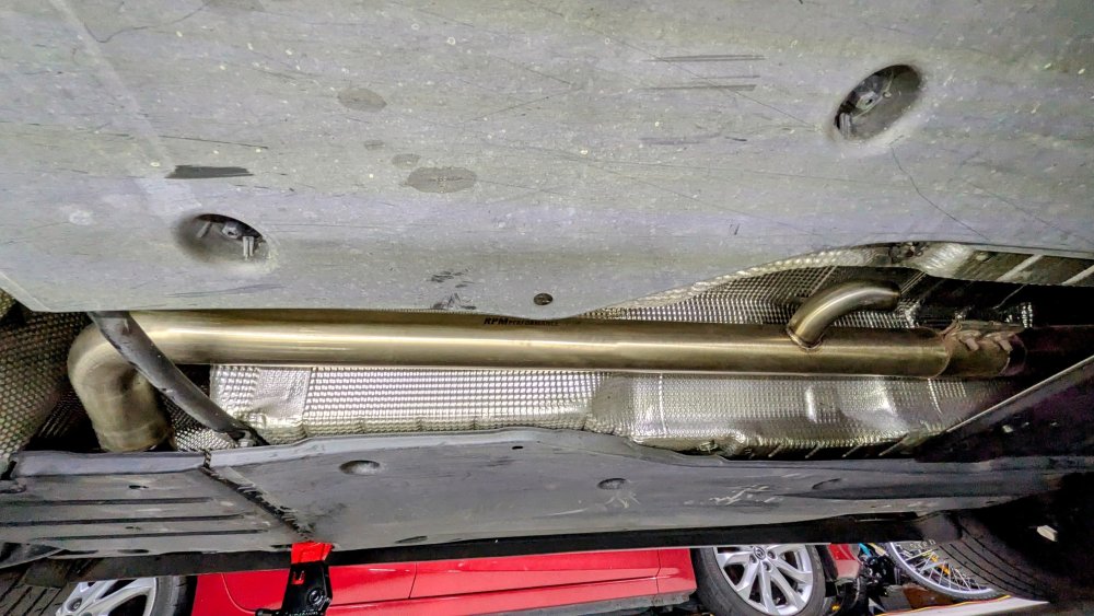

This is mine.....

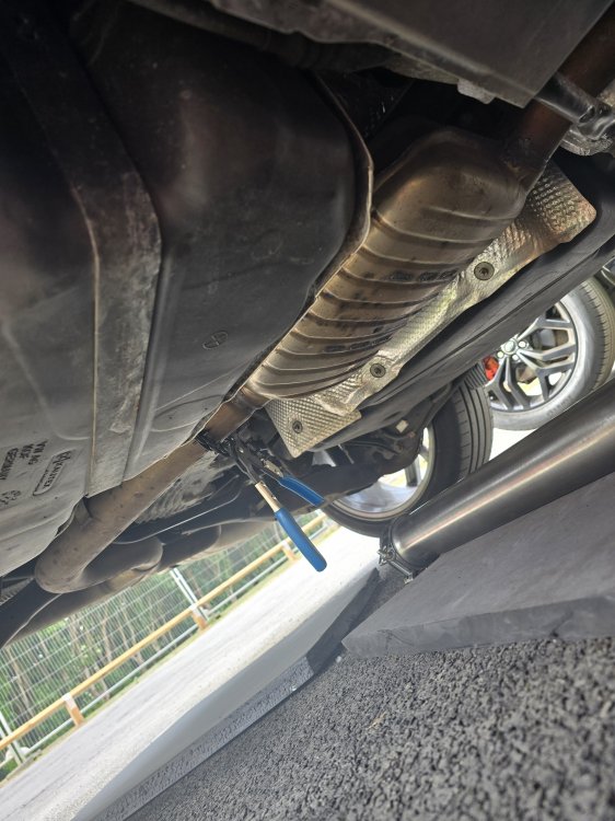

On 16/05/2025 at 17:33, Cactusjack said:
Did you have to cut behind the clamp forward of the resonator and use an additional clamp?
I've just mocked mine up (Cupra Formentor pipe) and it sits some way behind the natural break with the hangar in the correct position. Guessing OEM has a bit of extra length due to the size of the car compared to the smaller hatch's...

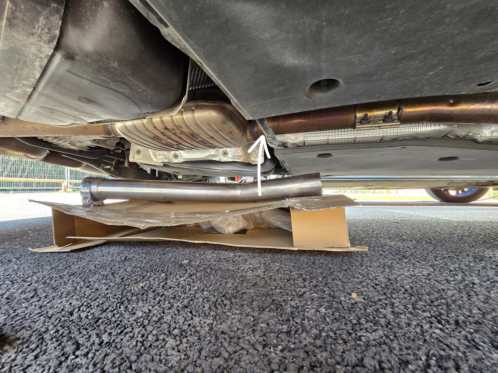

Just checking this pic. That looks like it will fit lengthwise right?
Edited by travs
Yes it will fit, just the natural break forward of the box is a bit further forward here so you have to make 2 cuts rather than 1, then rejoin it behind the existing clamp on the right of the pic.

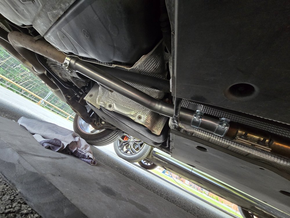

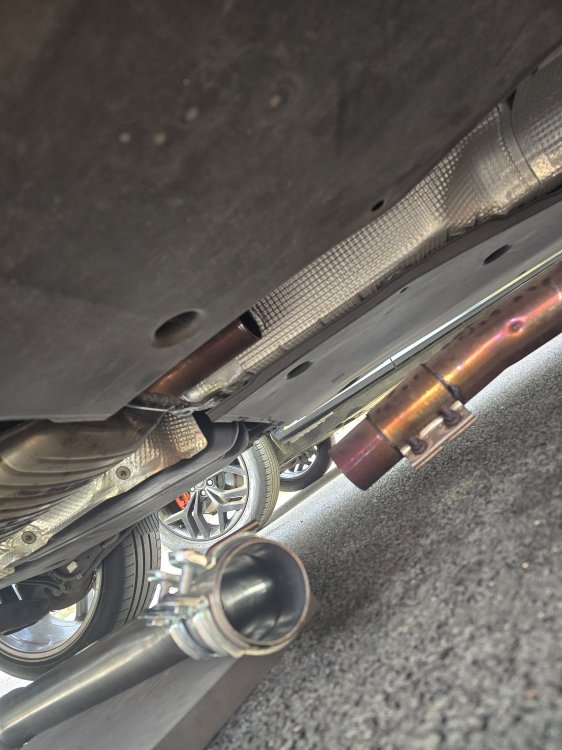

Done it... 2nd cut was an absolute pig, cheap exhaust cutter blunted really quick!
Fits well, sounds a little better at idle,with a bit more burble under load. Will do a proper listen tomorrow on the way to work.
