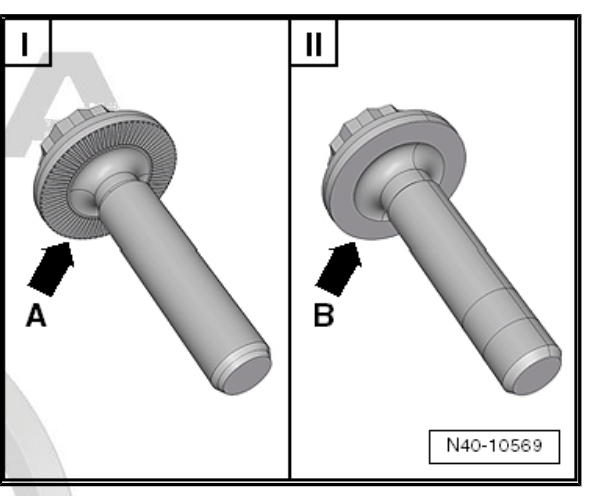

Hi sorry posted yesterday but no replies. Need the torque and angle tightnening  for front hub to drive shaft bolt. Its 12 sided. Car is up on stands and need it for today as we are away tonight. Had to do bearing yesterday  as it got really bad over a couple of days.  Its a 12 plate estate 1.6tdi Wife not going to be happy if I don't get it back together.
Have found 70nm plus 90degrees but confused re different bolts in Haynes

Serrated on underside of head (A), or smooth (B)?
Not sure will be back in a minute
  • Sponsor
With serration is 70Nm plus 90°
Without is 200Nm plus 180° !
Note: "Vehicle must not be standing on its wheels for tightening the screw"

Thanks so much Pete. Couldn't work out what serated meant but I get it now. 70nm plus 90degrees is what I need
Didn't think it felt like 200nm plus 180 when I removed old one although it took a 6ft pipe to move it at first.
200nm plus 180 is really tight.
