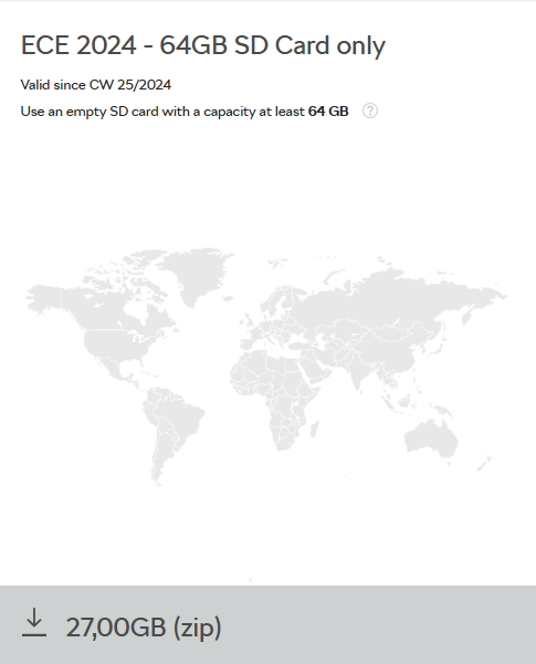

This is the download option presented to me:
I've downloaded this zip file - it's called HIGH12f_P350_EU_202345.zip - and have extracted it to the root of a SD card. This is the file structure:

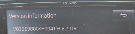

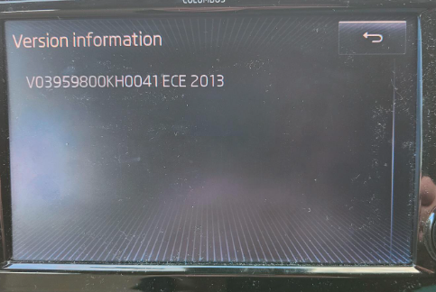

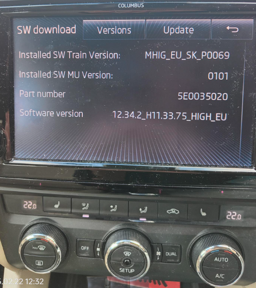

For info, this is the current software version on my car:

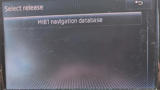

and this this is the update option I get when I insert the SD card in the car:

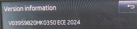

Thanks for your help with this. I continued the update today, and it picked up where it stopped yesterday. I kept the car running while I was doing it.
It appears to have completed ok and the map version has changed to 2024 - previously it was 2013).
Old version:

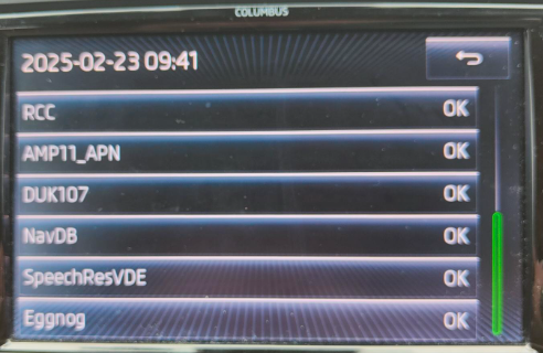

New version:
and everything has status 'Ok'
