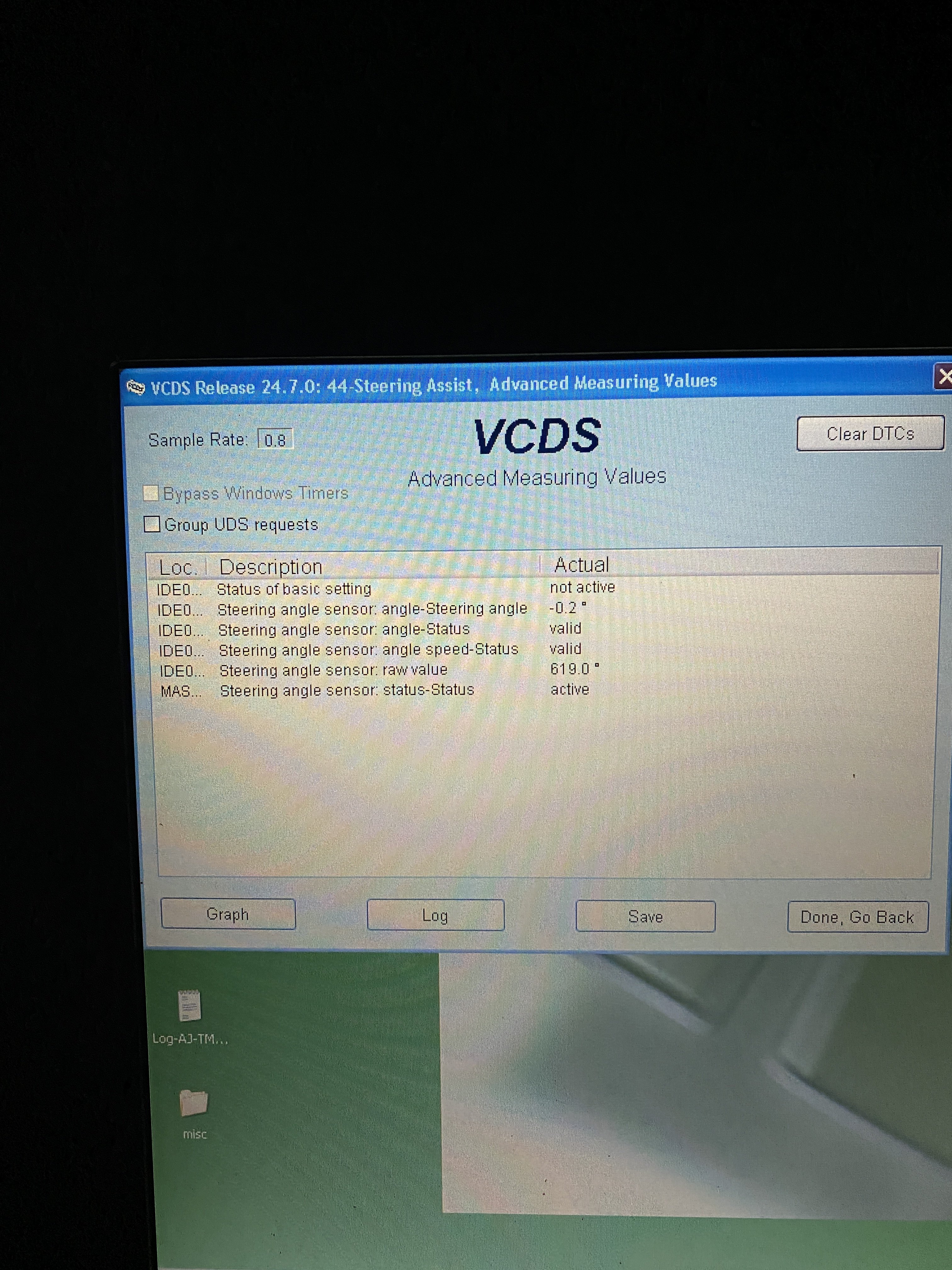

On this occasion the steering required VCDS resetting unsure if moving the rack & wheels while stationary for the replacement inner tie rods or a mischievous mechanic has done something to clear the codes
When i looked at VCDS the steering assist was set to Unknown instead of auto comfort or dynamic
Possibly the other values where stored in-correct while setting the SA manually

Status of Basic setting - not active ???
