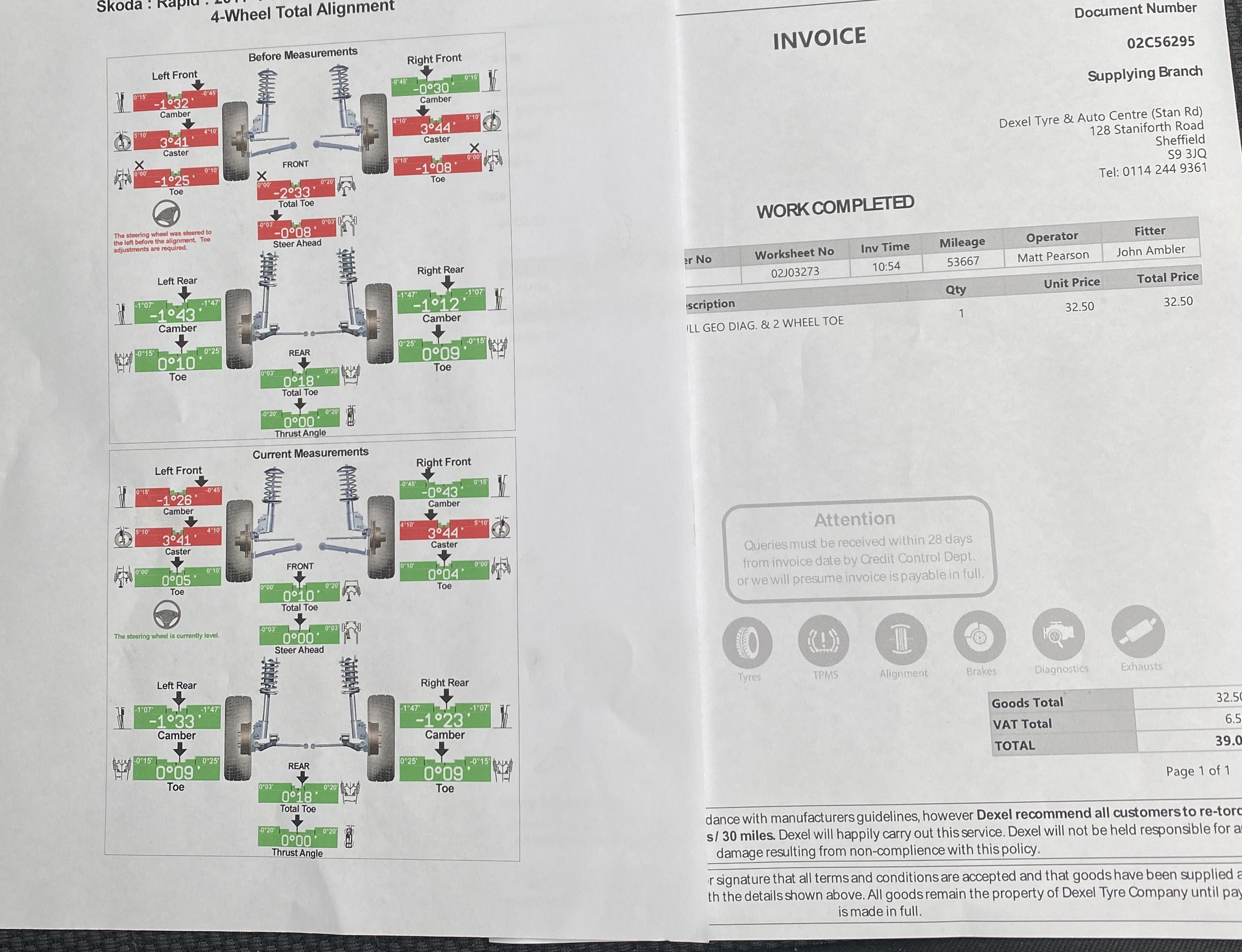

had it hunter aligned still super heavy steering

the camber is out on the hunter alignment
i’ve just found a different better alignment garage to visit for another tracking that will adjust

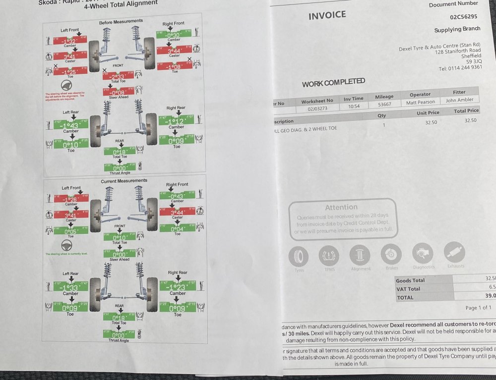

Surely this alignment should be all green regarding caster & camber even tho its not adjustable?
Does anyone have a recent printout to compare?

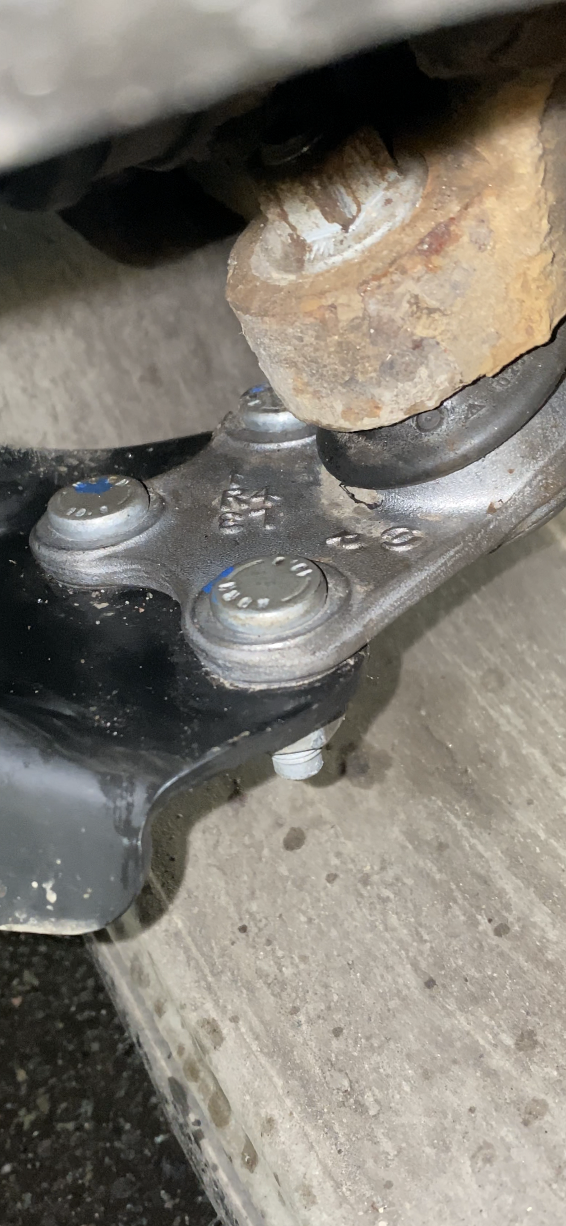

The caster is odd though, any chance the ball joints are handed, and fitted to the wrong sides?

i’ll take another look but taking an acrobatic approach last night for a photo seemed they have arrows indicating they are correctly installed

Yeah, they probably don't fit the hole pattern if they're on the wrong sides, But worth a quick double-check, I think.
  • Sponsor
This suggests maybe it is possible to misfit. This is a left one,

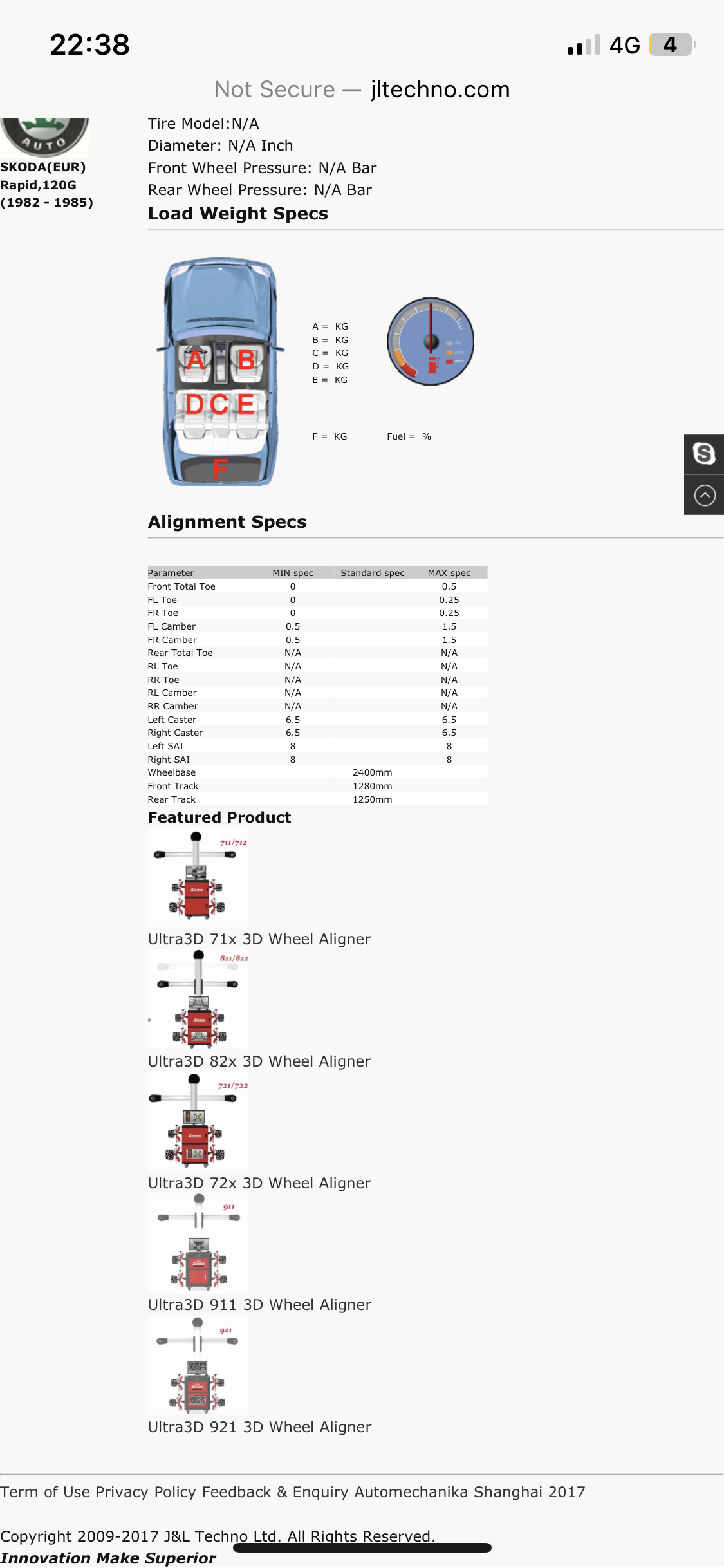

Does anyone know what the correct castor setting should be?

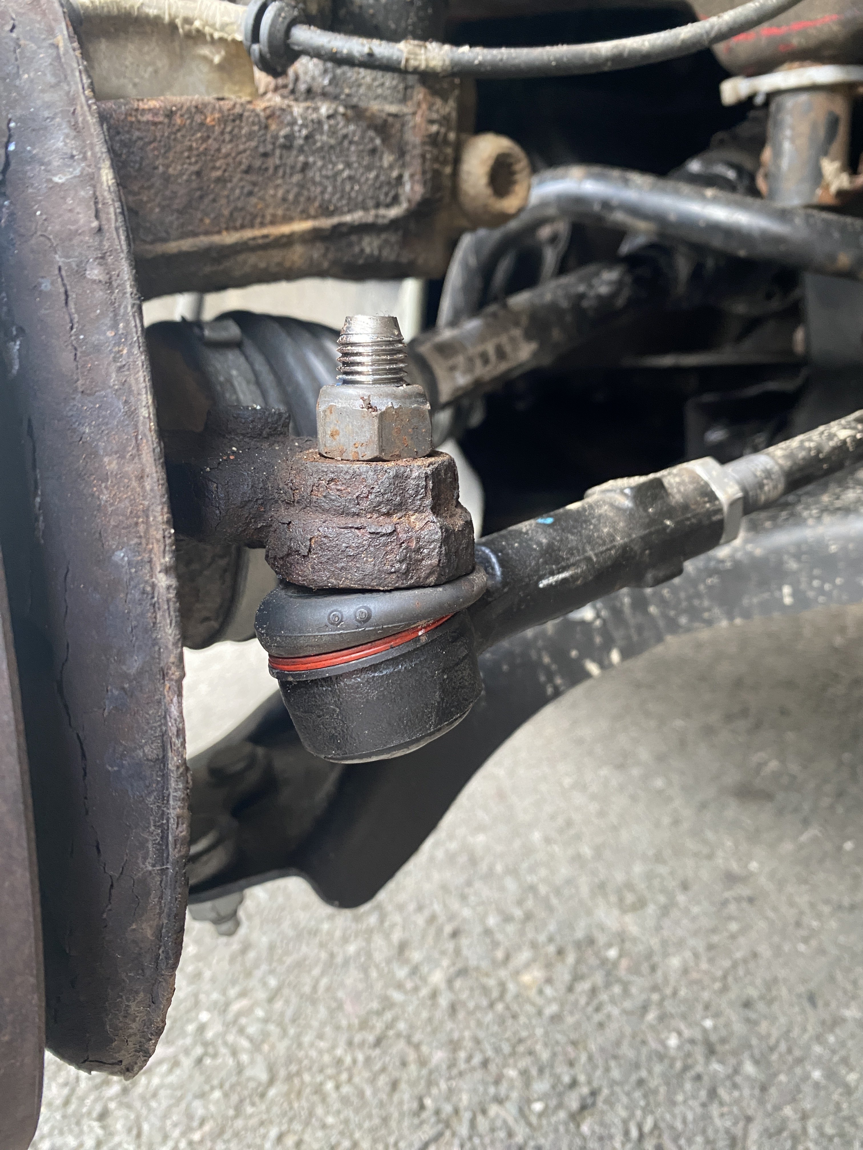

Not sure because just yesterday you quoted me but then showed a photo of the track rod end, not the lower arm balljoint?
Did you change these:
or not?
28 minutes ago, Breezy_Pete said:
Did I understand correctly that you have changed the lower arm balljoints? That's what I understood from your statement below
or not?

And have you checked that they are on the correct sides of the car, since I posted that photo showing how it looks like they might be possible to fit on the wrong sides?
A photo from below with a phone camera at arms length might be enough to see.

Off-side ball joint if you squint really close the arrow points in the correct direction

I found this regarding toe/caster/camber values
