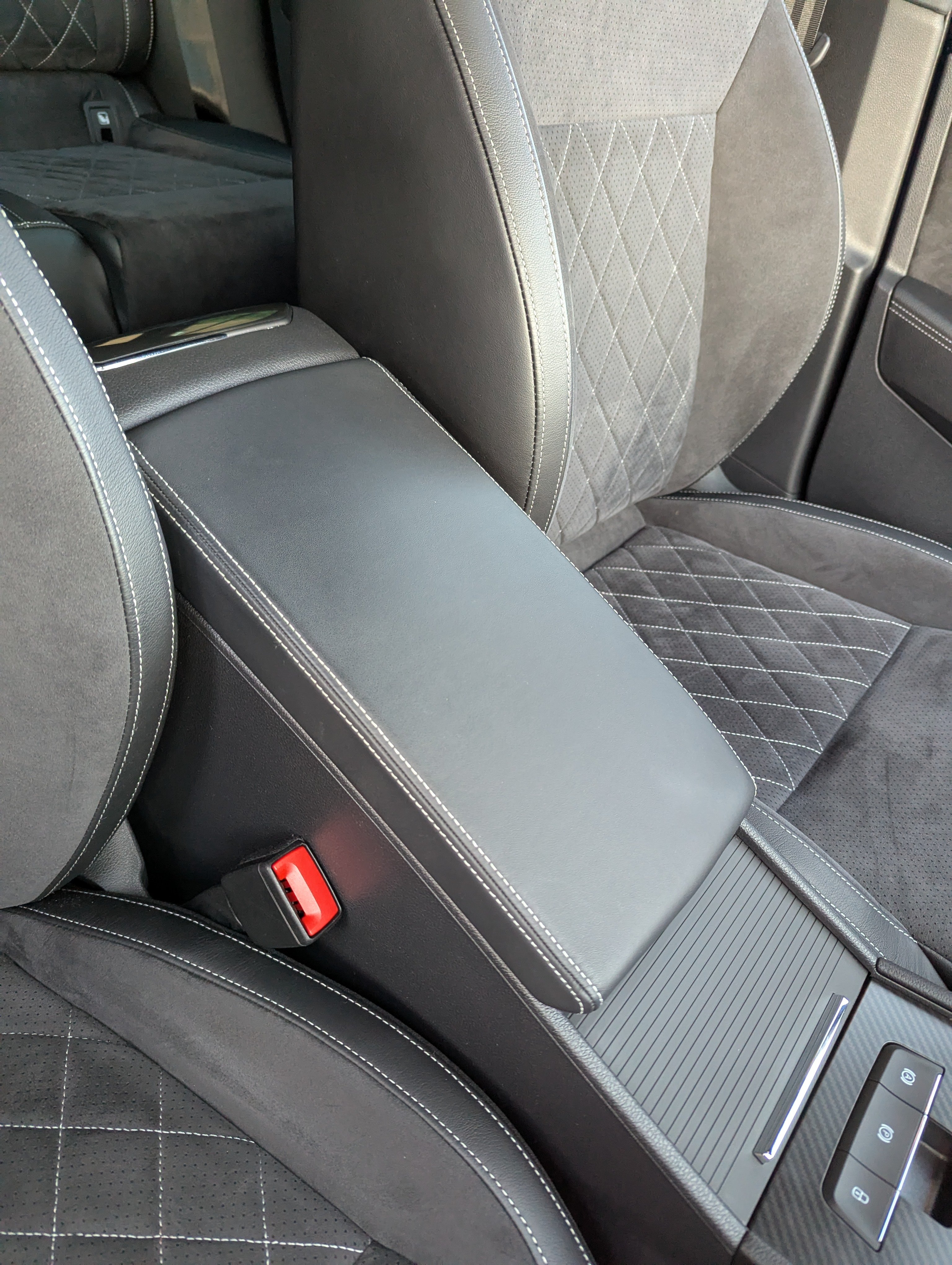

Alcantara sports seats, are the sides leather?
I have a Sport Version with Alcantara seats, but I don't know how to clean the sides/headrest sections since they look like either leather or synthetic leather. Similarly the cover to the middle console looks like leather, but I'm not sure if it is.
Presumably if these sections are leather it is worth treating them from time to time with a larger cleaner? Any advice on this is welcome.

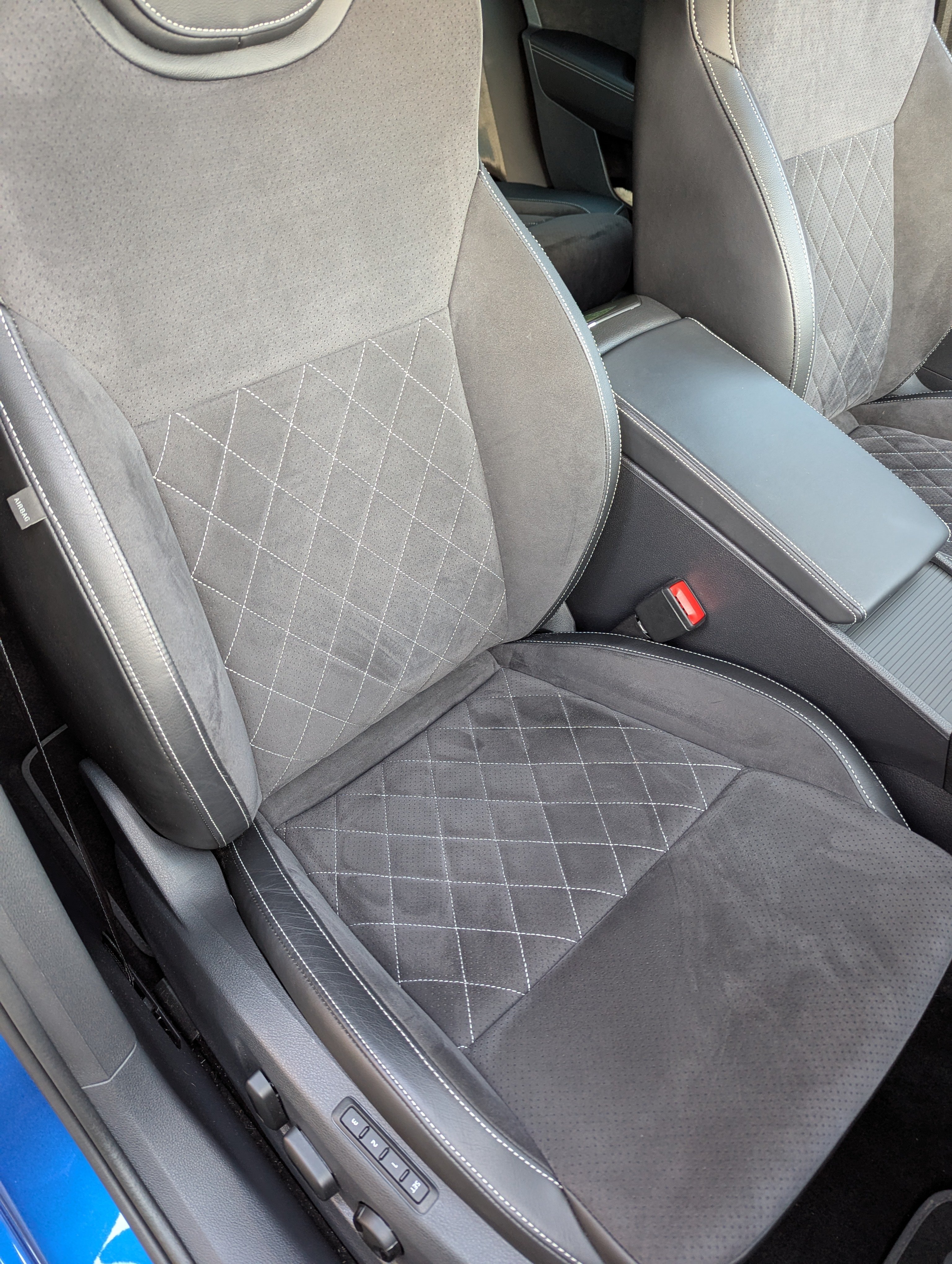

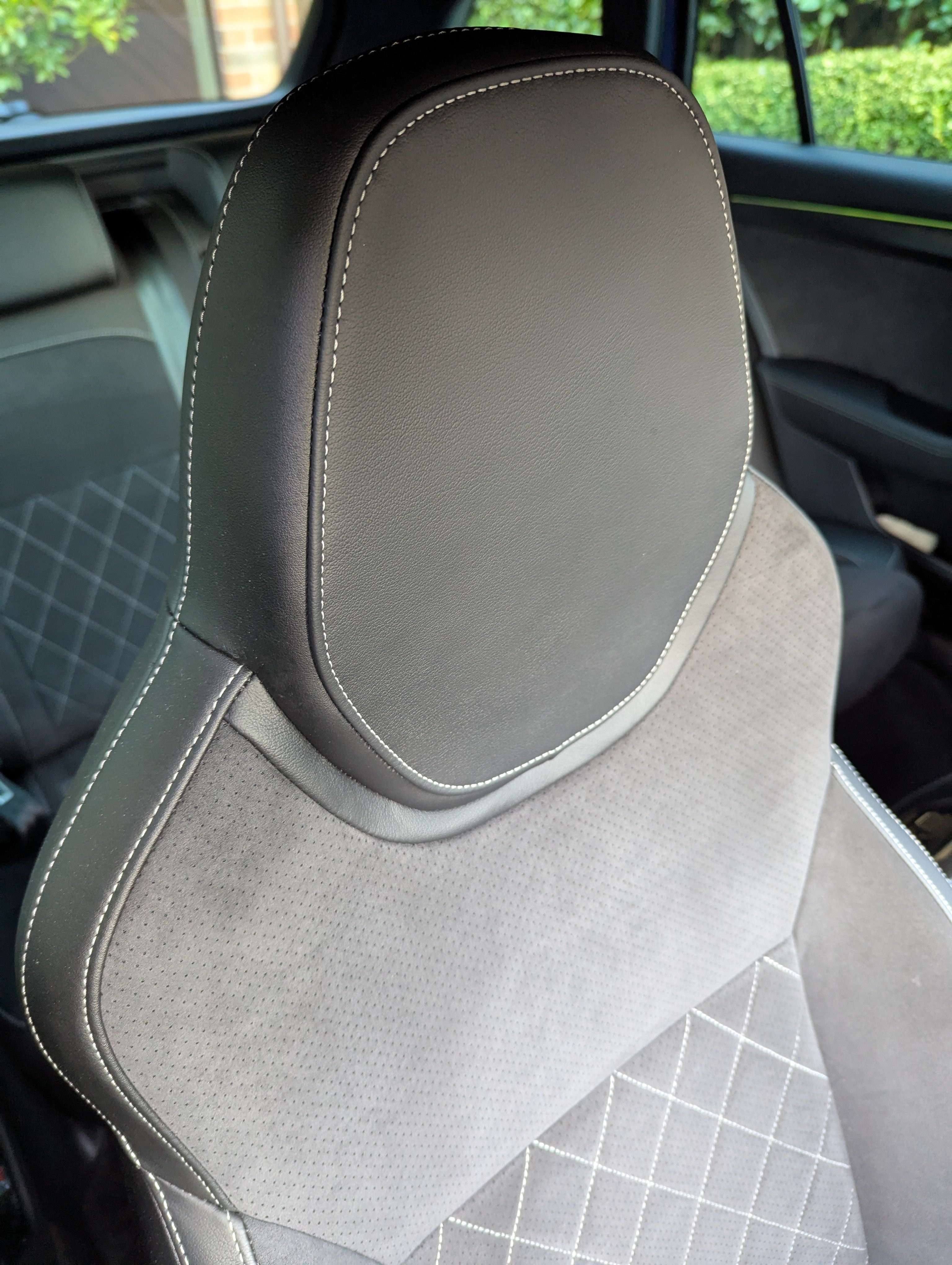

Looking at your pictures, the thin strip around the seats will be leather, headrest, strip under the headrest and the armrest.
