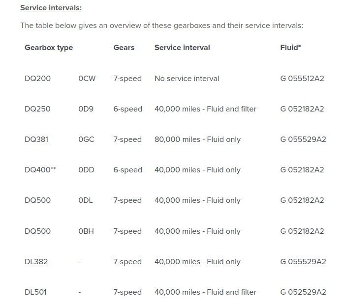

TVS Engineering DQ380 / DQ381 DSG (0DE / 0GC) general info - https://tvsengineering.com/en/dsg-gearbox/dq380-dq381/

If you have a VAQ (Front diff) Servicing on Mk3,s is @ 3 years / 30,000 miles. Some say 20,000 if car tracked etc....
Mk4,s Main Dealers if they bother telling you might now say they are @ 20,000 miles / 2 YEARS.
They need doing...Properly.

585848287_Screenshot2022-12-2814_19_08.jpg.a622554865cd35b0aa0635744f07aef0.jpg.10683be14f7ddf7785066f2b79647582.jpg.eb91574b580b0acdf9bc903e2a5e61a3.jpg.ca2ec73ea5a51a2981e706f38a534cbf.jpg
1834448921_Screenshot2021-09-26at15_11_38.jpg.9096289fe25276182dcd7ffd2631377b.jpg.372fc328a1312e2a8e37a703a5c24a3f.jpg.e5c19f7392af7e2404069076b4a3daed.jpg.3438d86c1009673b8b5ec8c310879d69.jpg
