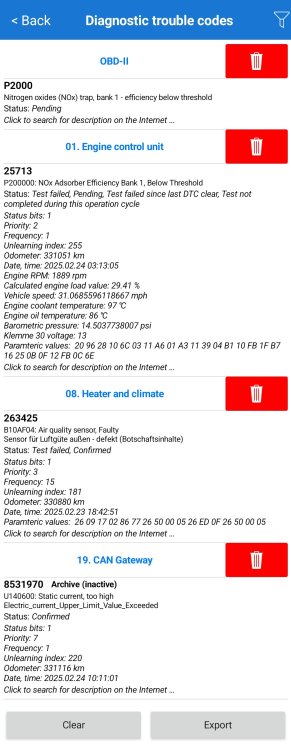

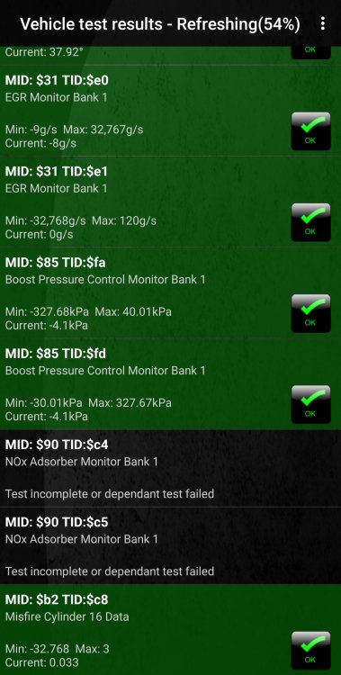

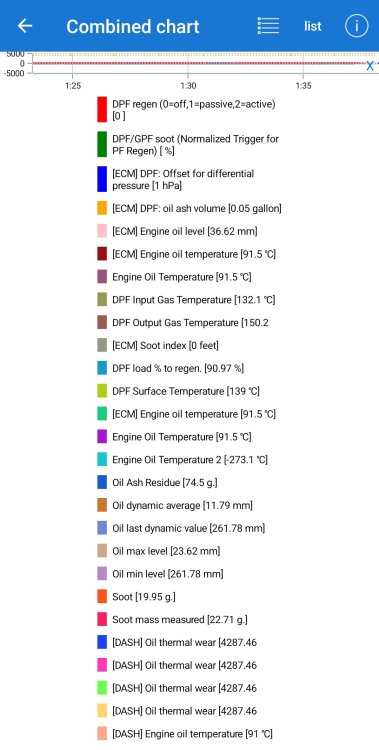

Hi guys so iv hd this comeup showing low threshold on the nox sensor now mines a 2016 crlb engine skoda superb mk3 with no adblue but with dpf I'm having high oil and fuel consumption and constant regens for the dpf im wondering if anyone can shed any light on this I will attach the most recent values and the codes I had done up Screenshot_20250306_000100_Torque.jpgScreenshot_20250225_040245.jpg
