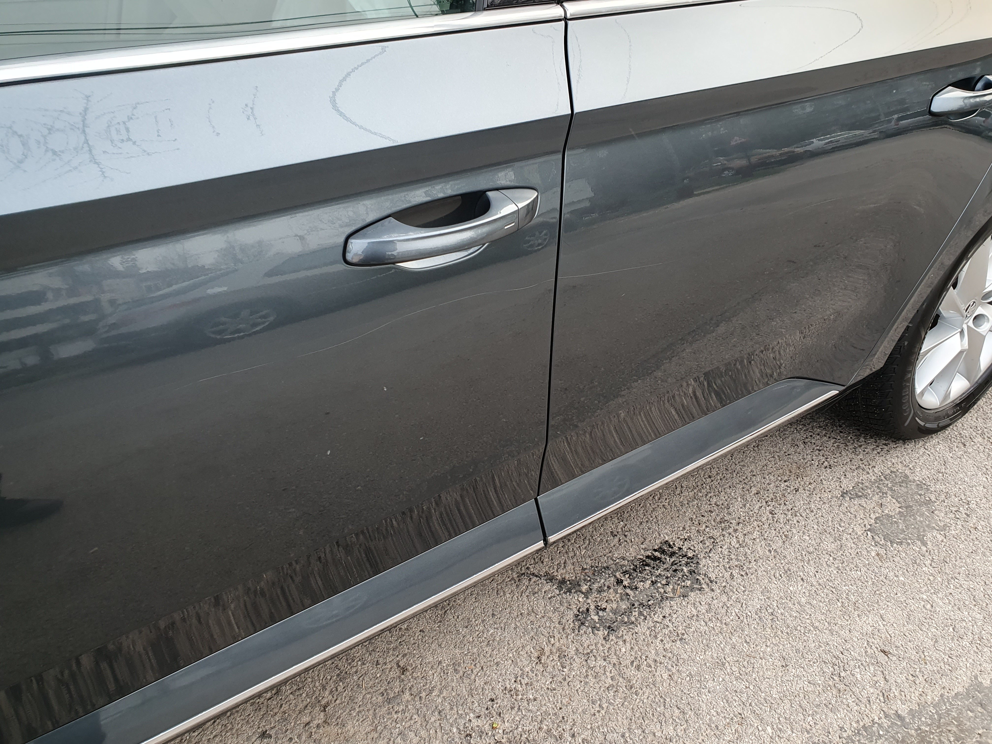

I gave this week the Superb to my guy, to give it a long needed clean up of the interior. I have materials and tools to do it, but is like 5 degress and is not the moment ...
I go pick it up and we are discussing the next steps for bodywork, which I mentioned I will hold to do anything, as I have a door scratched and a side keyed over and I am arranging with the insurance for paint, and he claims "this? this I can buff it out! do not bother with paintshop, you know well ...."
I expressed disbelief, so he pulled out one of his Makitas and says "I will pass only one type on this section to show you"
I wil make it short ... I need to talk to my insurance guy to rediscuss the need to repaint the sides, which is not a need any longer!
The less my car(s) see the workshop, the better I do feel.
Then people talk about how useless is to polishing up a car ...
Hope is can be seen the "buffed out" section, towards the right side of the photo, rear door

Can def see where it disappears; that might be where it hasn't gone down to the primer, which means just the clearcoat can be polished to flat. Even where there are deeper scratches that go through the colour, you can still soften the edges of the scratch to minimise the light deflection and reduce how obvious it looks.
Thanks!
I will show again how it looks once the entire car gets treated.
