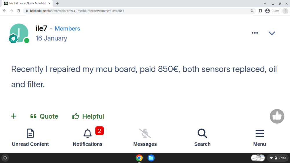

I see you have had problems / faults, so there is likely why now GRINDING>
Edited by Ootohere
Yes had common mechatronic problem with K2 sensor, but that should not be related to grind nose for 1sec in certain situation imo since 1 sec noise been present before mcu repair
