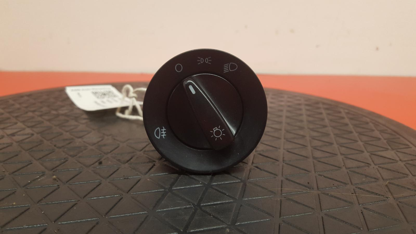

Light switch on the dash?
Thanks. AG Falco
Thanks. AG Falco
Yes it does.

Sorry. I mean is it the light switch that is NOT working?
Thanks. AG Falco

@klang180 @AGFalco @Murdockman - Ok, having the full description, the issue is basically dirty dip beam contacts on the dip switch, nothing to do with the headlight switch. You might be able to cure it with Servisal (sp) or similar contact cleaner, or it might need a new dip switch (probably special order from Czeckia).
