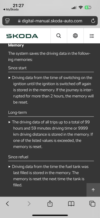

What about this bit at the bottom?
I know what you mean with this, but I'm on about the trip milage at the bottom of the display you can reset yourself.
Ah ok - sorry! 😬
Switch to driving data view - then the trip selection and you can reset the trip by pressing the rh steering wheel button (the screen says press 'OK' to reset)
