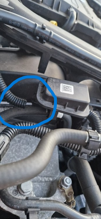

Hi all hope you can help recently bought a fabia estate mk3 monte carlo had a safety inspection done and was told the purge valve had a broken hose but that it wouldn't be a major issue and would be fine to use until repaired. Since then upon start it idles between 1500-2000 for about 30 secs then drops to 800-1000 and today the emission light came on I opened the bonnet to see what I could and discovered this I've tried to identify the part but can't don't think it's the purge valve, looks like it should be a straight replacement but not sure where or what part I need to order.

Unfortunately, no help from our 2018 110PS - for confirmation, assuming yours is a RHD vehicle - is this component in the vicinity of the offside engine mount?
You are making a couple of assumptions, that your EPC light has come on because of an earlier reported broken hose on a purge valve and that the hose you have identified is said item.
The latter is probably correct, the former in doubt, the first thing you should do is have the fault codes read.
Thanks for the help took it back to showroom they replaced purge valve cleared fault and no more faults showing, but still idles high for 30 secs.
High idle for short period after start is normal - appears to be much more noticeable on the 1.0TSI than on my 1.4.
