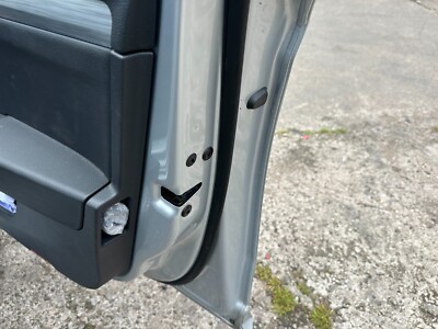

Could it be the old broken cables in the door jam connectors.
Mine has been doing similar last few days :( I looked at the wires in the loom next to the hinge but couldn't find any breaks.
Wondering if it could be the lock mechanism instead? I got a "no communication with lock mechanism" or similar fault code. This would make me think of a broken wire more than a faulty lock but I am open to opinions...
