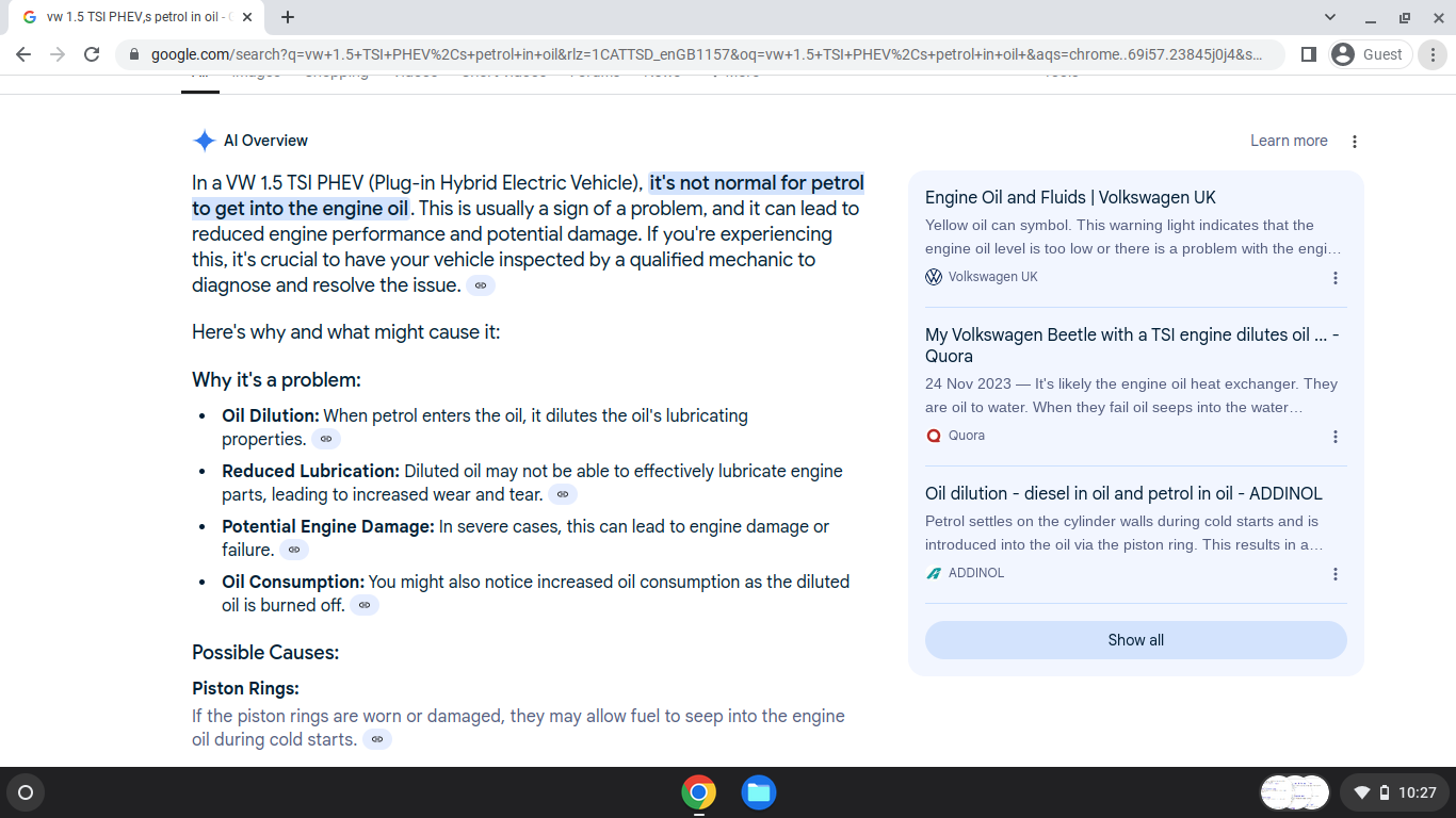

AI can turn out any old rubbish obviously. Where it finds the info off the net is anyone's guess.
Edited by Ootohere

51 minutes ago, Ootohere said:
@JackP Is that no reported issues with 1.5 TSI iV / PHEV engines being run mostly on electricity?
No over fuelling?
Why are they saying replace the fuel pump?
THEY SURELY KNOW OF AN OIL SENSOR ISSUE.
Are you a VW / Skoda Tech or working in a VW Group Dealership?
