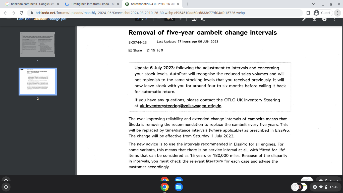

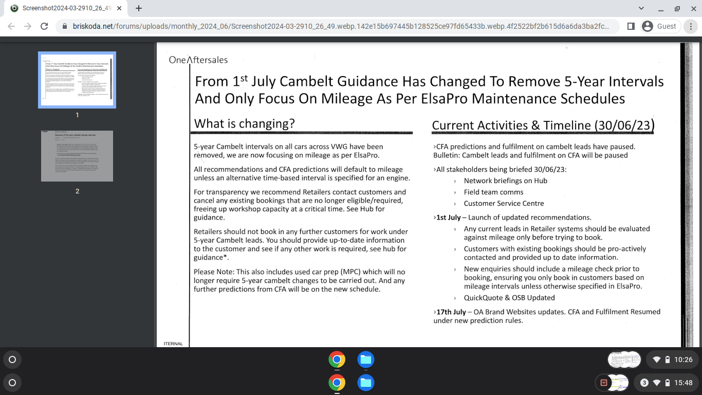

Hello, I'm sure its every 5 years, have a search on the forum there are several service flyers from Skoda quoted. 🙂
If you can afford it, I'd do it every 5 years still, regardless of VWG's modified recommendations.

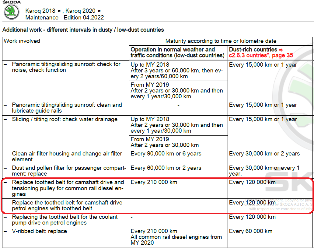

The 5 years / 50,000 miles was unique to the UK and was a Skoda / VW Moneymaker.
The UK was and is counted as a 'LOW DUST COUNTRY' and that was the actual regime that should have been recommended or advice, pre June 2023 when the new guidance came in.
(Because people with a 1.5 TSI ACT were not paying the £850-£1,200 being asked and were trading in cars instead then Dealerships would need to do them, maybe not taking 6.5 hours, but still not cheap if the car was to be serviced to the manufacturers.
All of a sudden what went before changed.
