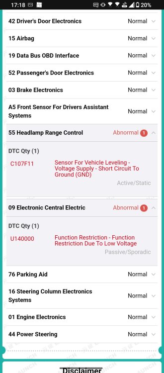

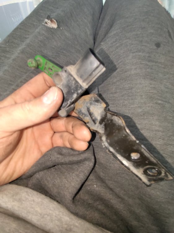

Hi guys got this error code using launch pro diagnostic machine , I have a Octavia vRS MK3 2014 only has 2 leveling sensors both in passenger side , I looked at the front passenger and seen the green leveling arm twisted could this be the reason why it throwing up the headlight range code , I do have the part but not sure if it should be coded in or not
I would say it's not helping. The car is also complaining about low voltage so suspect you might also have a failing battery.
Worth changing leveling arm and battery ? I don't think my green arm should be twisted or bent though
My battery is running at 14.5vlts to 15vlts when I have the diagnostic machine reading the battery when cars running
Edited by Holderness88

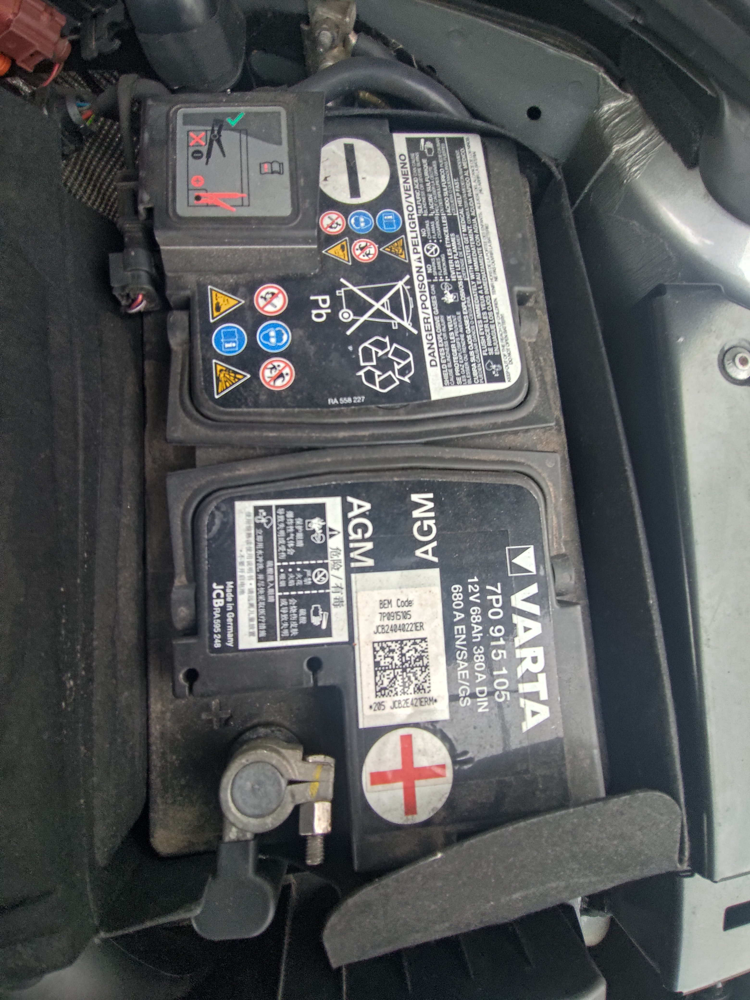

Yeah it's stop start this is my battery
That may even be original battery, if so has done extremely well - is there a date code stamped on the neg. terminal?

I didn't see any stamps when I took the photo I'll check soon, also the shock absorbers I changed was the original that came out of factory so wouldn't surprise me if the battery was too
