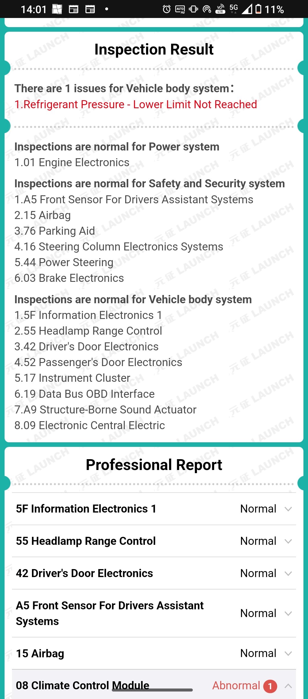

I have a launch x431 pro elite and that doesn't show any DTC other then low pressure , headlight range control and low voltage I think

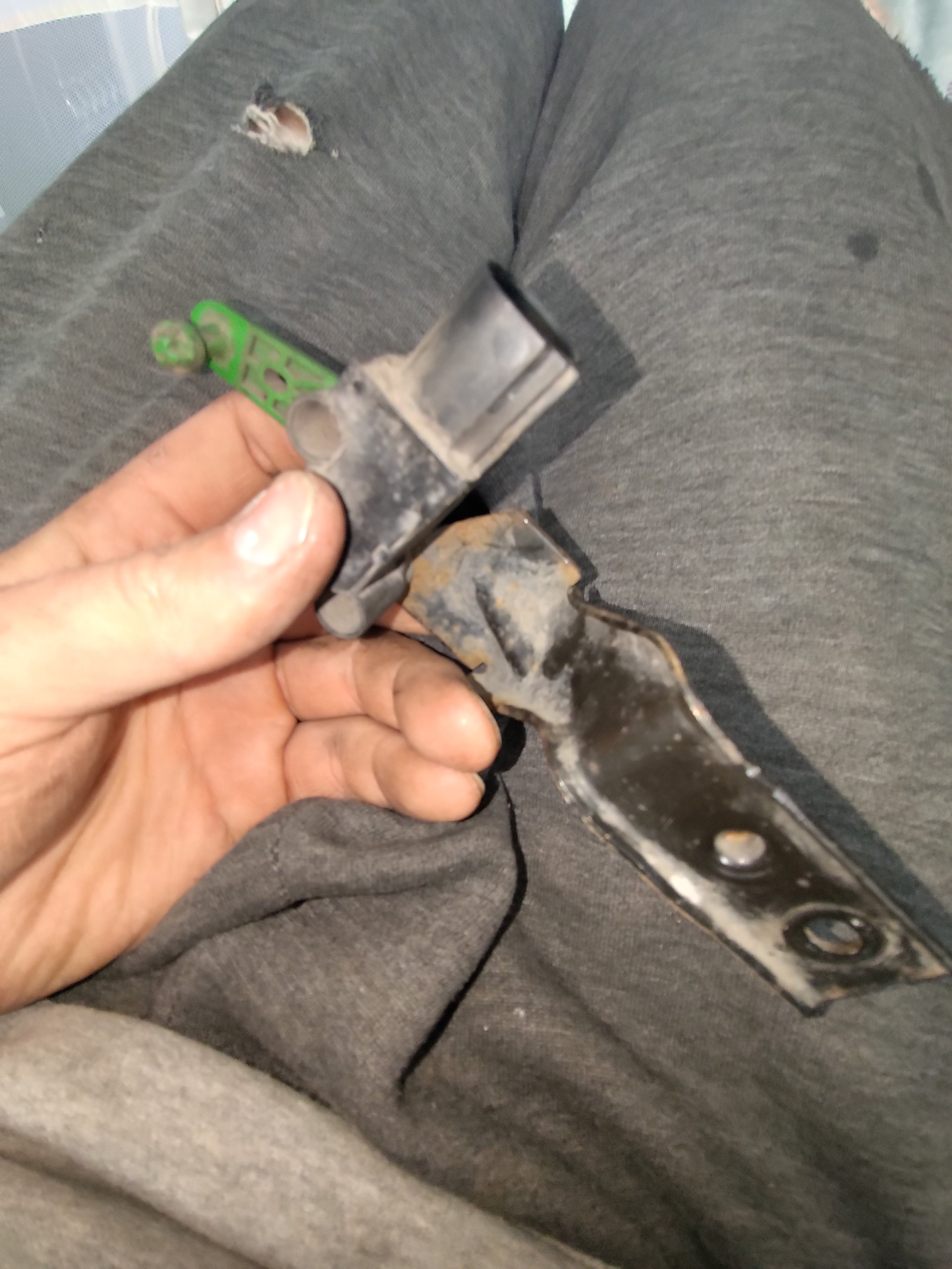

Hey update fixed my AFS bending light error and another code went to do with low voltage I'll show the part I change on my drive
This part front left sensors green arm was solid seized
