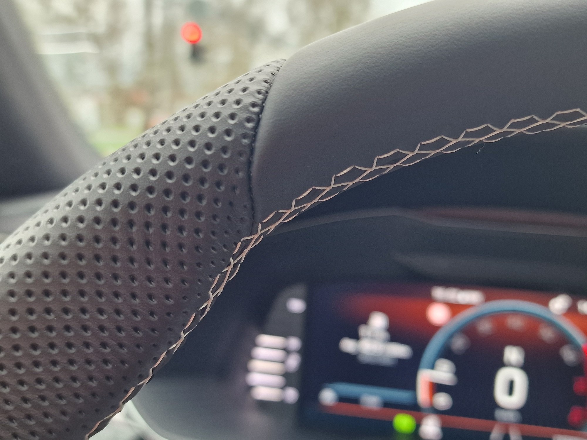

got new perforated leather on steering wheel
OEM had no wear sign after 14 months

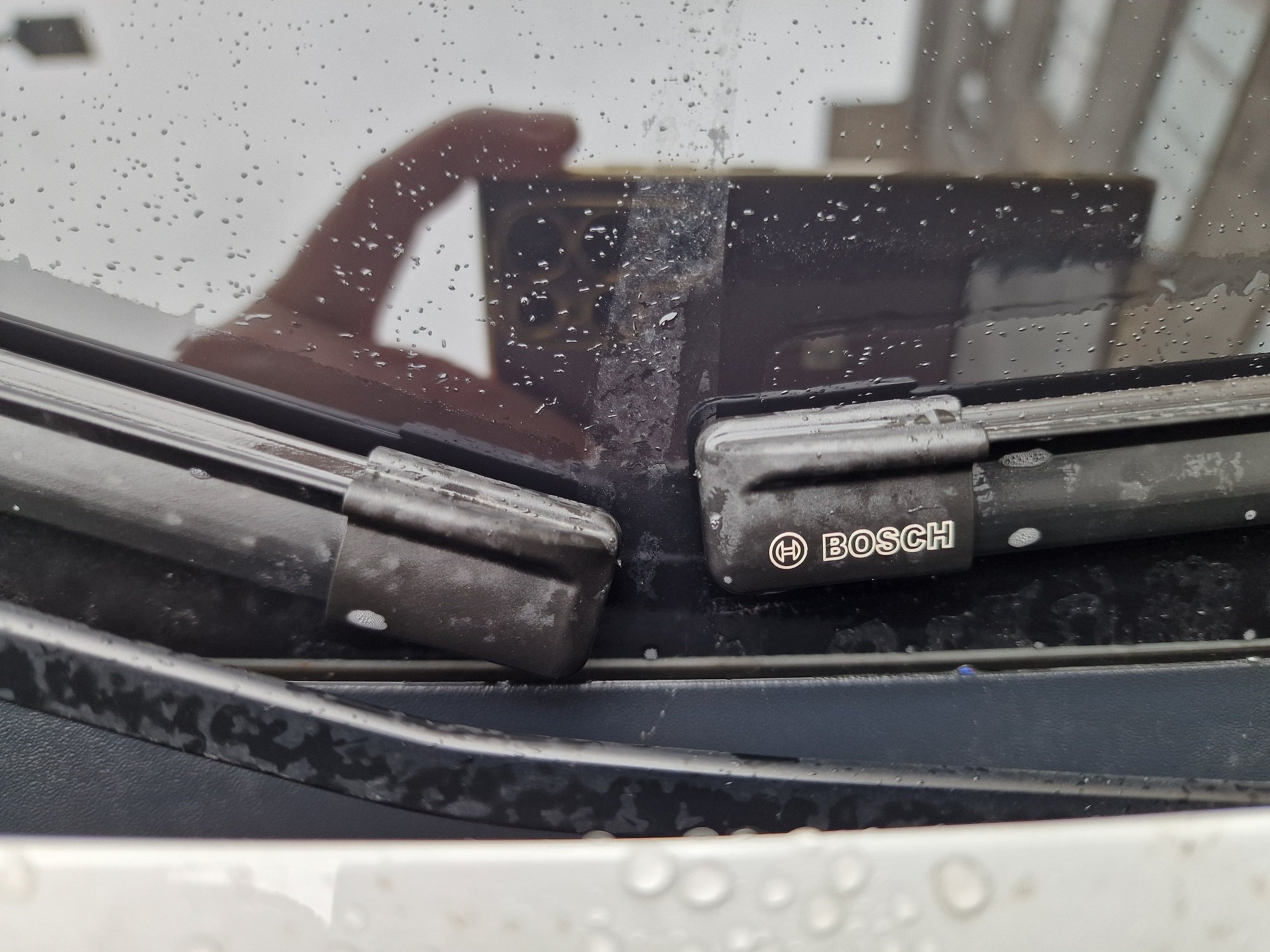

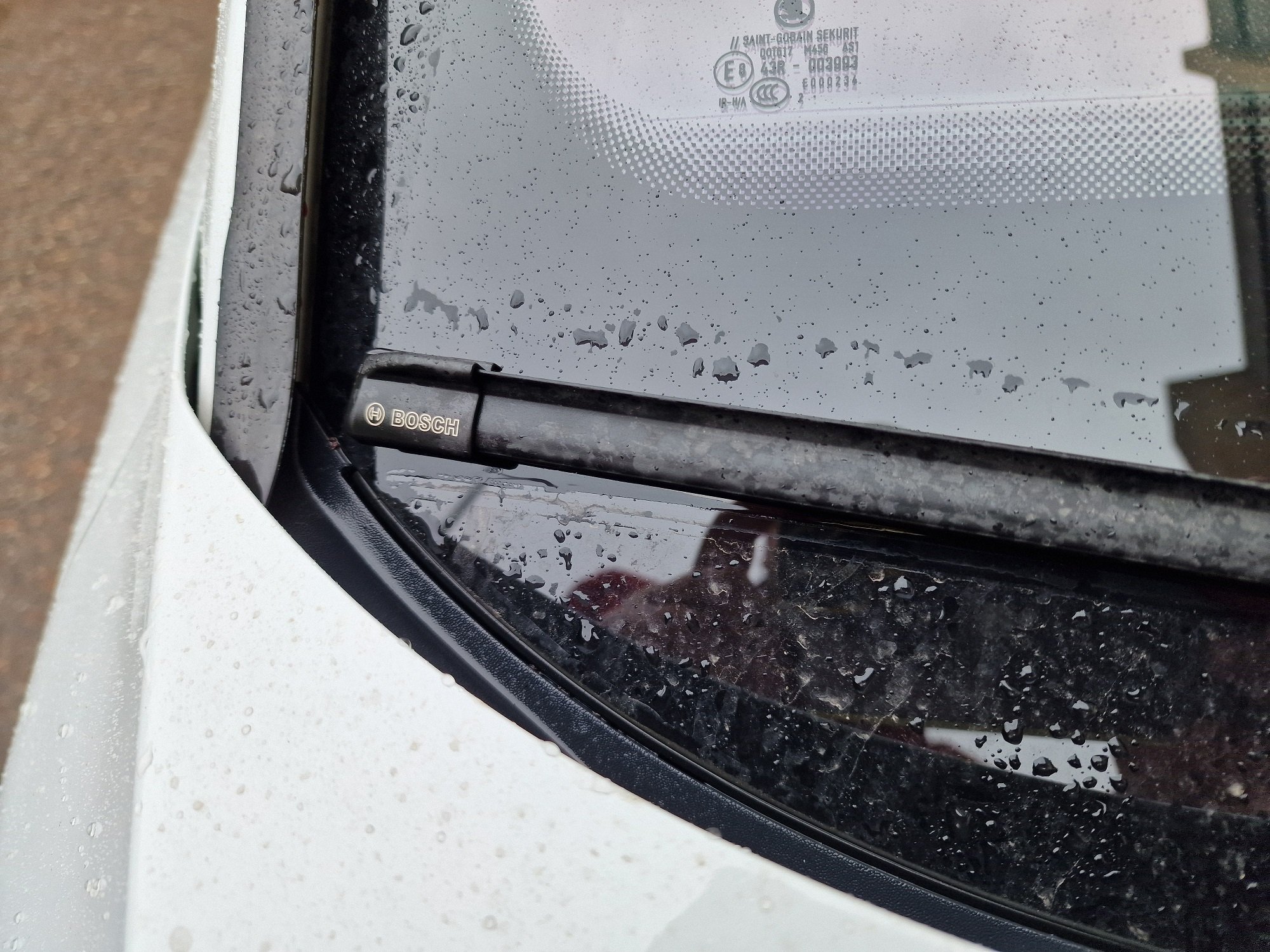

full size Wiper Blades (from Passat)
3-397-007-863    650; 450mm    Bosch AeroTwin A 863 S (Superb; Golf; . .)
3-397-014-116    650; 475mm    Bosch AeroTwin A 102 S (Passat; Arteon; . .)
!!! part codes are LHD, not UK; AU etc. !!!

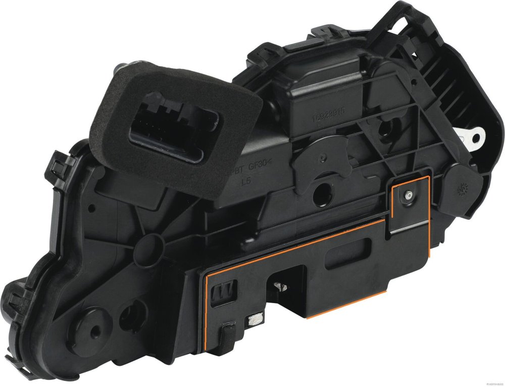

suction motors come in the kit.
by orange is marked part, which goes to replace in the OEM locking mechanisms

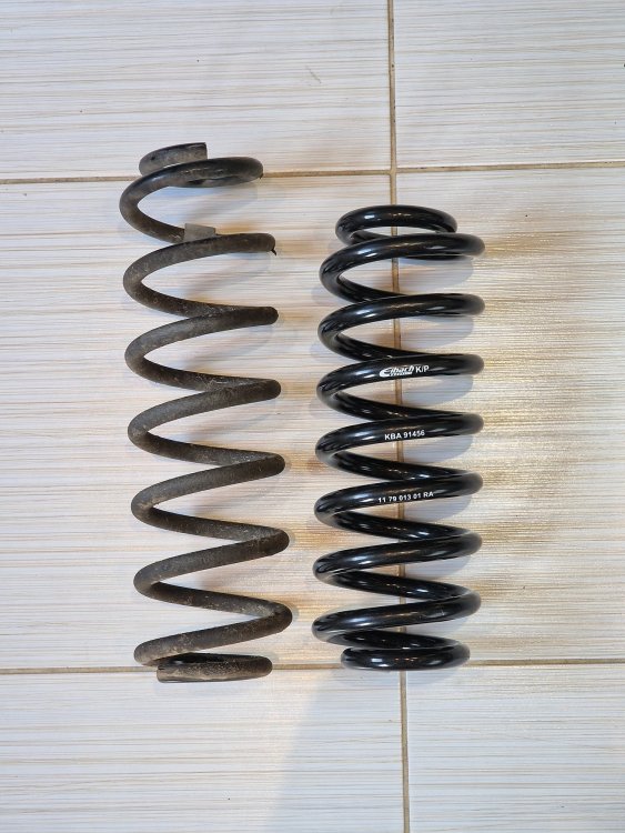

similarly as my previous 2016. Mk3 2.0 TSI 220ps FWD
-> https://www.briskoda.net/forums/topic/485647-bilstein-b6-dcc-shock-absorbers-available-at-last/?do=findComment&comment=5620484

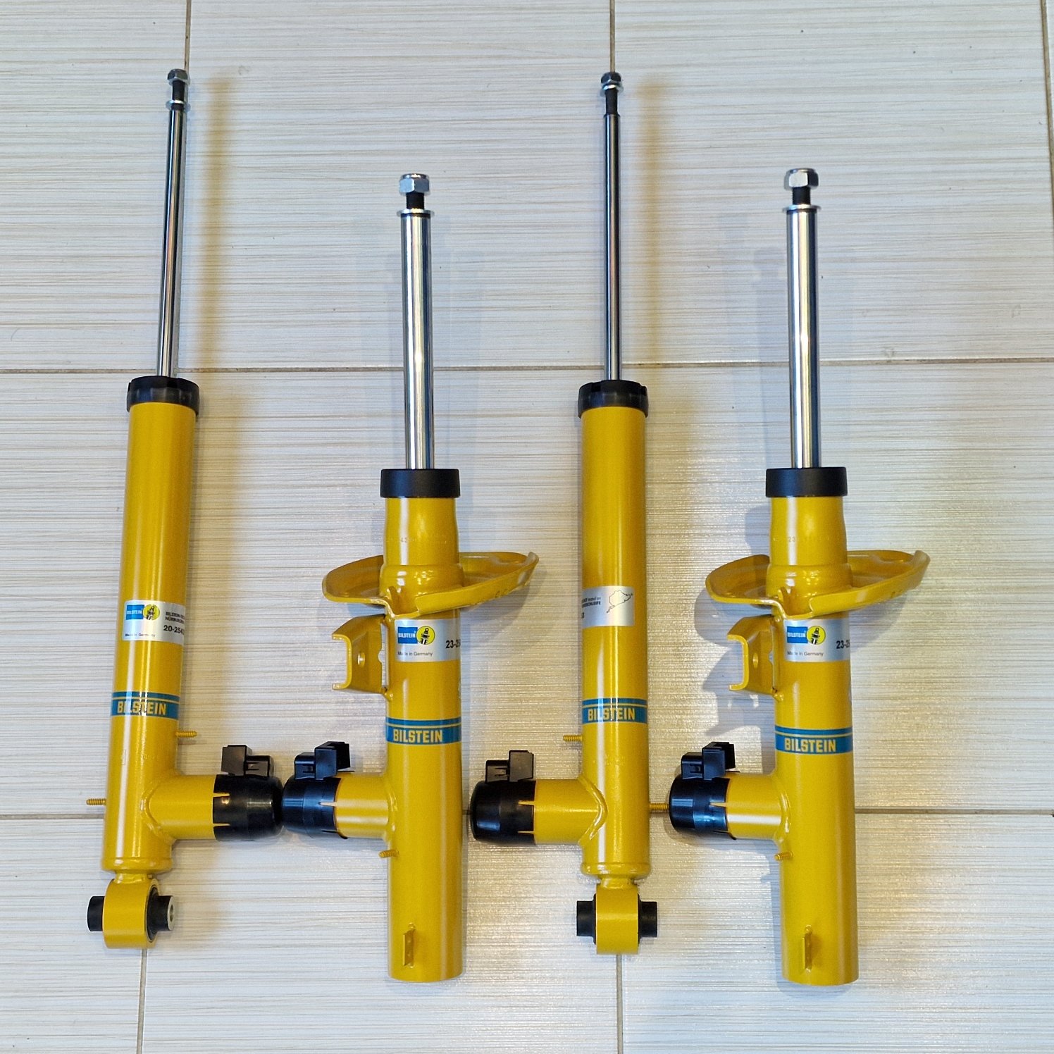

also current 2023. Mk3.FL 2.0 TSI 280ps AWD got this upgrade -
challenge, stiffness without lowering, succeed :)
front
Eibach F11-85-043-03-FA + Bilstein B6 DampTronic 23-254343
rear
Eibach F11-79-013-01-RA + WRONG Bilstein B6 DampTronic 20-254353 (correct part code would be 20-267537)
OEM DCC
front
3Q0 413 031 AK + 5Q0 411 105 GN
rear
3Q0 513 045 AD + 3Q0 511 115 AL
played lottery also on front axle because
a) rear axle had it in any case
b) four springs set, Eibach Pro-Kit from Kodiaq E10-79-013-03-22, priced €193 while four separate springs €265
c) front of 280ps, in theory, has extra weight from bigger turbine and DSG radiator
choice table (green 2.0 FWD / yellow 2.0 AWD)
ride conditions improved, waterbed is gone  -
new Comfort is somewhere between as were OEM Normal-Sport
new Normal is as OEM Sport
new Sport is as OEM Sport with a small plus
difference between modes decreased for about 50%
BUT, suspension got knocking sound after upgrade 😞
as first suspicions were wrong rear shock code -
i were too much focused on springs parameters as result i didn't double checked what b-šhit is declared on sellers webpage
such small mistake, minus €700+ (seller already rejected, crossing fingers on PayPal)
two weeks later knocking sound were solved by replace
rear struct Bilstein 12-281459 to used OEM 5Q0 513 353 E
looks like i will leave "wrong" rear shocks - they are ~20mm shorter than "correct" Bilsteins
but in compare to OEMs, they have same full length with extra 10mm in Biltein's cylinder length
list of parts to replace together with shocks and springs were made from my previous Mk3

!!! knocking sound
Bilstein 12-281459 x2    r. Top Strut Mounting (5Q0 513 353 E)

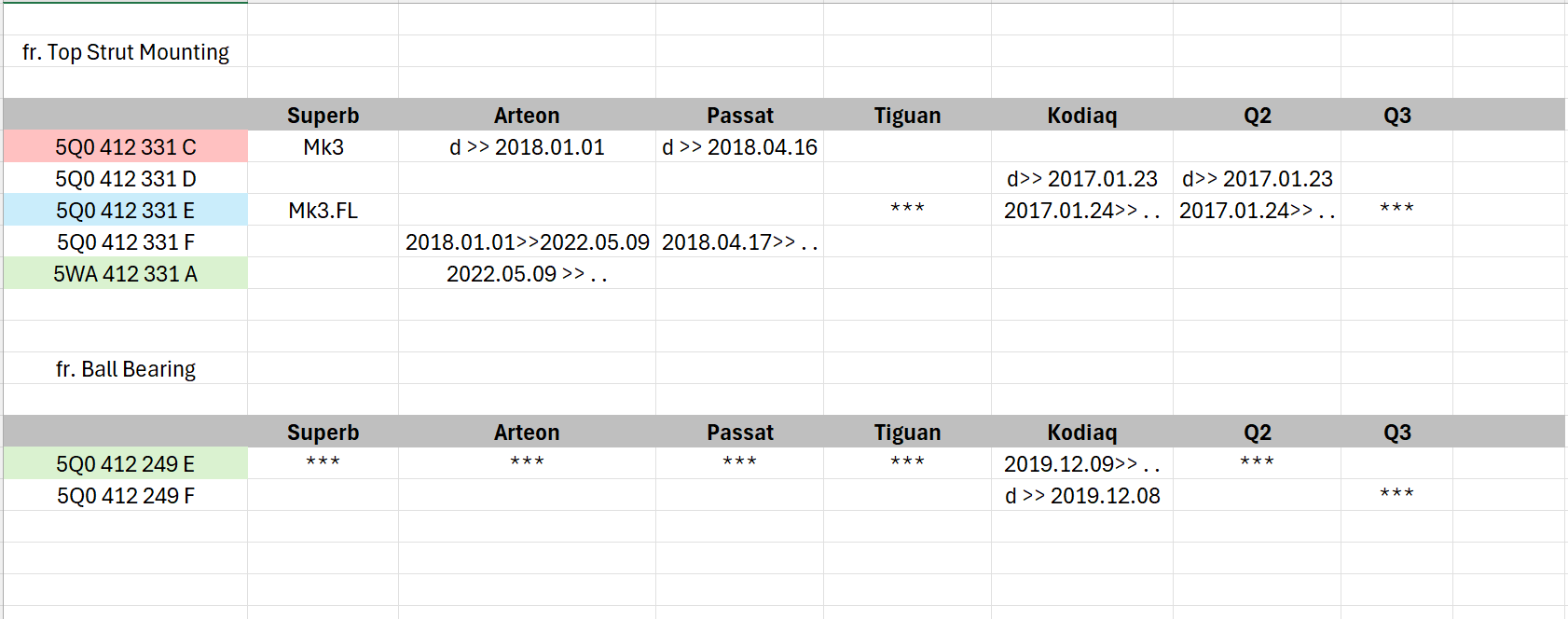

and another Top Strut Mounting
5Q0 412 331 C      x2              OEM 2016 Mk3 / Arteon
5Q0 412 331 E       x2             OEM 2023 Mk3.FL
wondering, maybe following can be in higher comfort level due VAG hierarchy
5Q0 412 331 F        x2            OEM Arteon
5WA 412 331 A       x2            OEM Arteon 2022.05.09

rear OEM vs Eibach Pro
+ additional improvement, rear springs top mounts 8J0 512 149

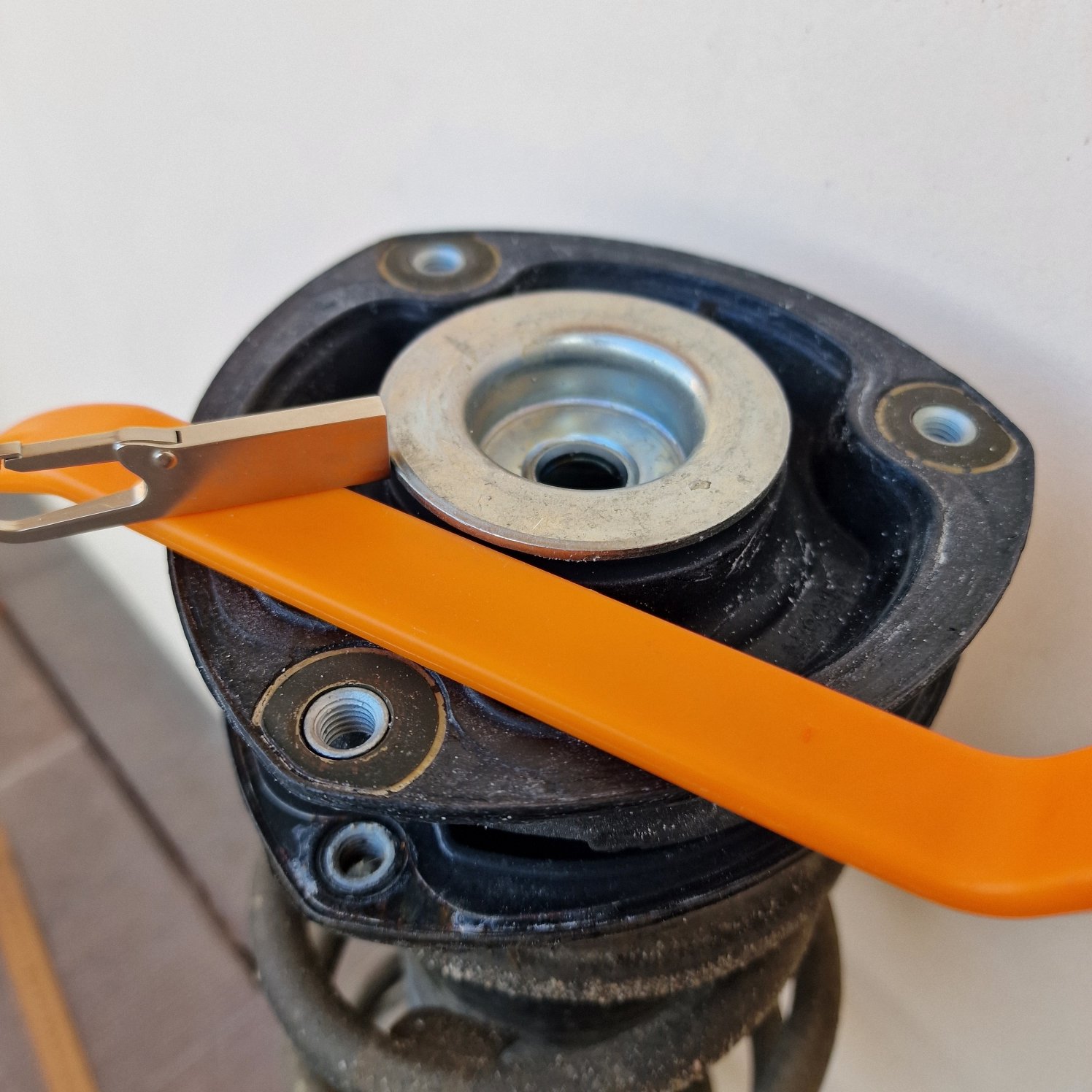

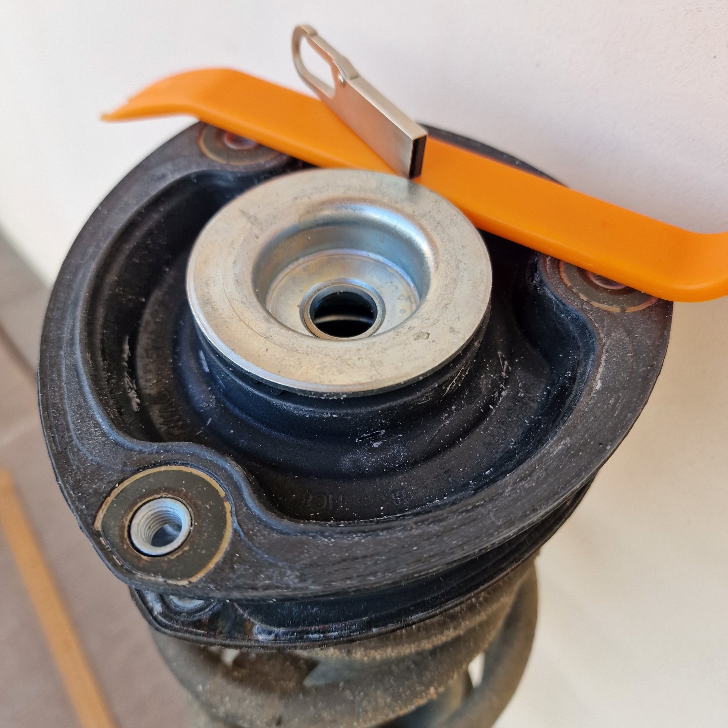

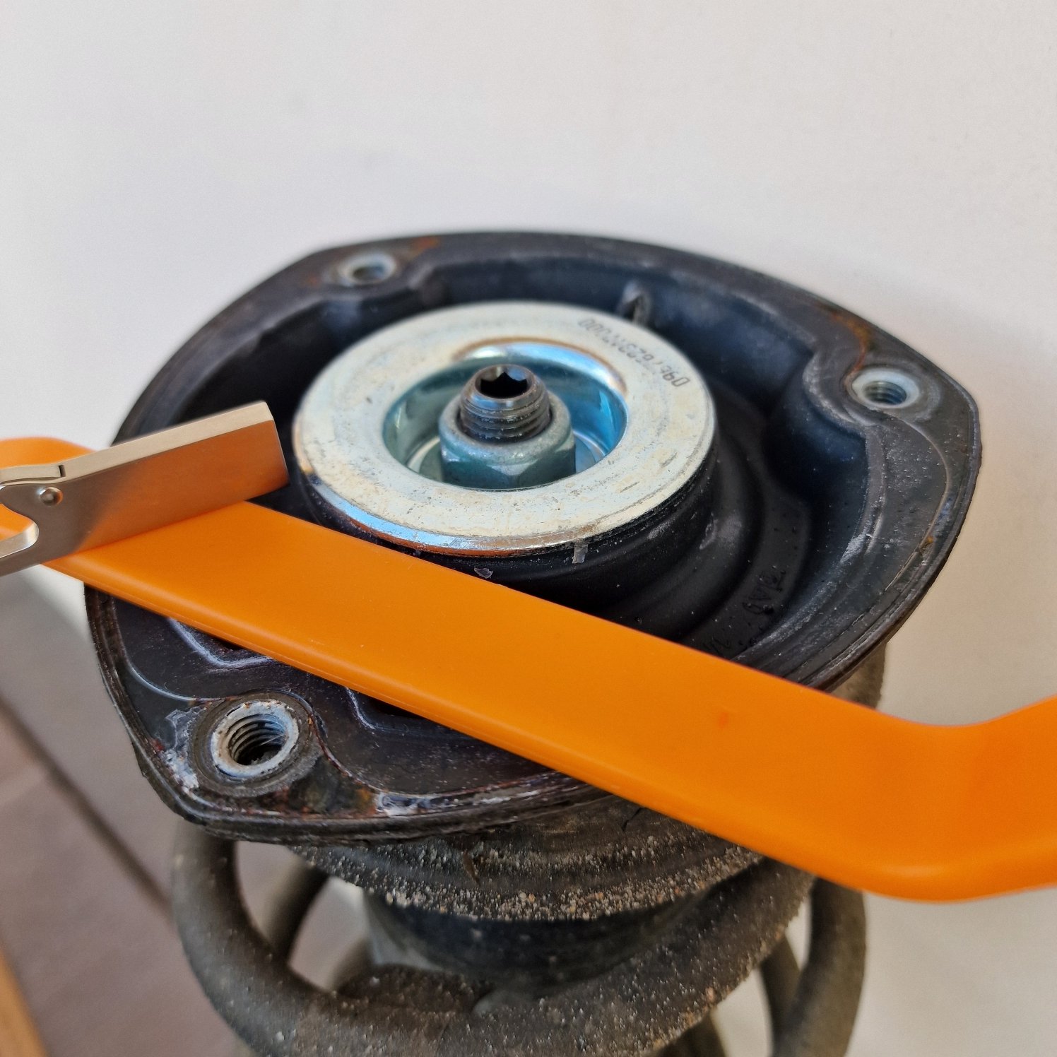

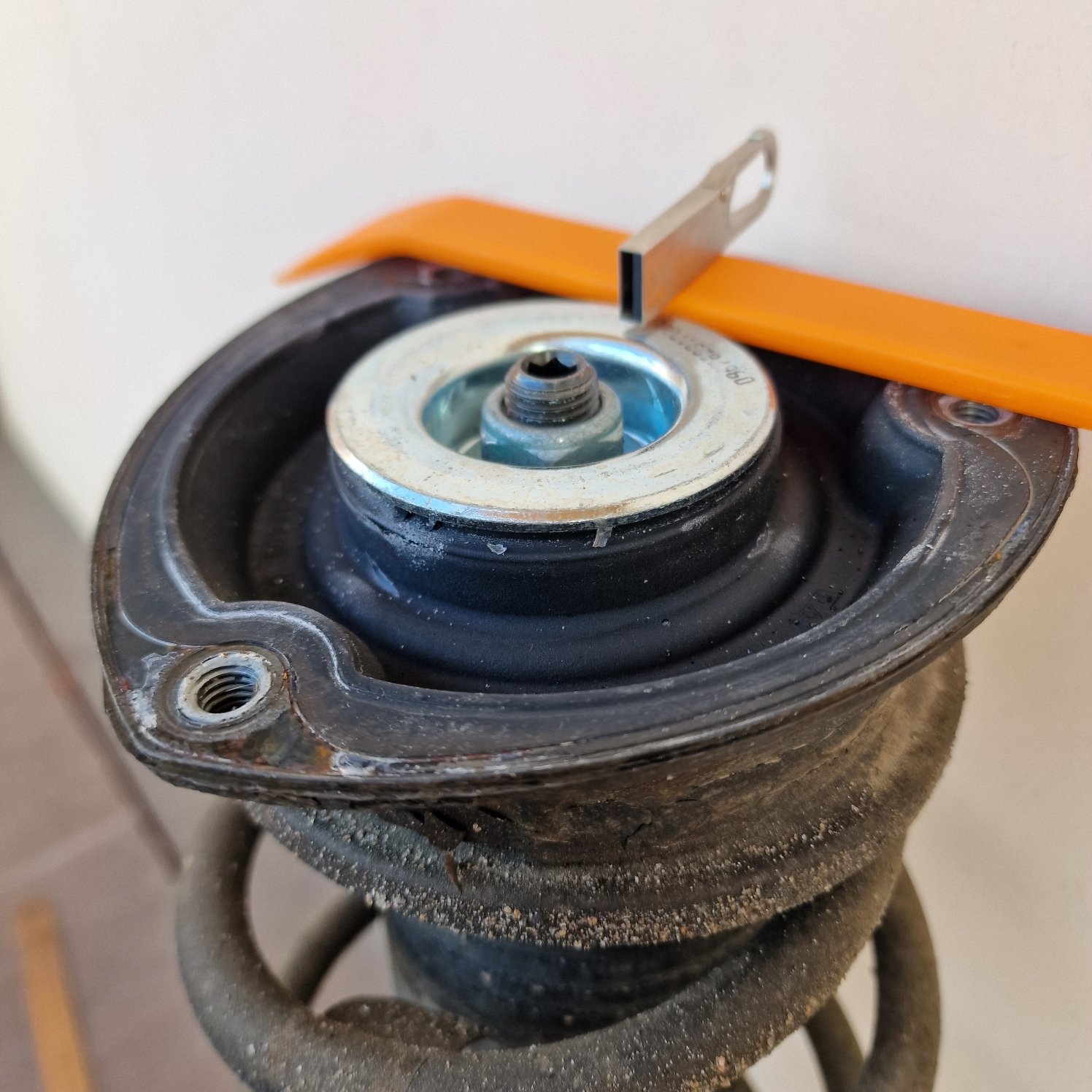

Arteon's OEM 5WA 412 331 A + Superb's OEM 5Q0 412 249 E have been installed!
i can't confirm improvement in compare to OEM 5Q0 412 331 E
because few months between installation and current Eibach Pro springs are about 15% stiffer than OEMs were,
but definitely, they are better than my wrongly made side step FEBI 40171 + FEBI 44799
Superb's OEM 5Q0 412 331 E
Arteon's OEM 5WA 412 331 A sits ~ 2mm deeper
Edited by MartiniB

I can report by installing top mounts 5WA 412 331 A (Arteon) has made a difference however I am on Bilstein coilovers aswell.
It's feel more comfortable/ road imperfections are a bit less intrusive and the steering weight is lighter in Normal mode.
