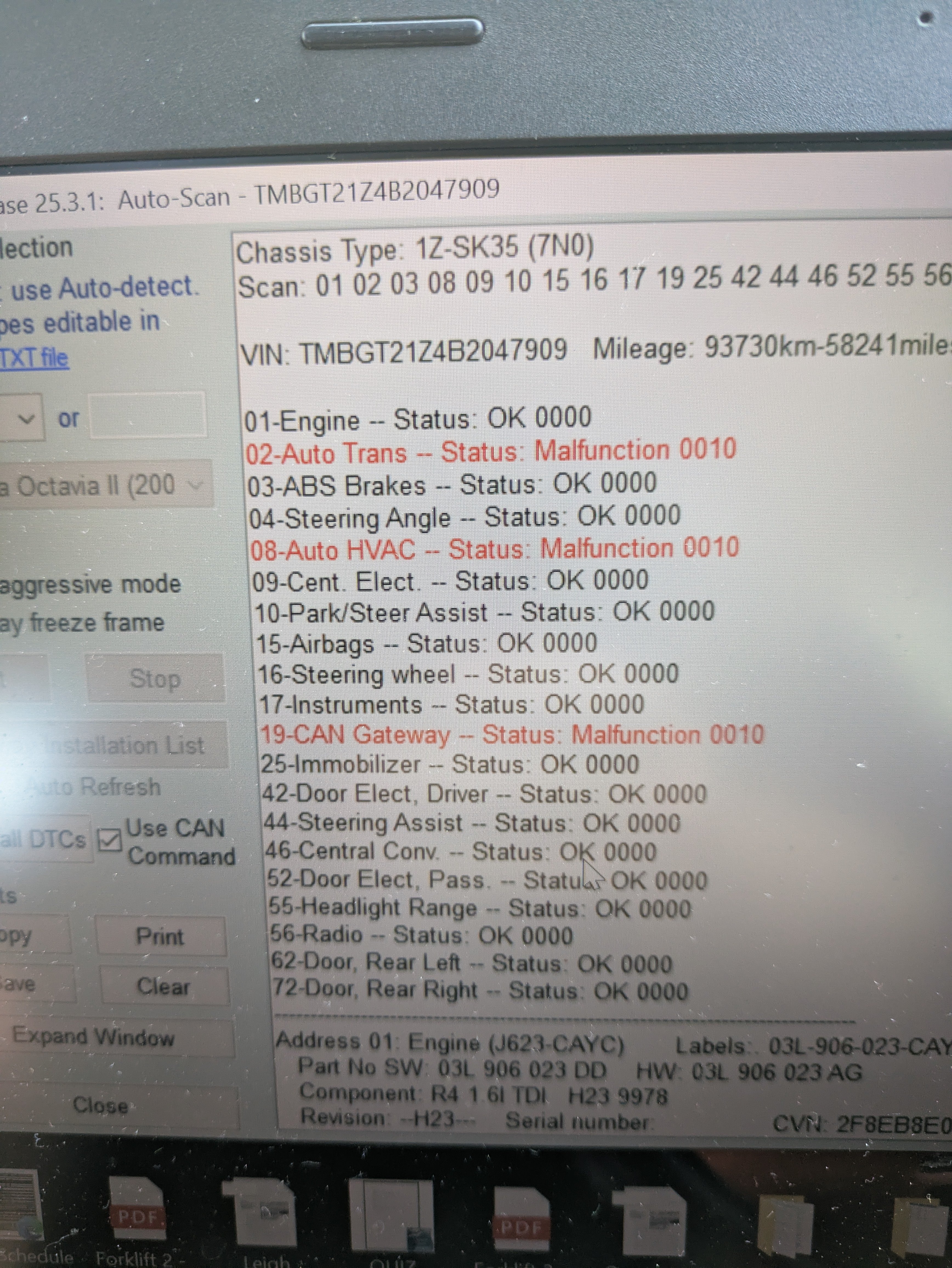

As a bit of background I had an injector go on my 1.6tdi Octavia 2 2010.
Was replaced but since then had engine knock that was getting worse.
Using a Ross-Tech scanner I just adapted the flow of all the injectors and seems to be running much better but still slightly rough.
I also did an autoscan and got the following codes....any ideas what each one could actually be? Or are they connected in some way?
I cleared the but both the auto trans and HVAC one came back.
The Aircon isn't actually working.....but I'm more concerned about the auto trans code.
Many thanks!
I am no expert but I think you will have to check the different sections. As far as I know 0010 is telling you that there is a fault and there will be fault codes stored under Auto trans section.

Many thanks Alasdair, appreciate your feedback ☺️
