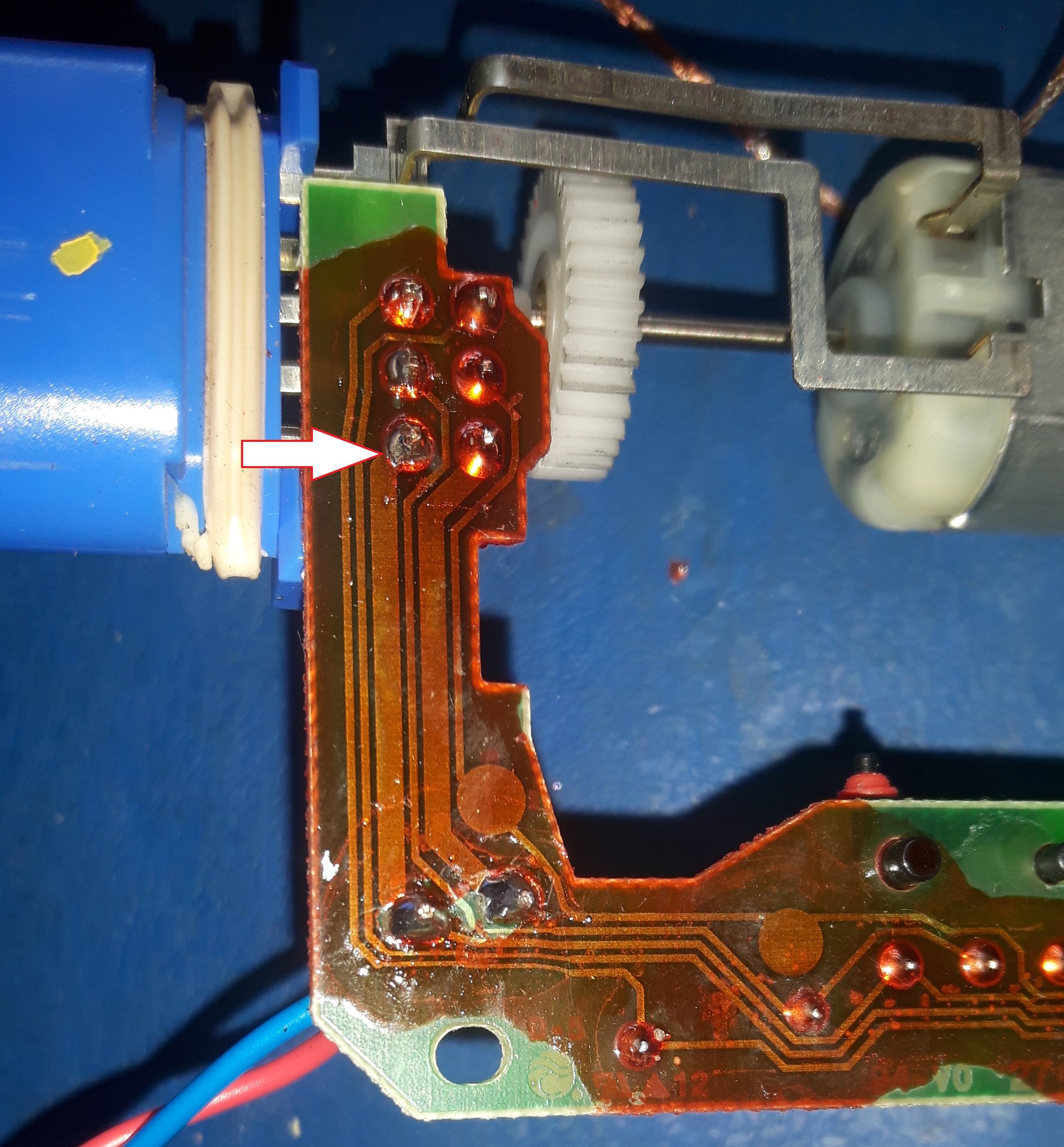

When ours was doing this a few years ago, it turned out to be a cracked solder joint on the circuit board within the passenger front lock module.
You can often work out which lock has the problem by unlocking with remote, then opening a door. The one with a bad connection probably won't be recognised as having opened, and car will self-lock again with door wide open.
Thanks for the reply. I will try to isolate the door. Kind regards.
