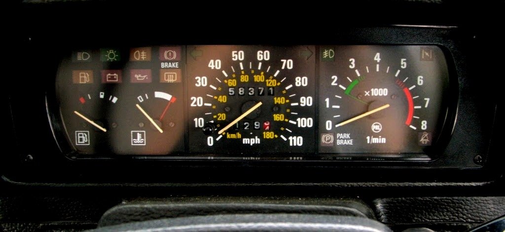

Just to let you know 2,000 rpm isn't high revs so you might be better driving in 4th gear at 50km/h and using a little less petrol, 3rd gear for approaching hazards of course.
I lifted the following dash photo off the net of a 1991 Skoda 135 Rapid Coupe (135 RiC(?)) the 136 engine may vary slightly but it gives an indication of revs suited to the engine, note the green and red sections. Not that I would go much near or above 5,000 very often, other posters will know better than I where the 136 engine performs at its optimum, and I am only suggesting occasional pushes of the engine and car.
Low revs can be good for fuel economy (after the engine has been fully warmed for a while) but good full economy also comes from some acceleration to nip through the gears to get into higher gears The engine, transmission and other components on the car benefit from being exercised to higher levels occasionally.
