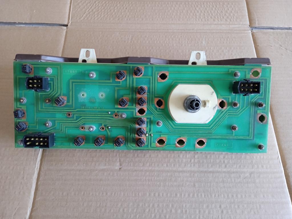

Hello everyone,
As of today the only thing I haven't changed is the connection to the board itself. I have checked all of the cables a couple of times and they are fine (not damaged anywhere). I have changed the HT leads, the ignition amplifier and the ignition coil. After all of those changes the tachometer is working a lot sharper (it was kinda sluggish before). But the problem still persists (but not in as it was before, the tachometer jumps here and there again but only when I let go of the throttle). I haven't had the chance to test it while driving the car yet. But yesterday before the changes I was driving the car and in the higher RPM's when the tachometer began going crazy, the engine started to behave like it was misfiring (there was a lot of push and pull in the higher RPMs and it also felt like something was blocking (restricting) the engine at the same time). I will test the car in motion today and leave the info later on.
Honestly, if it's not the connection to the board itself i don't know what else it could be?

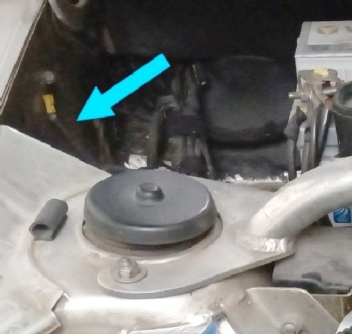

16 hours ago, Joja2k said:
the engine does not have an earth strap (or at least I'm dumb because i cannot find it)
A proper cable from negative pole to the car's body will do the job.
https://www.skoda-parts.com/data/items/278/5da96621b81ea_xl.jpg
