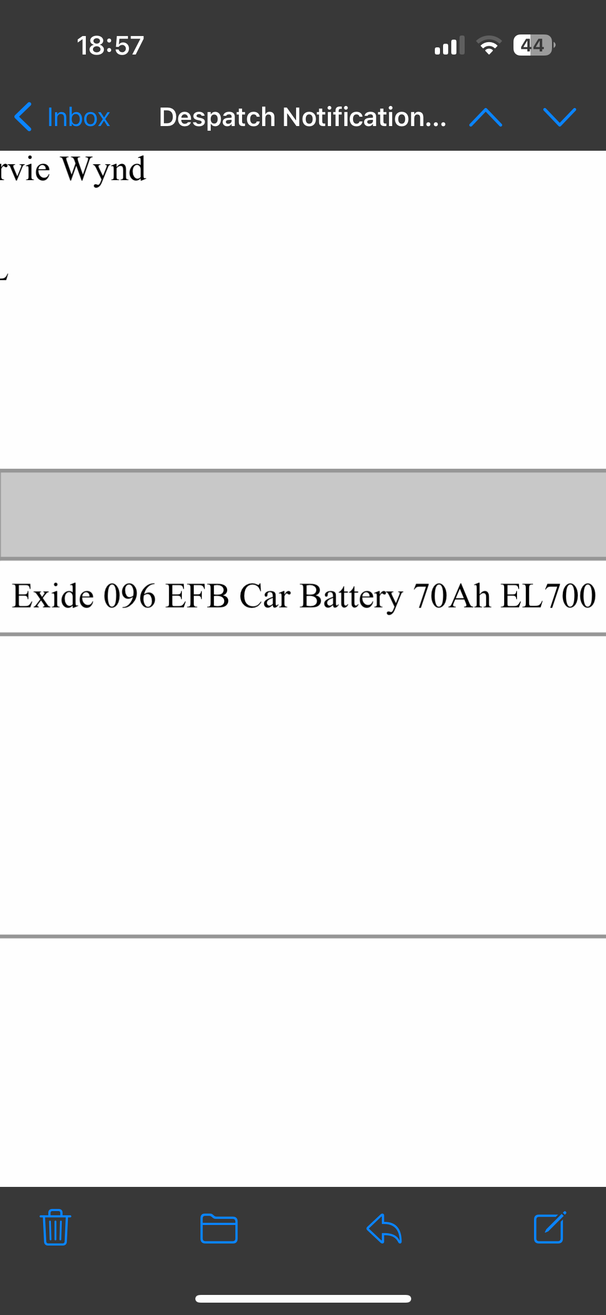

That’s the battery I ordered
Have you got an EFB type battery or an AGM type?
Thanks. AG Falco
I have a EFB fitted
