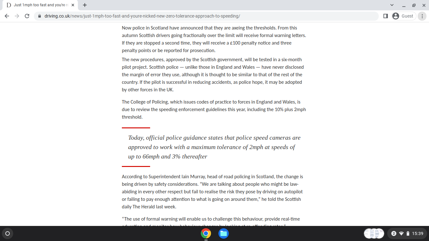

@Warrior193 Oop North in Scotland you will see plenty mile markers for Officers checking.
Oop North in Scotland there was a Pilot Scheme with ZERO over speed tolerances & and Education before financial penalties.
No taking an Education Course instead of prosecution in Scotland by a company run by an Ex Chief Constable or 3 making a nice little earner.
The Advice from the Chief Constables (England Wales) of the 10% plus 2 MPH is certainly not to be trusted in certain areas.
As to the 2 miles over, is that maybe about how accurate what ever system is operating.
I have had plenty bang to right caught speeding incidents, and i am always careful as far as camera vans go.
Average Speed camera routes i use regularly i watch what i am averaging at, and that can be slower than HGV,s from Ireland or Coaches.
There are several locations where i join after a camera or leave before the next camera.
I wonder sometimes about others that have passed the camera before me and go on past the next one at many MPH over the speed limit.
Maybe they think if they see someone that might be local ignoring the limit they can. Like ones that think the posties know.
10 years ago, how time flies.
As did Camera Safety Partnership vans between locations.
I reported one that tailgated me and when let past went over the Commercial Vehicle limit.
Turned out they have no Tacho. Police Inspector that replied who headed the Tayside Safety Partnership claimed it was Not in Service and a Technician was road testing it.
